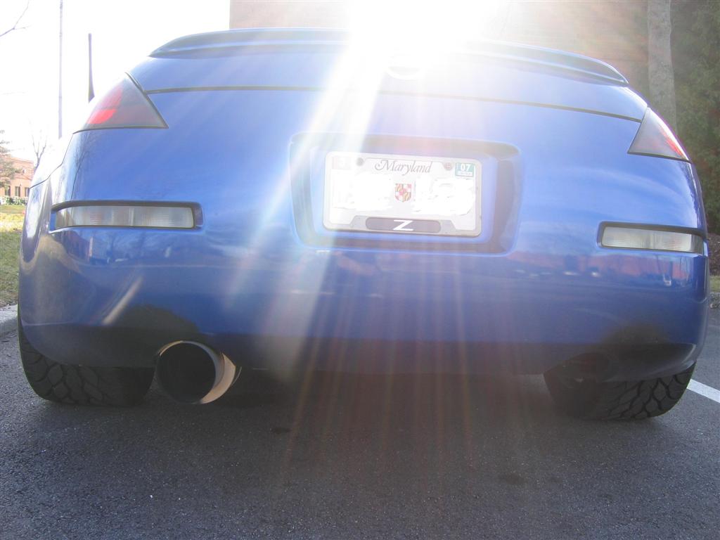

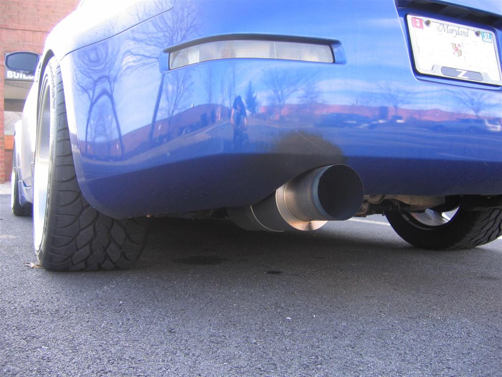

Here are 2 quick pics of the exhaust. Keep in mind the car is filthy and so is the Ti-sorry about the sun glare in the one pic, Ill take better clean ones later. BTW-that rear soot is from the old Injen exhaust not from the JIC....

Car looks amazing bro...what size tire is that? 285/??/19... I have 275/35/19s but would like to run a 285/35/19...I need to fix my rear camber for sure though. Its at -1.2 but it rubs a little. At -1.4 it deosn't. I think I'm going to run -1.5 in the rear...

Thanks man....they are 255/285/35 series KDWII's. I had to roll the fender with -1.6 degrees camber and this drop, but thats no big deal. The stance with these widths and offset, and the crazy tread pattern of the tires is very intimidating coming up from behind. Ill try and get better video this weekend-with my camcorder this time not just my digi pic camera.

Thanks for the pics of the exhaust. It looks good.
