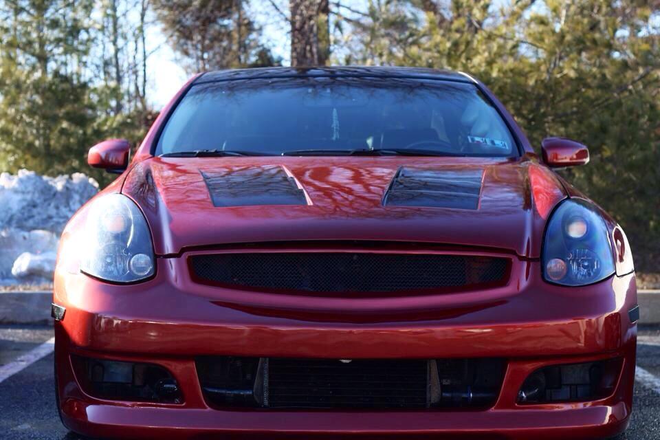

Wasup guys I drive an 06 g35 coupe 6mt.
I recently got a custom made rear mount turbo kit install similar to the sts rear mount kit.

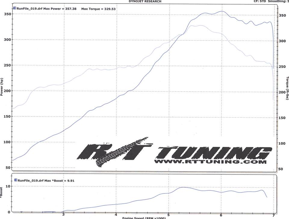

I made 360whp on 10psi of boost untill my stock maf sensor was maxed out.
Mods are:
Jnt Racing Test Pipes
Stock Y Pipe
Stock Midpipe
Resonator Cut Out
Gtr Injectors
I have a few questions hopefully I can get some answers. Im getting some strong fumes into the cabin to the point where it feels like im going to pass out have any of you experienced this ? I heard its from the crankcase hose but I put a filter on it but didnt help.
Im thinking its coming from the hose which is suppose to go on the intake but I may be wrong or could it be that my exhaust is like 8 inch shy from the back bumper ? (You can see how short it is from the pictures)
Also I need to quiet this dang down its too loud for me cant even push it on city street without being pulled over.

wow that is pretty low # for 10psi.. there were a couple of old timers here that did 10 psi and they are about 400whp. I also have a revup G35 like you, I dont exactly remember but i was at 375whp at around 7-8psi, at 360whp you should hit that at 7psi.. Also you are hitting full boost way late, I expect you to hit 10 psi around mid 4K. I hit 10psi at about 4100 rpm right now. I'm already complaining about my lag. Your car may not be as fun to drive if you hit full boost above 5K rpm and that power level. I bet you dont hit half your boost level even on second gear
Now on the fumes, i see you have a test pipes and a straight mid-pip, that adds to the problem!! I had a TP and everything else stock and i hated the rasp, the loudness and the fumes!! I mean i smell like gas every time i drive my car so I switched back to the stock CAT. Also make sure you dont have any exhaust leak.. Now i have a TP but i also have an XYZ pipe with HFC and that was the perfect combo IMO... not too loud and no more fumes!!
I noticed the pipe after the mid-pipe going to the hotside is different.. Is that the new piping STS sends or you had it modified? I like it but it look like the pipe diameter is larger which may add to the lag and delay boost.. Where can i get one?
Edit:
I missed the part of the custom Rear-Mount!!! epic fail...
please give more details on what piping size you are using for the cold side. also details on the turbo you are using. I think you are using a bigger diameter pipes and that is why you have a terrible boost curve..

My guess is an exhaust leak up front, and definitely the breather hose if it's vented up front. It's supposed to loop back to the intake, maybe run it all the way to the back and let it either vent back there or loop back into the turbo just before the filter so it won't see positive pressure.
