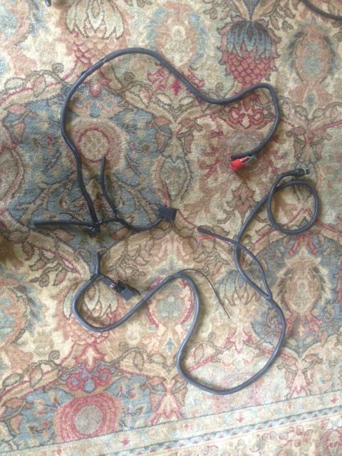

Does anyone happen to have a good picture of an uncut sts wire harness? Here is mine which the previous owner hacked up pretty good. Can anyone tell what I am missing? I'm pretty sure there's the toggle switch missing, but other than that?
