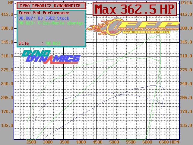

FFP , was the after ATI run with Borla "shorty headers AND catback"?
Anything other non-stock mods?
Was this before or after re-tuning the FMU?
An A/F curve would be really nice also .
Ambient temperature at air filter during runs?

FFP, sorry forgot something
What is causeing the post ATI curve to shut down earlier than the stock (NA) curve? Looks like given a few extra revs , it would still be rising.
362.5 at the rear wheels what do you think that is at the crank. That is MaxHax'z car? And with what other mods. I know this must be in the thread but it is a long thread sorry if the question is redundant.
