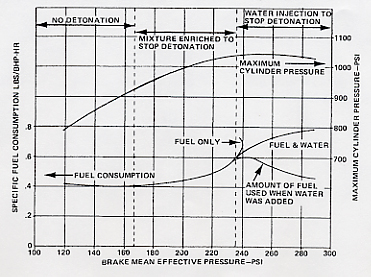

For a drag race, chilling the intercooler with N2O or CO2 would definitely do the trick.
For general running the car around maybe an external water spray would be your thing. I've been reading up on this stuff a lot lately and found a very promising Intelligent Intercooler Water Spray Controller Module that's not wasteful of water so it requires a smaller reservoir yet is effective. Here's a five page article detailing what led them up to creating this and how it'll help.
Water injection. That Aquamist system by ERL (Interex) looks to be the top notch system. The people at ERL have been very supportive of the community as well. Surbaru WRX owners have a great thread at NASIOC ongoing detailing their adventure in WI.
If that isn't enough information overload you could check out this link as well which has an interesting graph (attached or link if attach fails) which illustrates that at the higher boost levels less fuel is actually needed because it no longer has to be dumped into the cylinder for the purpose of cooling (which the water injection is now doing) and just produce power.
Attached Thumbnails ATI Pro Charger News and Updates (to be ongoing)-water-injection-cylinder-pressure-from-carrolsupercharging.jpg

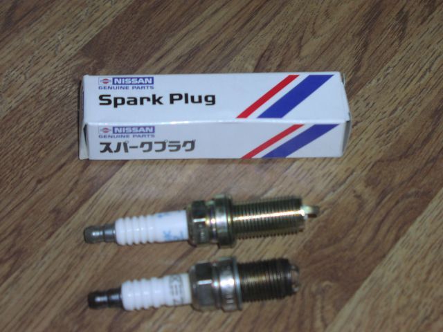

I will be running a 40- 50 "ish" (inside joke) shot for 'intercooling' but I have two jets, one for N20 one for fuel. N20 w/o fuel creates heat, heat melts plugs you are preaching to the choir hehe!
I still need a good lower temp thermostat and tranny cooler for anyone following this that is a vendor and isn't charging NISMO prices of $1200.00 for a 75 dollar cooler!
as to N20 w/ the wrong amount of fuel causing damage and preaching to the choir tell ZEX that ; they have a new page strongly advertising their crap plugs , they don't return emails and I am switching to NOS!
My car Dyno's tomorow barring immenant or unavoidable disaster (bows head in prayer)
P.S. on that D Blue SC install photo with the light removed, do you race with your light out? Where did you get your SC and what numbers track/Dyno did you get? Maybe I missed it because I was following the install of a redline car and just caught this blue one. Oh yea, mines an Auto no clutch worries!
Weight;
It comes shipped at 90lbs so knock off est 10lbs from that?
Attached Thumbnails ATI Pro Charger News and Updates (to be ongoing)-plugs640.jpg

Bait =fish thnax fro posting all the WI info.
I have been a proponent of WI for many years both on NA and FI apps.
The only main issue I have with Aquamist (ERL) is that the pump is really not up to the task of higher displacement apps. Some have ned to resort to accumulators to provide the initital surge.
Their pump was was too small for a 4.7L SC app of mine. I opted for a 100PSI pump similar to that shown in the "gaseous intercooling link". I obtained this fron Kennedy's dynotune in NY.
At 3.5L and >10psi , I'm not sure if the ERL pump will have enough capacity , but I will probe around.

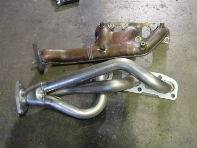

Attached Thumbnails ATI Pro Charger News and Updates (to be ongoing)-dsc00079.jpg
Old Jul 28, 2003 | 09:37 PM
  #239
FFP's Avatar
FFP
Posts: 18
From: none
Default just more stuff
stock vs aftermarket
Attached Thumbnails ATI Pro Charger News and Updates (to be ongoing)-dsc00073.jpg

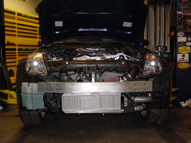

Old Jul 28, 2003 | 09:38 PM
  #240
FFP's Avatar
FFP
Posts: 18
From: none
Default and last but not least
True duel.
If all goes as it should i will posting up some numbers by mid afternoon
P.S i will Post some pics of it on the dyno tommorow.
Bill
www.Forcefedperformance.com
Get it done right the first time...
Get it Force Fed.
Attached Thumbnails ATI Pro Charger News and Updates (to be ongoing)-dsc00077.jpg
