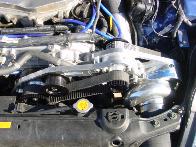

Default Update on the install
Just a few updated pics of the install of MaxHax's Z
Thanks
Bill
www.forcefedperformance.com
Attached Thumbnails ATI Pro Charger News and Updates (to be ongoing)-dsc00069.jpg

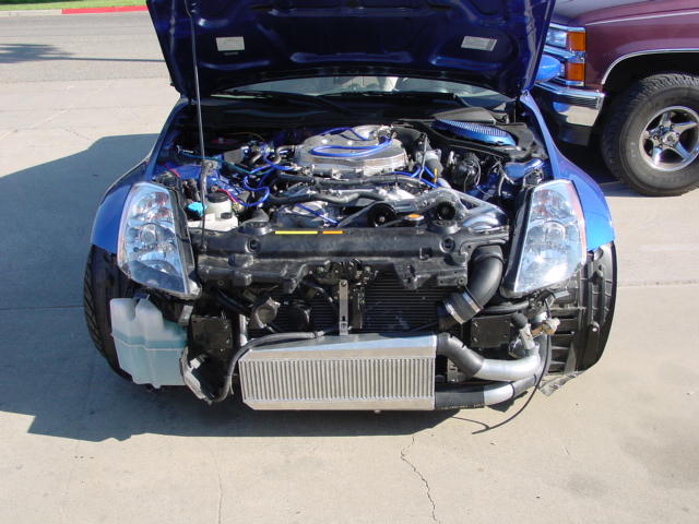

Old Jul 25, 2003 | 04:48 PM
  #168
FFP's Avatar
FFP
Posts: 18
From: none
more
Attached Thumbnails ATI Pro Charger News and Updates (to be ongoing)-dsc00070.jpg

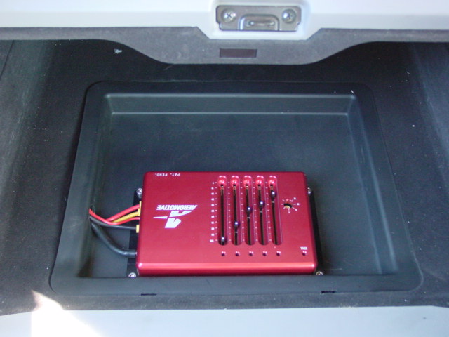

Old Jul 25, 2003 | 04:49 PM
  #169
FFP's Avatar
FFP
Posts: 18
From: none
last one
Attached Thumbnails ATI Pro Charger News and Updates (to be ongoing)-dsc00071.jpg

Originally posted by Xeinth
Sorry if I missed this, but do you have to lose the strut bar with the Procharger? I realize the crawford plenum requires it to be removed, but not sure about the SC
X
Nope. Check out the recent pics of Max's car. You can see that the SC itself nor the piping to the TB interfere with the STB.

Ahhh Haaaahhh, it's an Aeromotive FMU, that is an excellent setup. I'm even more excited now. That is going to be soooo easy to adjust with a wideband O2 sensor
http://216.242.145.16/products/product.phtml?p=32
