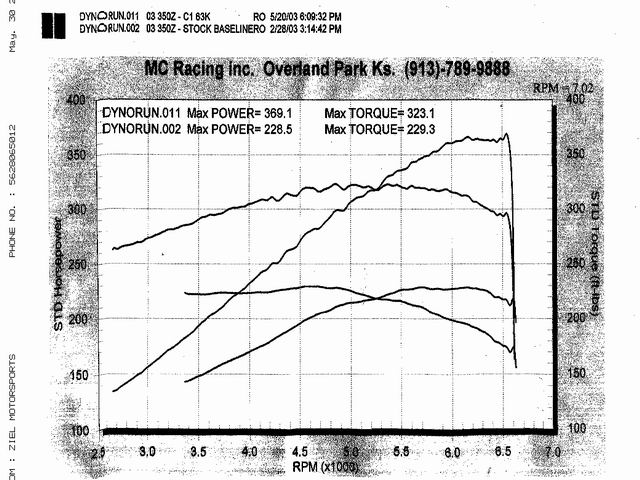

this dyno chart was suppose to be from ATI procharger, but haven't seen this on any of the procharger thread. Is this dyno accurate? If so, this is exciting. Makes you wonder why this SC is better than others plus turbos

That dyno plot was posted once before, but good to see it again. We can compare it to this latest install.
The thing i didnt like was the IC not being centered. I had this fear while I saw it even w/o the bumper installed, but now you can see it's off-center a bit too much. Oh well.

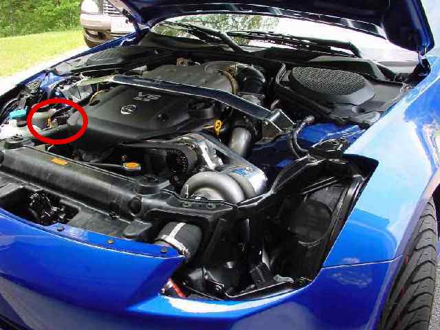

Originally posted by G3po
So the ATI setup "doesn't" come with a "booster" pump?
Actually it does. I dont have a clear picture of it but you can just see the corner of it in the red circle in this photo of my install - it has two leads attached to it's end. It has the capacity to take fuel pressure up to 100 psi and is controlled by the voltage from the FMU. You can just barely see the end of it here ...

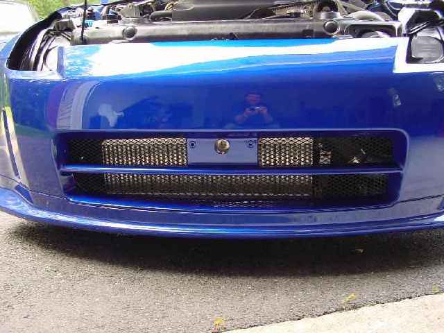

Sanderman ,Thanx , for the pic. Got another straight on from the front. Interested on how much IC , plumbing and Filter appear from front.
I must admit , seeing the fuel boot bump mounted so high in the chassis , kind of concerned me (possible higher propensity to vapor lock and/or not prime immediately).
But I guess since the factory in-tank pump keeps the inlet of the in-line booster "under positive pressure" as soon as the key is turned on , it is probably OK.
I'm just a little suprised that ATI would pick such a "high" mount point, I would have expected near or below low fuel tank level.
Pretty much all of the IC is visble. The air filter is above it and can't really be seen at all. You can also see the ends of the IC inlet and outlet hoses (thought they are black) and their fittings...
joe

Sanderman , wowo your quick , Thanx again.
I wonder is a silver (rather than black) mesh might visually masks it a bit.
I prefer to be a stealthy as possible , even though the whine will
still draw attention.
I guess If someone asks about the whine a response can always be "yeh I've gotta get this stinkin' power steering pump replaced .
I've used that line before on my FI pickup.

That 369 is real; I recall (and Spencer can chime in) that 369 is what Mike hit at AA after tuning. IIRC he gained 10RWHP from tuning!
