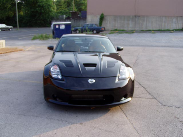

Ok, here is my ATI info.
Stock was 221.5 RWHP, ATI after dyno tuning (18 runs !) 349.6 RWHP. This is a 63% gain folks ! Stock exhaust, no plenum yet, no headers - bone stock except the supercharger. Tomorrow a CO2 intercooler chiller is being installed, then I will dyno again. Then I will get the Crawford plenum and dyno again. That will probably be within the next couple of weeks.
Guage info: I ordered an A-Pillar cover from Nissan, and I will be getting some 3 age pod a-pillar mold made for some other car and cutting and fitting it into the 350Z A-pillar, then using fiberglass and other materials a friend of mine will make it look completely factory. I will probably get an A/F guage, a fuel pressure guage, and a boost guage to put in them.

Give us some driving impressions. How do you like it, etc... Looks really good!

Where did you get that hood, how much, fiber or metal and is it functional? I mean does it let air into the engine bay? I like it. Link? Welcome to the ATI SC Club!
What was the maximum boost you achived bro? That is what I want to know. Whether the larger plenum and open exhaust lower boost pressure (thus allowing more boost later.)

Very nice, Paolo. Those are good numbers for a 100% stock setup. Keep us posted on the CO2 install. Also, I'd love to see more pics if you have them!

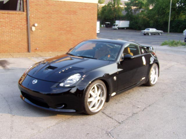

My A/F ratio was between 12.8 and 13.2. Max boost achieved was right at 7.0 psi. I guess the plenum and exhaust must decrease the boost some, which is a good thing since the power is still increased. Phase 2 for me now will be to add the Crawford plenum, Borla exhaust, and Headers. After that I will go to the 9 lb pulley. I imagine that should put me at around 400 RWHP. Phase 3 will be more long term, in which even more boost will be added, different injectors, rods, pistons, etc..
Max, the hood is Veilside Version 3, it is fiberglass, and I do believe the engine stays somewhat cooler from what I can tell from it. The link for it is here
http://www.i-m-racing.com/aeex.html
