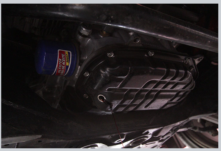

I'm attempting to make an STS rear mount turbo kit for a de car fit my 07 HR and will have a few questions in the upcoming weeks. Not sure if they should go here or in the vq35hr thread but nonetheless I need to know whether the HR oil pressure sensor is the same thread/size/location as in this pic of sts' picture of the de model. My kit did not come with that brass fitting for the turbo oil supply line, and I'm wondering if I need to order it if it will fit an HR or just use a sandwich plate for the supply lines.
but by looking at this pic of an HR I found, it doesn't look the same, so it may not work anyway?
