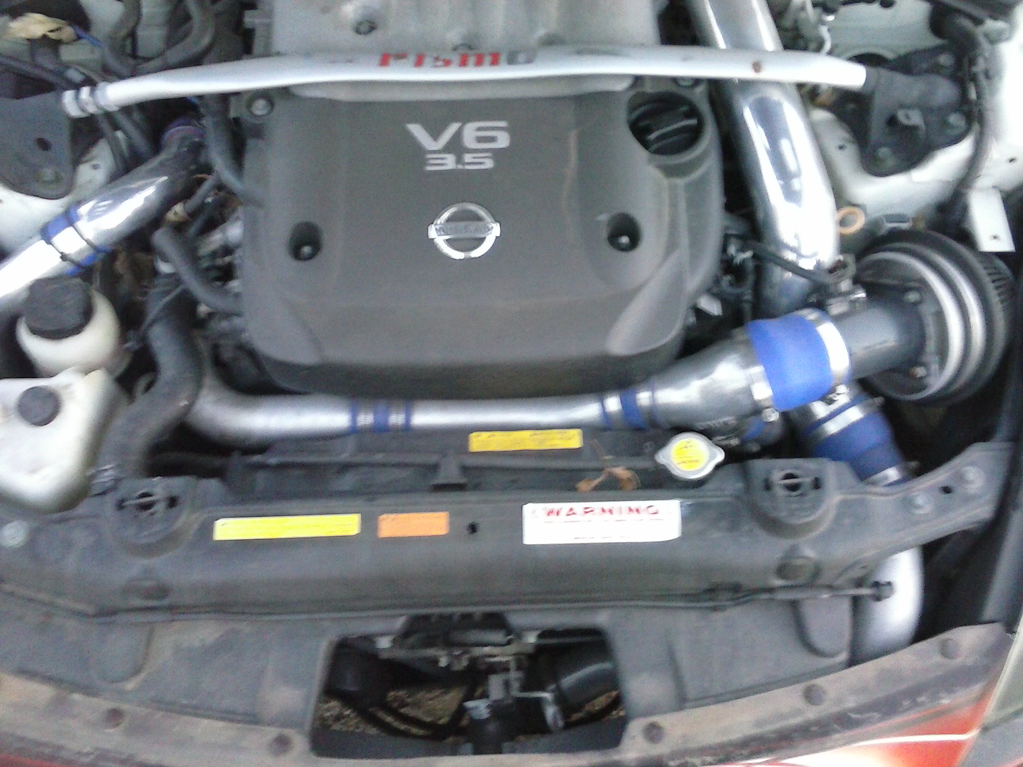

Old Mar 17, 2014 | 06:37 PM
  #414
Mikeymike304's Avatar
Mikeymike304
Joined: Sep 2012
Posts: 17
From: Oklahoma
Default what do I need for 500whp
Hey guys. I am currently running a jwt twin turbo kit at 5lbs and making 345whp and 324wtq. I want to push it into the 500whp range and not sure what really needs to be done to make sure it stays reliable. I have a friend who has a supercharger on his and he is making almost 600whp with a fully stock block. I hear most the problems come around 400-450whp. Do we need just rods and pistons? Is there a breakdown of what goes at what hp levels.? Any help would be awesome.
Old Mar 17, 2014 | 06:43 PM
  #415
taywan's Avatar
taywan
iTrader: (53)
Joined: Mar 2011
Posts: 4,734
From: G'ville SC
You have some homework to do...
Old Mar 17, 2014 | 06:44 PM
  #416
MI 35th's Avatar
MI 35th
OGPremierMafia
Joined: Feb 2005
Posts: 5,106
From: Cincinnati OH
Thanks Taywan!
Old Mar 17, 2014 | 06:49 PM
  #417
verdict.'s Avatar
verdict.
Super Moderator
Joined: Apr 2010
Posts: 13,161
Likes: 648
From: TX
Thread moved to Forced Induction...
Old Mar 17, 2014 | 06:54 PM
  #418
jhc's Avatar
jhc
General & Tech Moderator
Joined: Jan 2013
Posts: 10,400
Likes: 2,226
From: ZdayZ
Pics of engine bay and exterior are helpful. Mileage, AT/MT, other mods already on the car? Exhaust, FD. Tune, cams? What bolt-ons are you running?
Old Mar 17, 2014 | 07:04 PM
  #419
Mikeymike304
Joined: Sep 2012
Posts: 17
From: Oklahoma
Ok these are the only pics I have at the moment. I can take more tomorrow. All I have right now is nismo exhaust and the JWT 530. AT tranny tune buy vinny ten. Have a new radiator but not on the car yet. Stock cams. about 58k miles the turbo system was put on at about 35k.
Attached Thumbnails Forced Induction for Noobs....-cam00030.jpg   Forced Induction for Noobs....-cam00029.jpg   Forced Induction for Noobs....-cam00028.jpg
Old Mar 17, 2014 | 07:11 PM
  #420
midz350's Avatar
midz350
Posts: 4,054
Likes: 24
From: around.
You should talk to vinny ten. He will take care of you.
