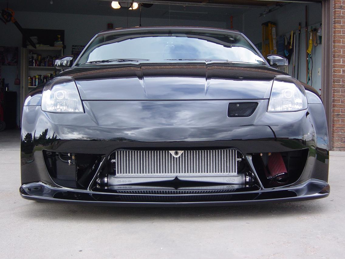

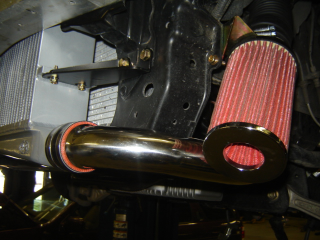

Since my car has a new body kit, my drivers side filter is open to the air. Which is good and bad. At the last local meet, one of the members suggested i get a pre filter that also repels water ( on certain times i have to drive home on a damp night, I would never drive in the rain.)
http://www.injen.com/docs/products/listing.asp?pcc=rp
I have a couple questions
1. What size are the APS TT air filters?
2. Has any one used a pre filter before?
3. From the Injen Link provided above, what size would i need?
4. Is there any other suggestions?
A picture for reference is added.

the prefilter is just some sort of nylon sock that covers the intake. IMHO you are no safer with or without.
If you have concerns, get some mesh to fill the hole so the bigger debris doesn't hit the filter
