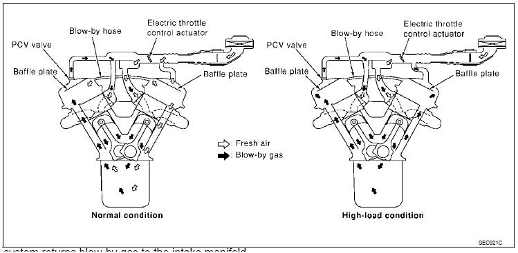

Originally Posted by bikinilust
Also. can someone clear this up for me?
ok. driver's side pcv is for venting, or for sucking in air?
Same with the passanger side. Is it for venting and/or taking in air.
Does the passanger side need to be connected to the plenum? Cant it just be connected to a catch can with a breather on it? Or does it need that vaccuum to release the pressure?
Thanks
Well, are you boosted? If you're not boosted, then just keep everything stock. Here's a diagram of how things work stock...
Attached Thumbnails NE1 removed PCV on passenger side valve cover?-untitled.jpg
