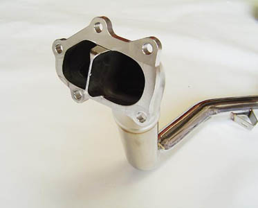

what are you using for exhaust. do you have the aps external wastegate or the crappy internal one.
APS ST exhuast
APs internal wastegate + forge actuatore ( yellow spring )

im afraid its the downpipe. its a poor design. most internal wastegate setups do better when the exhuast gases are divided after the turbo. on my setup i welded a piece of steel in the downpipe. what happens is the exhuast gas causes the internal wastegate to stay open longer than it should causing you to lose boost. i noticed that when i divided the downpipe boost held longer but still tapered off.

From: bama
like below. back when i had my kit i tried my best and changed everything on the kit but still had problems. i also found an old picture that APS released of the kit and the downpipe WAS divided in the early pics. but for some reason they ditched the idea. probably because they kept saying they wanted to make it the safest kit on the market.
so instead of making a kit that would perform great, they sold a kit they knew would perform this way and not cause engine damage. they (APS) sucks.
Attached Thumbnails APS ST started today :)-invidiawrxdiv.jpg
