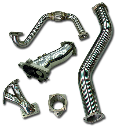

here are 2 pics of the APS kit before they released it for sale. one shows how they divided the downpipe and had 2 outlets. the other shows the metal between the 2.

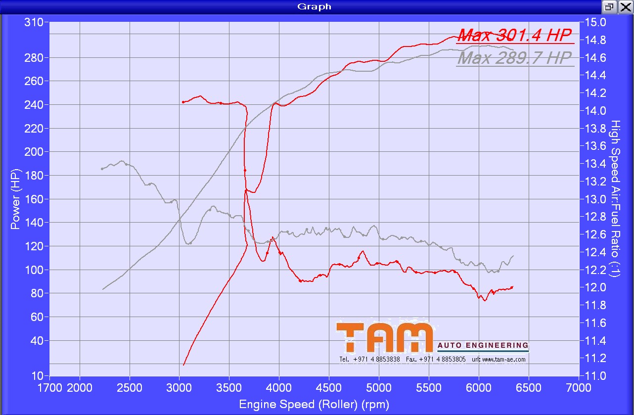

hi guys
i was trying to tune the boost controller on the dyno.
i was really disappointed by the results. but then the tuner told me that the same dyno. a stock Z06 run 355whp. and he was impressed by the number.
anyways. the boost creap is almost done( on the dyno) .
on the street, the issue still there and i loose boost till i reach 6 psi.
i am thinking to tight the actuator abit more.
check out the results below
APS ST started today :)-350z-lutfi.jpg

Do you have a chart of the boost vs RPM?
Old Mar 30, 2009 | 09:08 AM
  #178
nightcrawler_8's Avatar
nightcrawler_8
Posts: 800
From: UAE
nop. i will make sure to get one done next time i go there. i have a retune session on the 15th of april .
boost is .. 0.6 bar and drops to 0.5

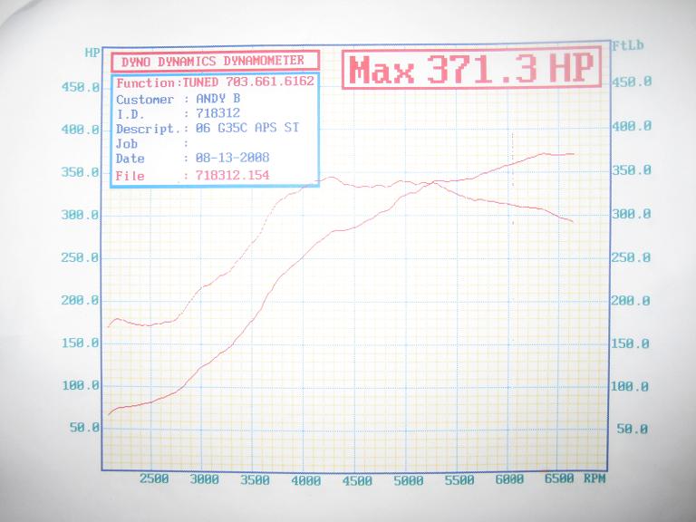

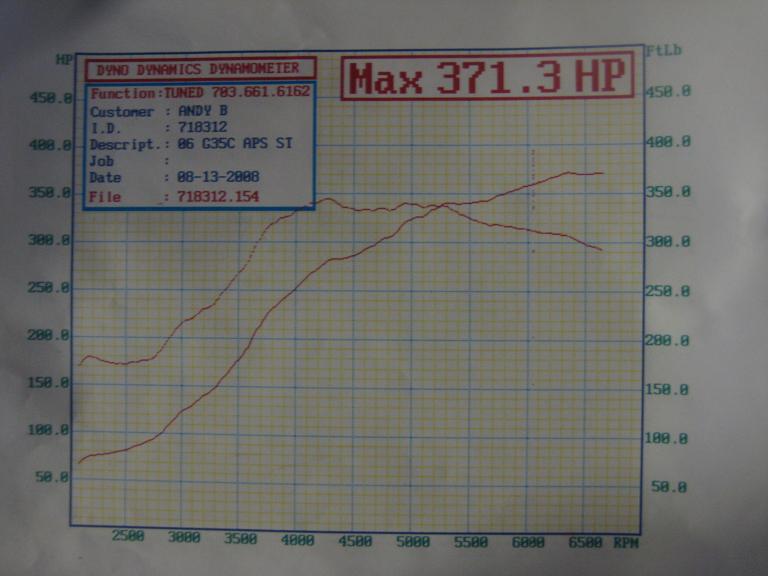

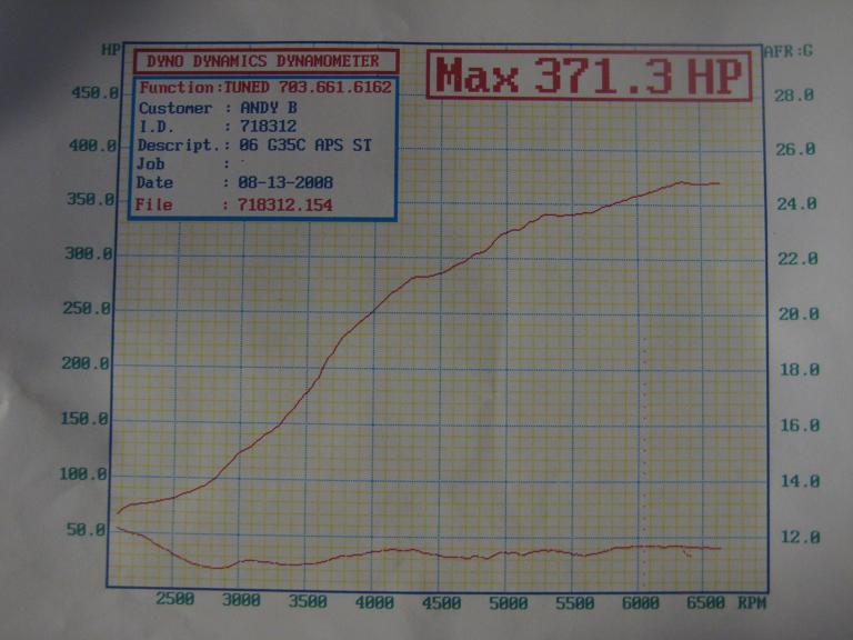

ahh dyno jacked up if z06 runs 355, there in the 450ish mark but thats irrelevant, your graph looks like alot is going on and not in a good way.
here are my graphs-sorry for bad quality shots... your afr are too high and not constant. also your graph starts off like mine(your first pull starting @2.25k and 80hp) but ends up with 80 less hp... even with 3 less lbs of boost, im not gonna be at 290
Attached Thumbnails APS ST started today :)-img_0696.jpg   APS ST started today :)-img_0697.jpg   APS ST started today :)-img_0698.jpg
