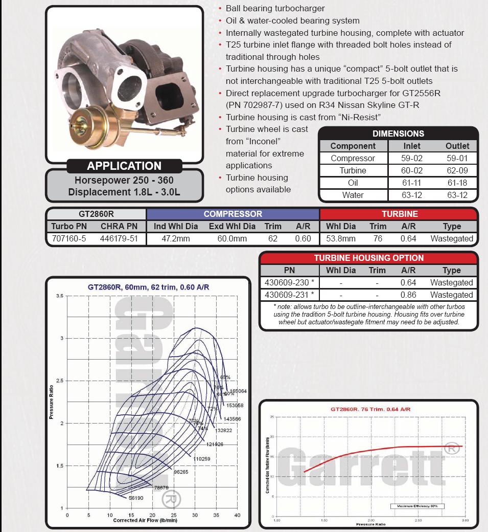

EDIT: I think I found the tech specs for the turbos, but not sure with just a GT28 designation. These I think are a perfect selection for a road course. 500-550 whp on pump gas, maybe a bit more with GTM's efficient piping and IC, depending on the dyno... Very similar to the original APS turbos and the 700bb from JWT. Nice.
