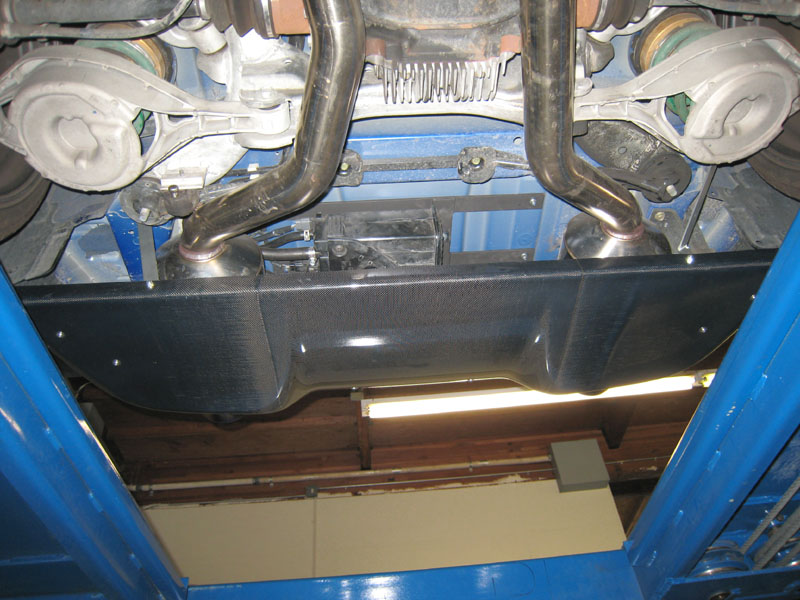

Originally Posted by rr_z33
i got lucky and found this...
That's a lot easier to do with a rear/mid engine platforum. Trying to vent the exhaust heat on a front engine setup will be super tricky...to say the least.

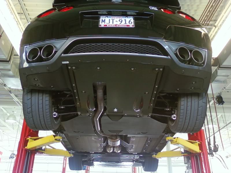

http://new.nissan.gtr.googlepages.com/home
Here are some pictures of the GTR under belly
Thanks very much.....I had one for a few days....but i though that the dealer had removed the center part......This will be too easy..

quick look at the rear diffuser part of the GTR vs say a ferrari theres a few visual things which i bring up to question. the end of the diffuser where the air leaves on the GTR is very flat vs the ferrari's also the use of fins on most other hyper cars: ferrari, pagani, saleen, buggati,and cgt. wonder if those things play a significant role in their design.
i think the GTR's is more for just high speed stability and not as much for downforce. just a guess though.
**edit
after doing some reading the veins are there to help with the separation caused by high divergence angles which im assuming is the point at which the air is leaving the diffuser. which accounts for the use of them on say ferraris because they have much steeper angles. another thing i wonder when looking at the design of the top secret diffuser its almost upside down from the ferrari design. sorry for my excessive use of ferrari as a reference but they are really good with aerodynamic as show in F1.
also some of the reading says the actual dimensions of the object in question has a significant role in the appropriate angle.

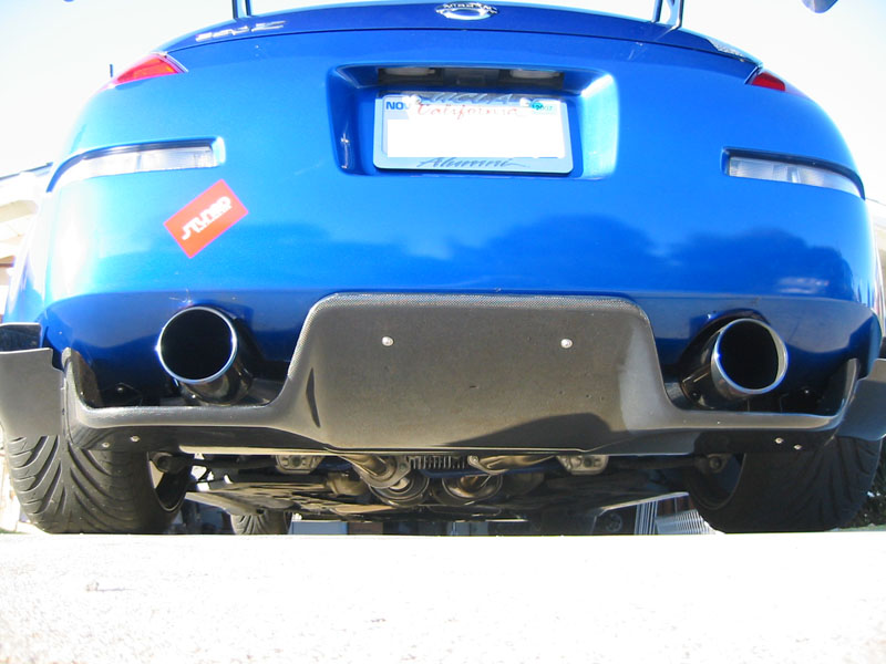

[IMG][/QUOTE][/IMG]
i kind of like this design. you could always dremmel out more room for an exhaust. this one looks like it does a better job of using more area and does a better job of smoothing out airflow before it leaves the car. but this is for a Z not a G so that is a small problem. the only issue i see is where the springs sit should be covered. that looks like it could cause a HUGE amount of drag and turbulence.

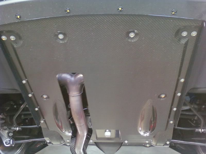

Originally Posted by RudeG_v2.0
I don't think the Top Secret diffuser would be a waste of money Mike. Unlike radiologue, I have no reason to believe the Top Secret diffuser isn't functional. Just look at the design and the vortex generators on the side. And it also covers the void left behind when the stock muffler is replaced with dual exhaust. Smoky tests all of his aero parts at high speed. The guy is a wangan legend. How many owners test their own parts at 200+mph???
I believe my point is that the Top Secret Diffuser would be much more functional if used in conjuction with additional underbody trays because the diffuser itself leaves a huge gaping cavity under the rear of the car. Without the additional undertray it seems like it would be little more than an aesthetic enhancement. I cannot disagree that it may be a good starting / ending point.
Attached Thumbnails XKR Super G... Going for Mach 1-tsdiffuser1.jpg   XKR Super G... Going for Mach 1-tsdiffuser2.jpg
