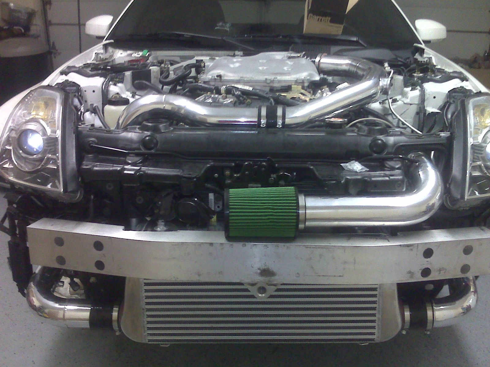

Hey guys what do you all think of the relocation of the coolant reservoir. Does anyone see a problem with where I positioned it. The bumper barely clears it but it works. Too bad I won't be able to check it easily.

hey OP, relocate that line that goes to the intake. You might be able to see how I did it. Under the headlight I believe.

Thanks TXSHLDM, I noticed that it was being pinched a tidbit the way I had it so it makes sense. I'll buy longer hose and reroute it.

I had to do the same thing on mine. Didn't seem like it would pinch but not sure when things get heated. So I rerouted mine under the headlight. Nice process so far. GL with you have left!!
