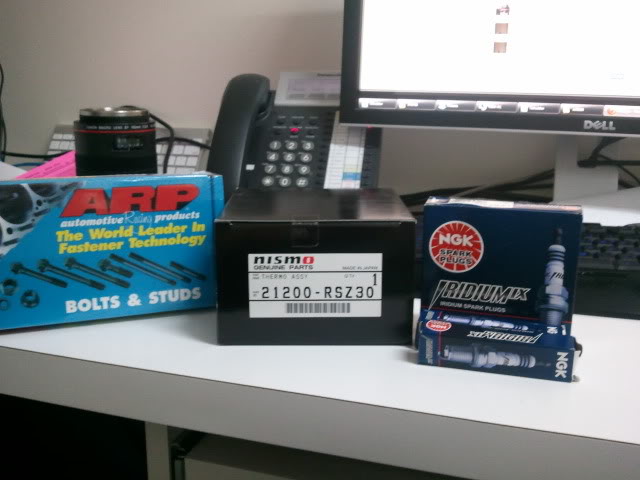

ARP Main Studs
Nismo Thermostat
Extra set of 1 step colder spark plugs just in case

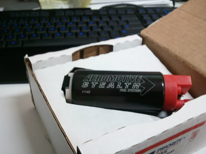

What offset is that pump? Center?

as the pic shows its pn 11142.
offset inlet/inline
