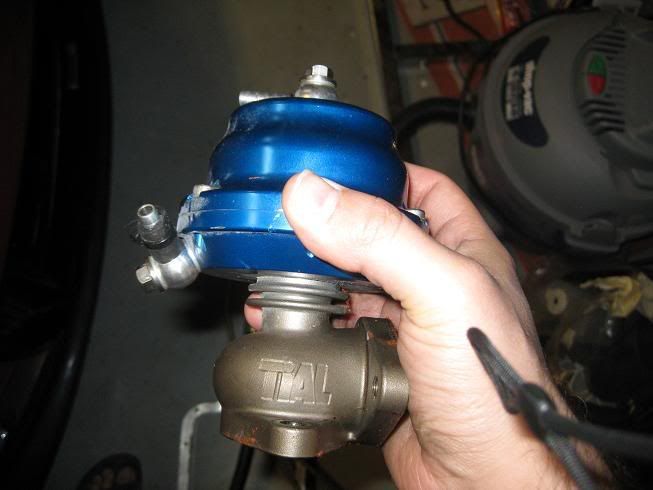

Greddy TT kit, 18g, tial WG

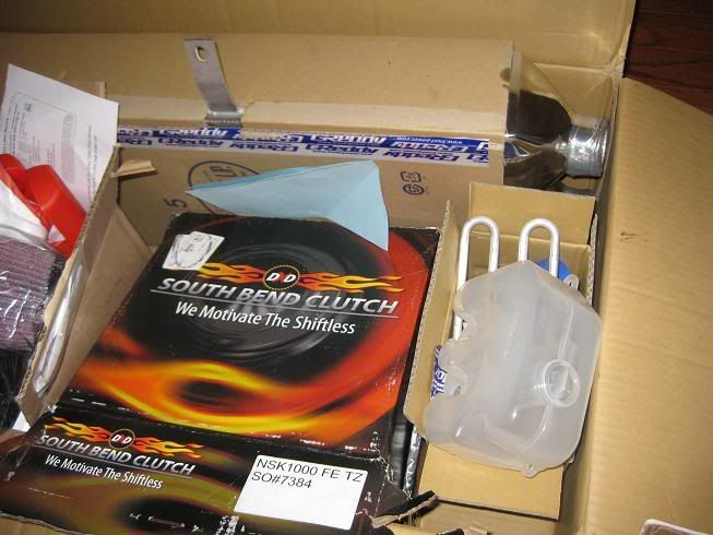

Southbend DXD Clutch..stage 5 with custom clutch disc to hold 600whp

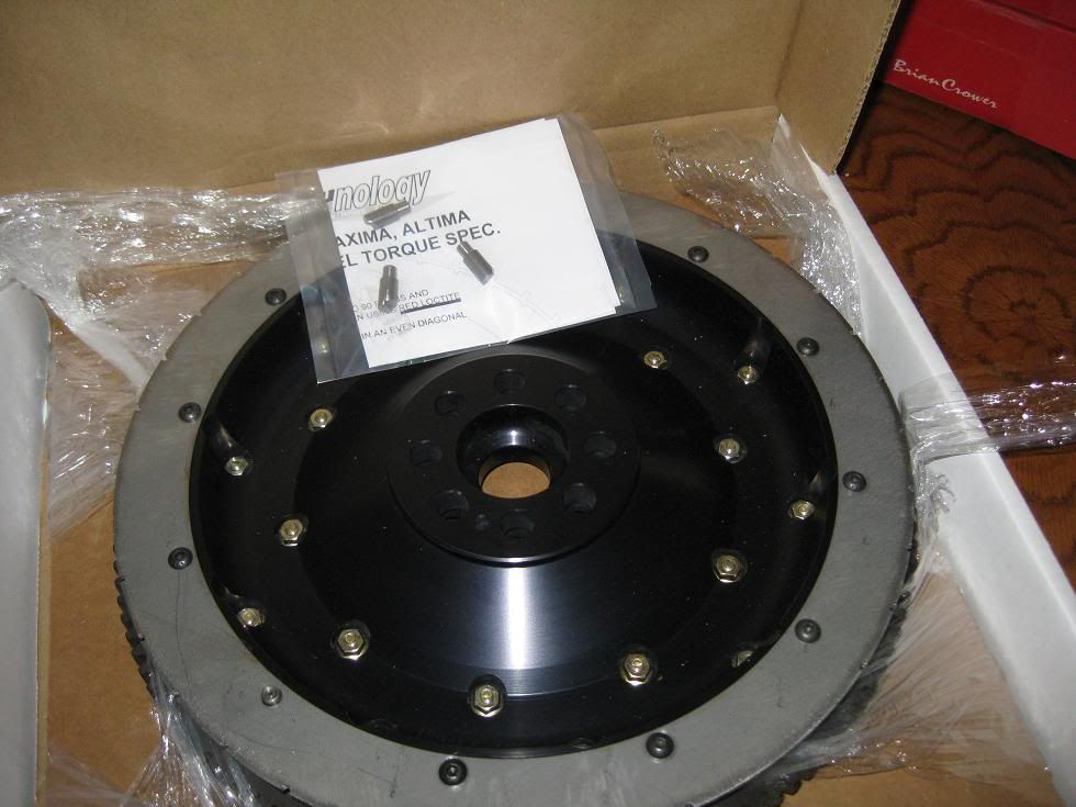

Jwt Flywheel

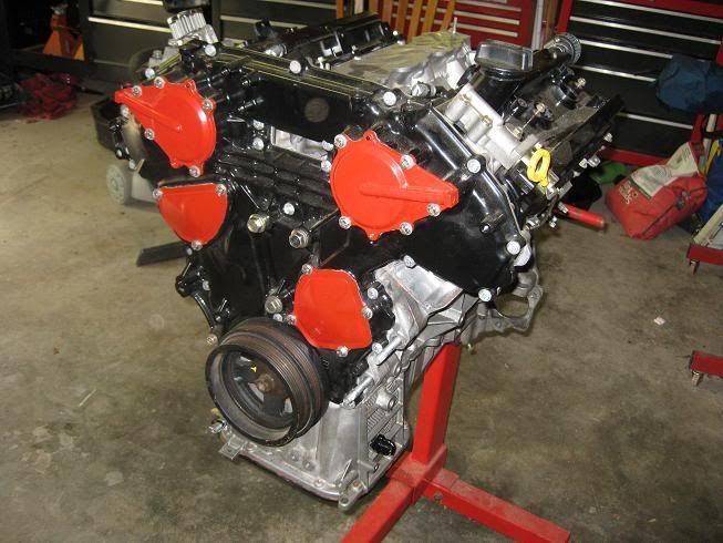

Plan is to install most everything I can onto my built longblock...which will eliminate the hard part. Motor swap should occur in August...then break in of clutch/motor and tune. 500 whp should be attainable right!

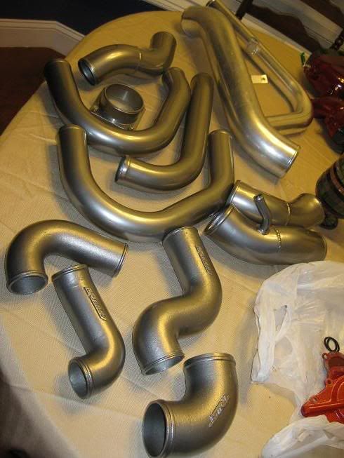

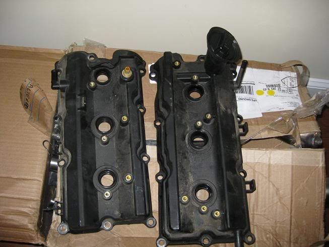

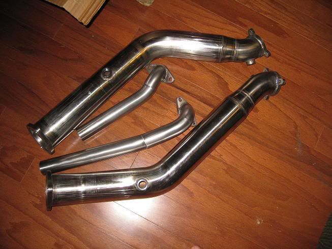

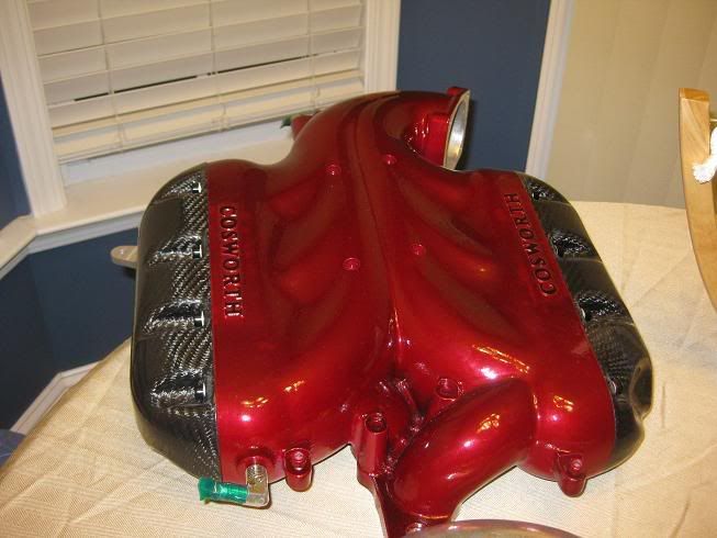

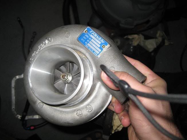

Pics, cause everyone loves pics.
http://i265.photobucket.com/albums/i...z/IMG_1397.jpg
http://i265.photobucket.com/albums/i...z/IMG_1411.jpg
http://i265.photobucket.com/albums/i...z/IMG_1412.jpg
http://i265.photobucket.com/albums/i...z/IMG_1413.jpg
http://i265.photobucket.com/albums/i...z/IMG_1414.jpg
http://i265.photobucket.com/albums/i...z/IMG_1417.jpg
http://i265.photobucket.com/albums/i...z/IMG_1418.jpg
http://i265.photobucket.com/albums/i...z/IMG_1419.jpg
http://i265.photobucket.com/albums/i...z/IMG_1420.jpg
http://i265.photobucket.com/albums/i...z/IMG_1421.jpg
http://i265.photobucket.com/albums/i...z/IMG_1422.jpg
more parts in!!! 5-28-2010
http://i265.photobucket.com/albums/i...z/IMG_1425.jpg
http://i265.photobucket.com/albums/i...z/IMG_1424.jpg
http://i265.photobucket.com/albums/i...z/IMG_1423.jpg

HotrodG35 will be helping with the swap....he has a sick built motor/vortech/n20 g35.h

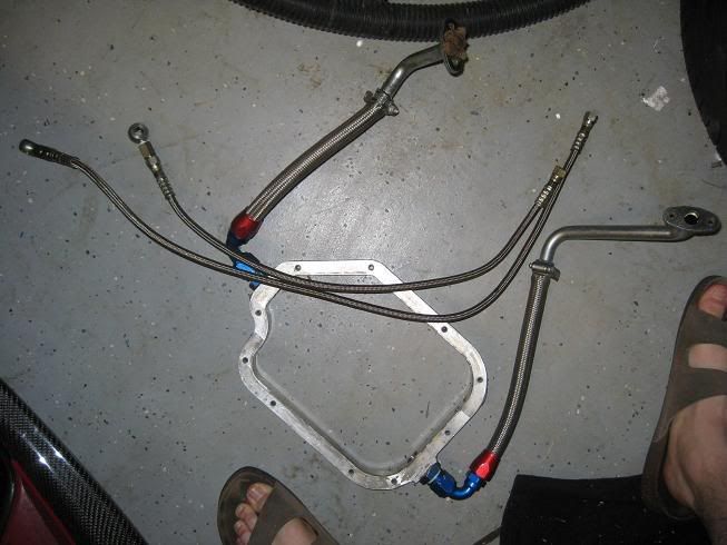

are those the stock greddy oil supply lines? if they are, i would ditch them. i made new ones before i put my greddy kit on. just for peace of mind. not necessary tho. search my started threads if you need a how-to on making new oil supply lines.
other than that, right on dude. looks like it'll be fun. shouldnt be any problem making a good 500 whp with that.

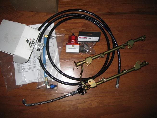

the 90 degree fitting on the fuel rail end, the straight goes into the regulator
looking good!

^thanks Charles...Im sure I would figure it out when i went to install it. Looks like a very simple install as far as basic RFS go. I was looking at the stage 1 install pics...
I may ditch the utec. They dont sell for much. Only thing about going haltech is the entry cost and having to accessorize it with more stuff.
looking good!
wow, i have mine backwards but it fits perfectly without problems so i'm leaving it.
