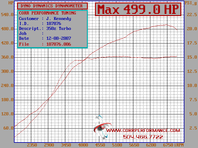

Forgot he actually emailed it to me years ago
I believe he made ~520whp on Sharif's dyno as well.
