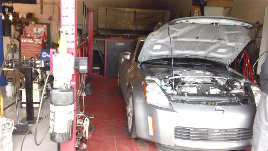

Car is at intec, being hooked up to the Dyno right now... should be tuned by 3:00 PM
