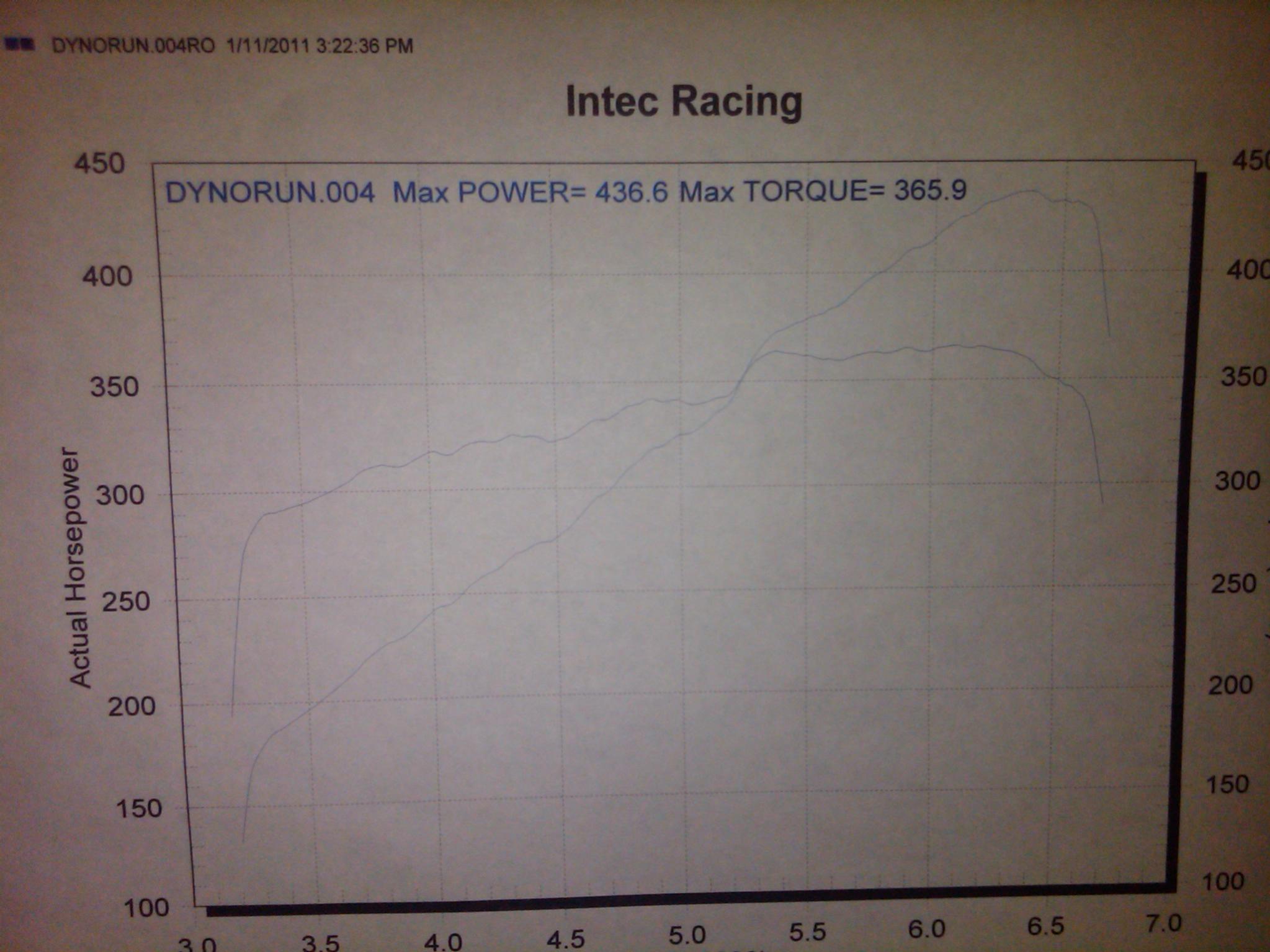

i'd be extremely careful. I assume you are just using stock plugs now?
too low of octane, too high of AITs, etc can all cause that as well.
now is when you better trust your tuner 100% becuase if its knocking enough to pull timing in this cold weather, even with 1 step colder plugs, come summer your block might decide it needs a little ventilation.
Originally Posted by RetchedOne
Me Too???
He showed me the graphs, what he said makes sence.
I'm going off what he is seeing and what the graphs sare saying...
It tries to pull timing at high rpm's due to knock... the line goes from a nice smooth ramping line to bumpy crap close to redline.
You can see it pulling timing due to det.
This is what lawrence said.
Plugs are ordered.
I dont plan on flogging the car.. till teh new plugs are in...
I've got the dyno sheet...
Now to get it scanned...

Dyno run Doc -
436 HP
365 TQ
Once the new plugs are in, Intec will strap it to the Dyno again to adjust a few things.
Lawrence expects the high end torque to improve with the colder plugs.
Me Too???
Ummm, no. I'm pretty sure the stock ECU does not pull timing after 5k rpms. It only attempts to detect knock at peak torque and then the window is off. If you are seeing irregular patterns above that, it's something else.
I run 2 step colder NGK iridiums. I think 1 step colder is probably fine too. Never knew Greddy branded their own plugs.
