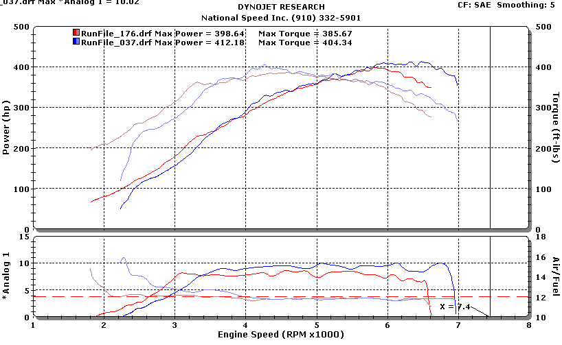

The red graph is our test mule (base map at 8 PSI with headers)
the blue graph is same kit (base map at 10psi without headers)
There is a good 400 RPM faster spool to 8 PSI, again both cars are waste gate spring pressure, no boost controller.
The blue graph was also a final tune.
Both cars, stock motor, out of the box kit, tuned with 600cc injectors and uprev. this is as close to apples to apples that I can provide. same turbo kit, same dyno, just the difference that headers make. this is a GT3582r with a 1.03 A/R

Thank you very much Bryan. The 400rpm spool up difference alone tells me that there would be a flow issue with the OEM headers when being pushed past 450whp on a DD dyno.
If it makes that big of a difference (400rpm) that early on in the RPM range, just imagine what it would do at 6000rpm

first you said blue line was 10psi then you said 8psi
You also said blue line was base map then said it was final tune

Sorry blue line was tuned at 10 PSI, too many irons in the fire, oour base map is 8PSI, and that is our WG spring. obviously my left typing hand was not keeping up with my right typing hand myself

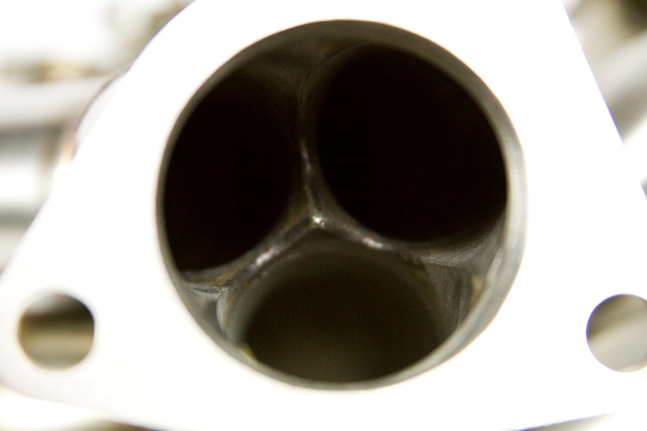

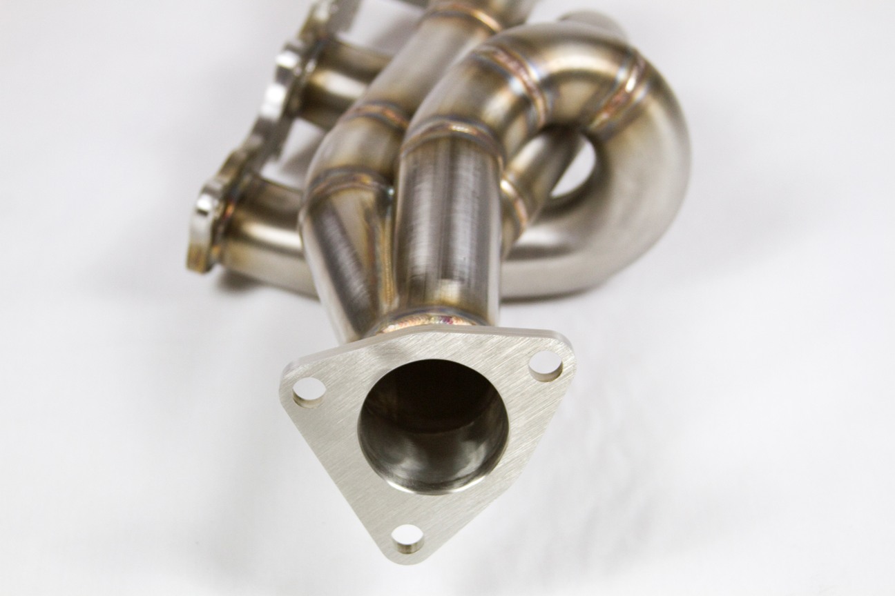

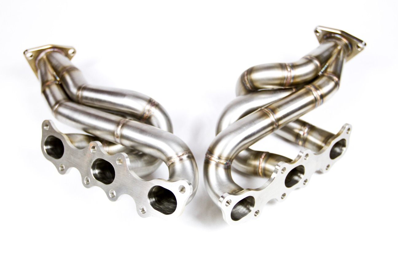

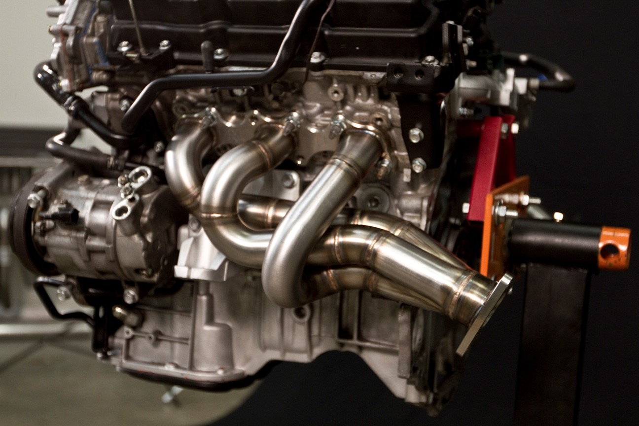

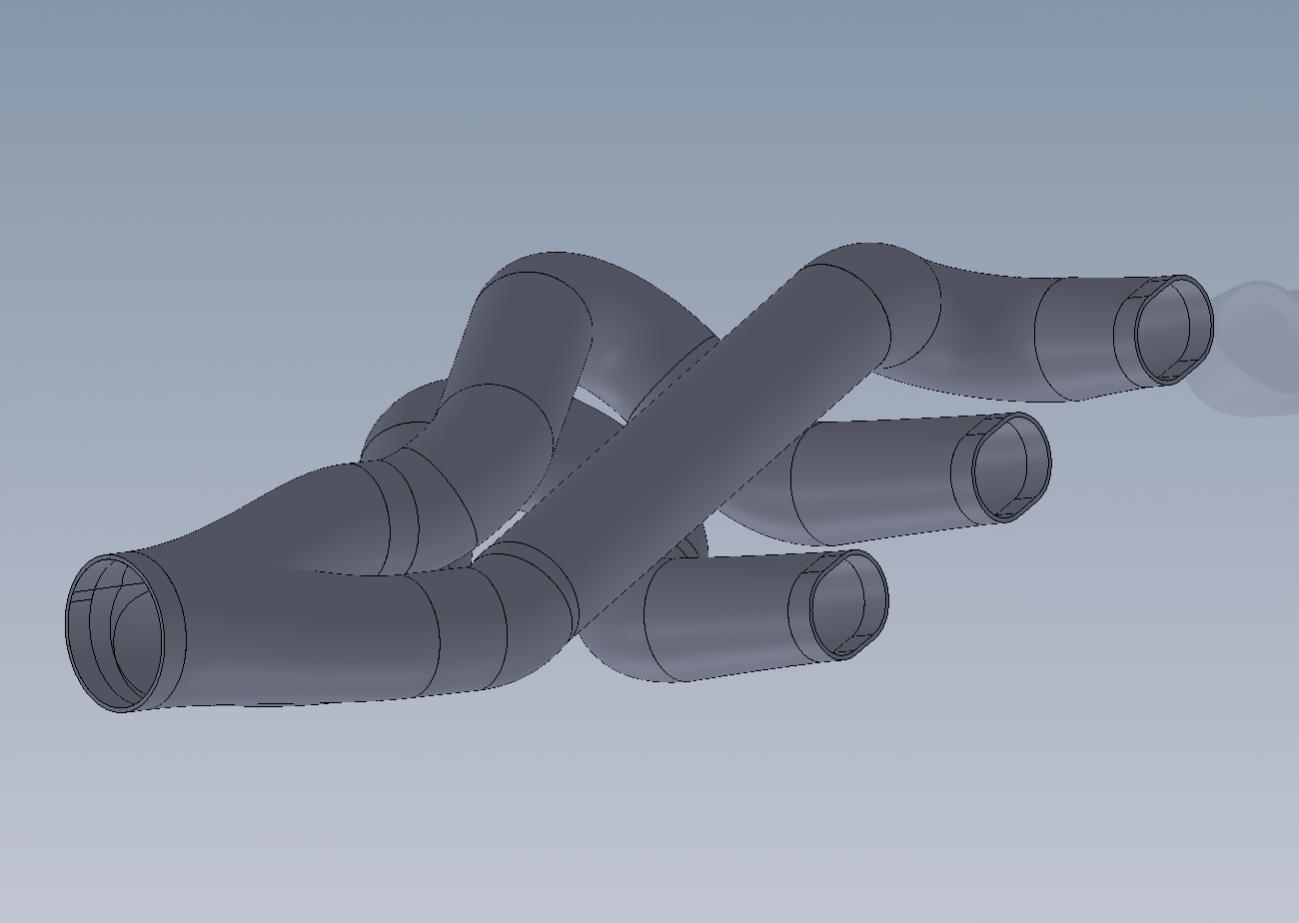

Sasha, thanx for the plug.
Our headers were dsigned to work well in an NA or FI solution, I'mnot sure if any others make that claim. Our headers are also built to take the heat of FI and as it was stated earlier, Flow + scavenging make power. Our headers are equal length, 1.75" primaries, with a merge style collector. All tig welded, back purged, 16 gauge 304 stainless. We do see imroved spool properties with our headers. Like Sasha referred on a stock motor, same turbo kit, same dyno, same same same, we saw 8 PSI 400 RPM sooner.
We have tens of thousands of miles on multiple sets of headers on turbo kits and zero failures.

look at the difference in fuel during spool up between red and blue graphs. The red graph is 12.0 afr @ 2200 rpm while the blue graph shows not touching 12.0afr till 4000 rpm. Im not a tuner or a guru but that to me seems like a considerable factor in spool that should be adressed when comparing the two. I dont know what it means but maybe u tuners can enlighten us.
