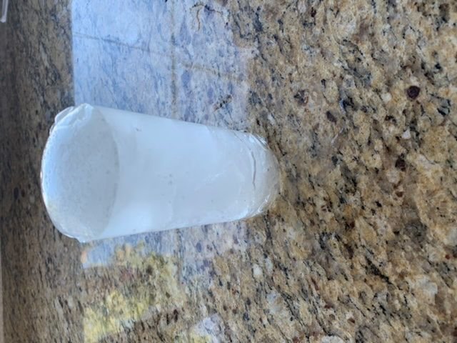

Oh yea - I definitely would and some guys are using C02 shots to spool-up quicker. I think the Link can handle that. I need to get other things ironed out first. I'm not too wildly concerned about building boost. I think it's mostly in the ignition timing and the boost control solenoid.

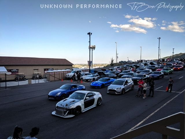

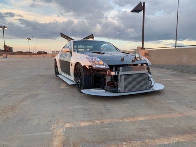

I had the car out last night and I put some duty cycle in the BCS and I was making boost much more efficiently and quicker. I'd definitely consider it!
I had the car out last night with my buddy who has the blue Z and a guy wanted to come shoot our cars for his photo business so we all met up.
From a mechanical side, the car ran fine - the boost was a little more present as I messed with the BCS and I activated the water methanol. It really only sprayed two or three times on the way home. It was dark - I didn't have my radar detector and there are deer on the main road home so I didn't get too crazy with the car.I had a quick conversation with Conway the other day and was throwing around the idea of would WMI perform better if it was cold? could you fill the WMI tank with ice to cool the WMI solution down to ~40degrees? would that further help decrease IATs? It would obviously mess with the water:methanol ratio if you were looking for a 50:50 mix? The experiment goes on and I started looking for longer cylindrical ice molds and a 2.25" aluminum IC pipe, about 4.5" long will work. So I filled it with water and put it in the freezer. My next attempt with be adding some methanol to the water mixture that I freeze. But here's prototype #1: I don't know that this will yield ground-breaking results, especially for the trouble / hassle / effort put in. It may be more efficient to fill the tank (and my tank is 1 quart) with 20% water, 40% ice and 40% methanol and know that the 40% ice will only be good for that single pass.

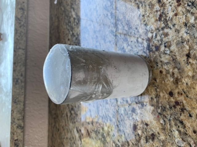

I don't know how dry-ice would fair? That's alittle bit more trouble with added cost and hassle.
here are some pics from last night...
Nice, don't forget the density of ice changes when water turns to a solid.
Safe to assume you're freezing distilled water?
Old Jun 29, 2020 | 05:08 AM

I'm trying not to get too locked up in the math & science of it ... I dont mind doing 50% water and 50% meth and dropping that ice cube in there ... obviously when the ice melts complete I could be at 70% water and 30% meth but it's all good. The intake air temp sensor (although analog & slow) will pick up on the lower intake air temps sufficient for my use. I want WMI for the lower intake temps and the cleaning not necessarily the octane boost.

I will probably abandon freezing WM as it's just too big of a pain in the bummmm. But I did get a few squirts of WMI and I'm not sure if it did anything.

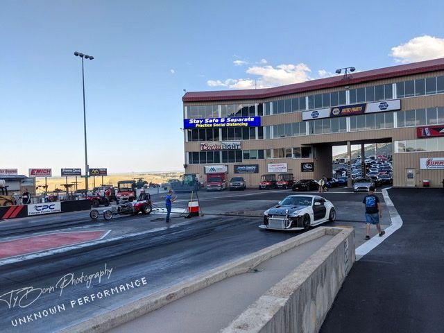

We got some stickers printed up from a buddy were doing a turbo kit for.
And our buddy Tyler (Tyler Bonn Photography) got some nice shots of our cars. Here are some of his shots:
