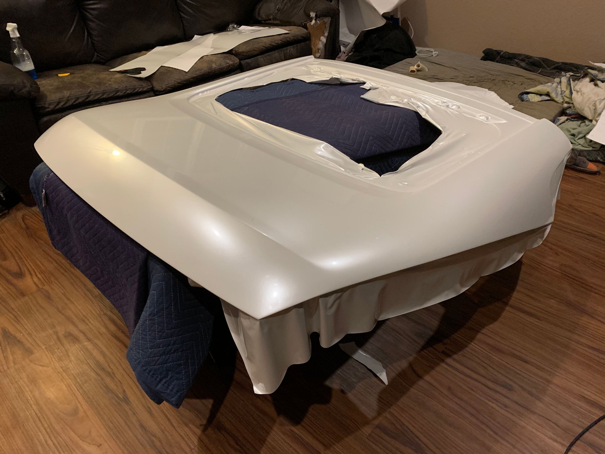

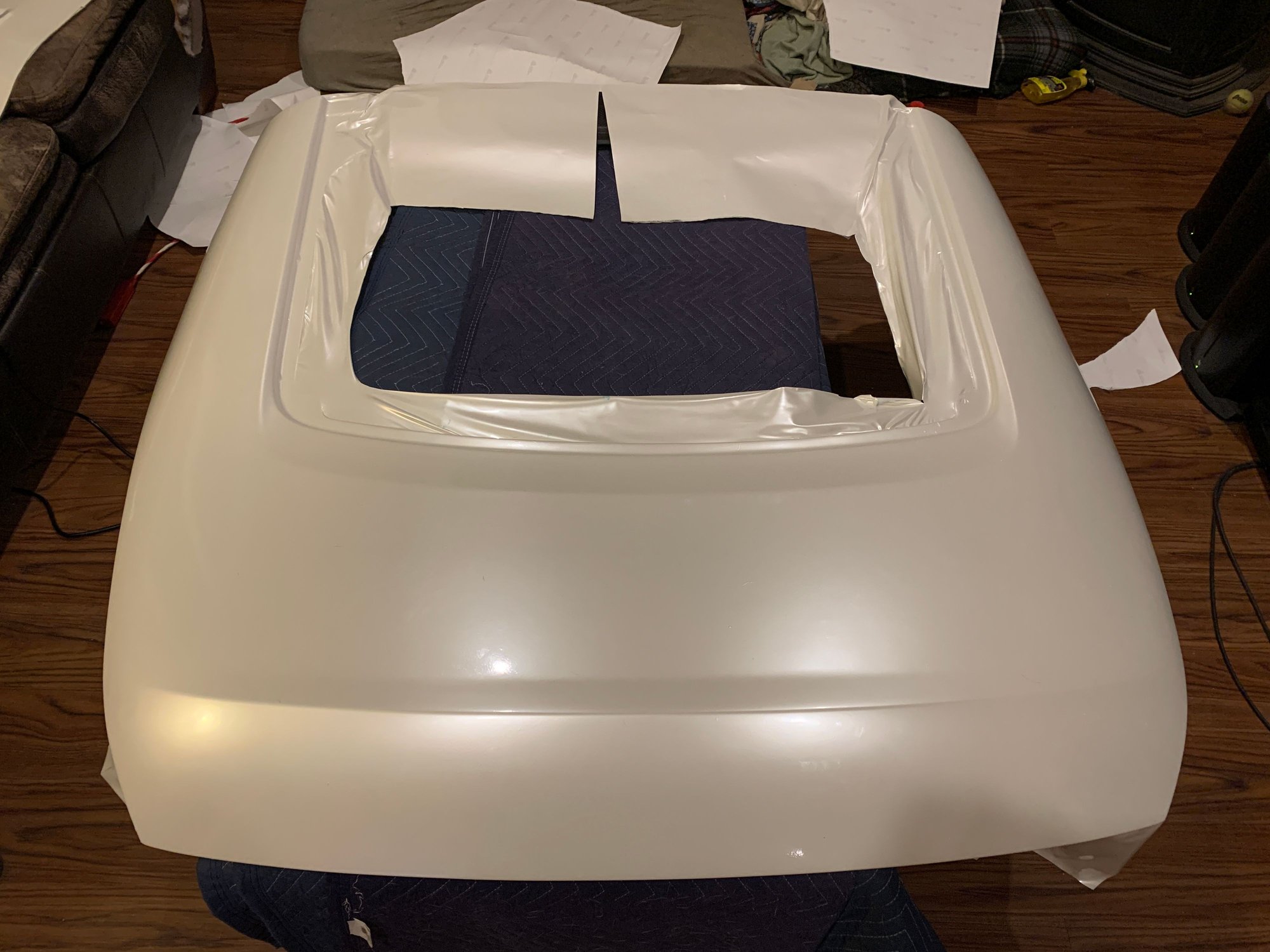

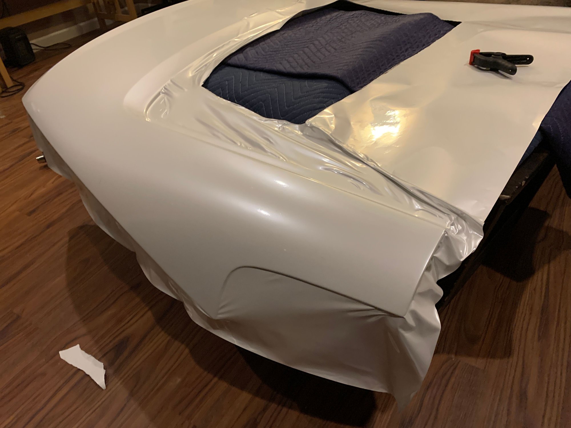

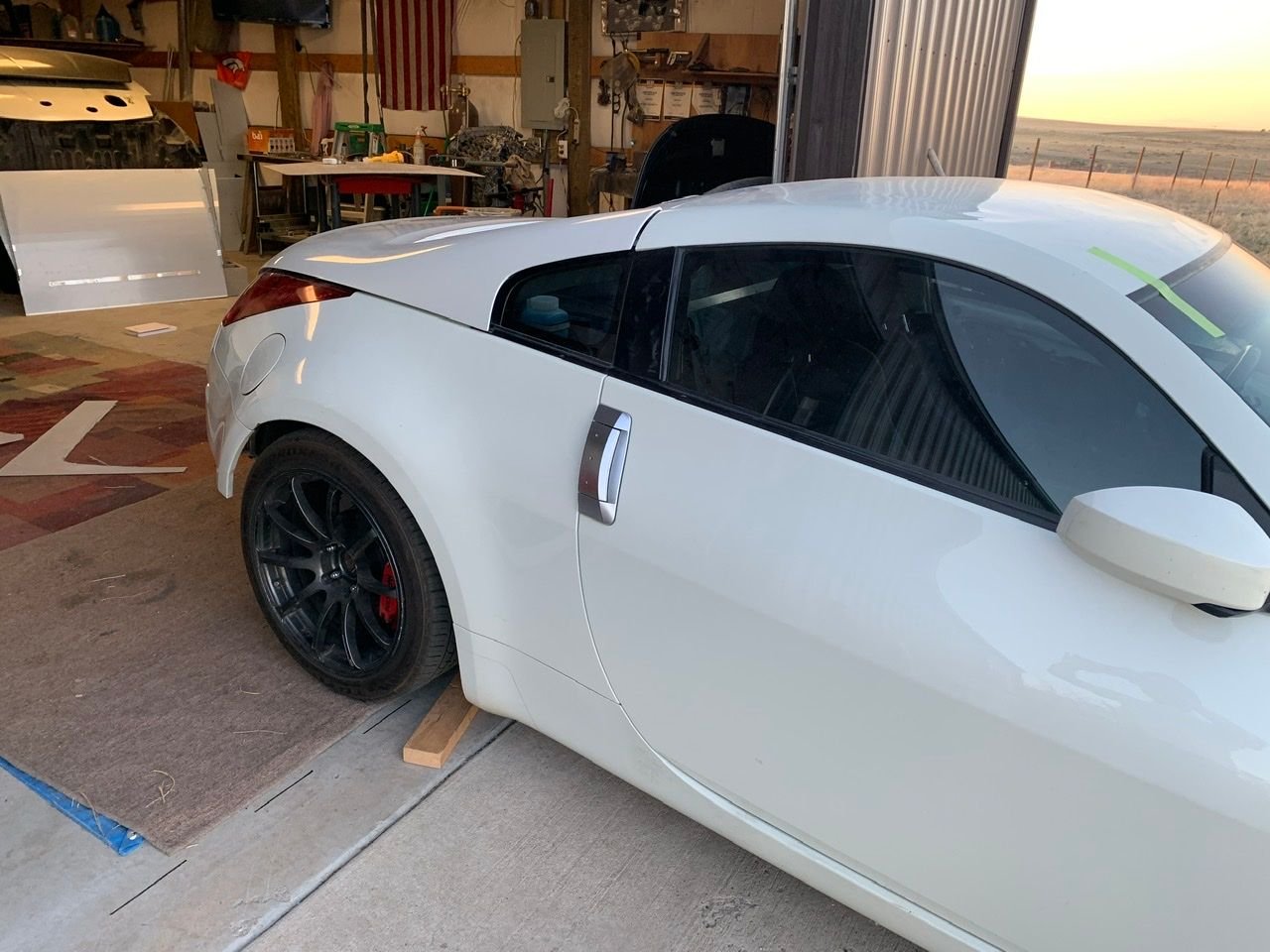

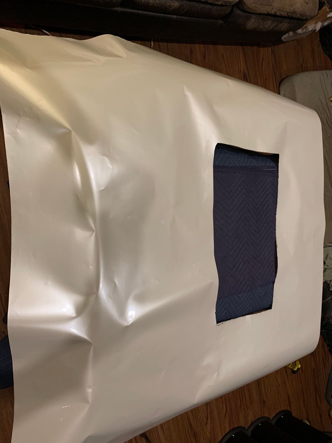

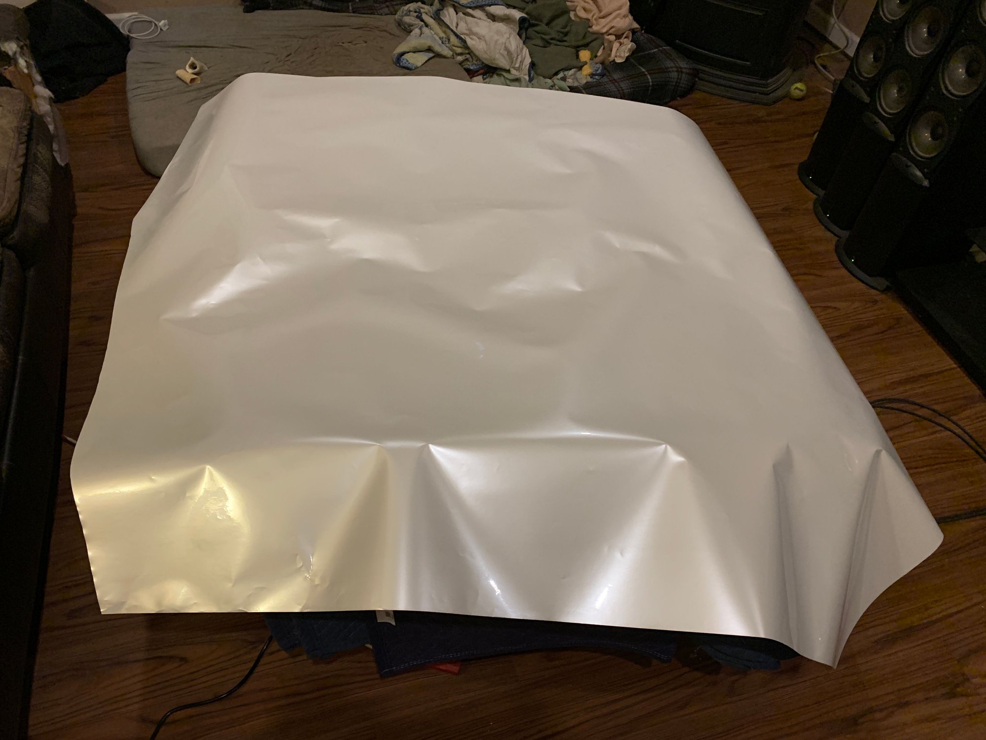

About 85% complete with wrapping the hatch...Finished the top surface and will need to do corners and edges tomorrow. Took about 3 hours to do the top surface from start to finish. Was actually enjoyable - it's challenging but satisfying none-the-less. Overall happy with how it came out, not perfect / has imperfections but I think it will look fine from 5ft away. A good learning experience and will definitely do it again! Happy to be able to put the hatch on the car full time.
A few lessons learned
A YT video suggested practicing with the film before getting started - so I cut triangles out (where the tail lights would be) and practiced placing, purposely putting folds in and taking them out, and practice heat the film ... sorta was a calibration of sorts. If/when I wrap again I will but an extra few sq. feet to do this again.
I draped the wrap over the car earlier in the week (outside) and this probably wasnt smart bc a bunch of dirt/grass/debris got on both sides of the wrap and subsequently got on the hatch. I used compressed air to clean off and I re-cleaned the hatch but I think there was going to be a little left on the wrap & hatch no matter what.
I did this inside my living room bc the garage was cold (we just got hit with a mild snowstorm). And of course dog hair is just about everywhere (no matter how much you clean) and I think a few hairs got under the film...it is what it is. But it would have been easier if the hatch was installed on the car.
the squeegee was necessary but using a finger was almost better and was easier to feel when the film was binding-up.
They say a heat gun is better than a hair dryer but it may be better to have both especially if the film is very heat sensitive.
One YT video said in some cases putting stripes or stickers can pay-off so I burried a seibon sticker on the drivers side towards the roof.
some pics:

Old Apr 2, 2020 | 11:39 PM
  #1044
rustyschopshop's Avatar
rustyschopshop
Joined: Mar 2014
Posts: 1,405
Likes: 374
From: Watauga, Texas
looking good, are you going to do a poly rear window?
yeah - just ordered a 1/8" tinted sheet.

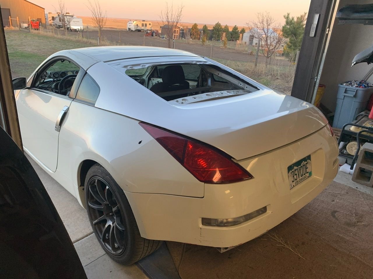

hatch is wrapped up (lol, npi) got the edges done and they look half decent ... not great but I dont really car - no one is going to see them! the corners at the taillights were difficult and the arches over the side windows were hard to heat/stretch the vinyl - luckily nothing tore!

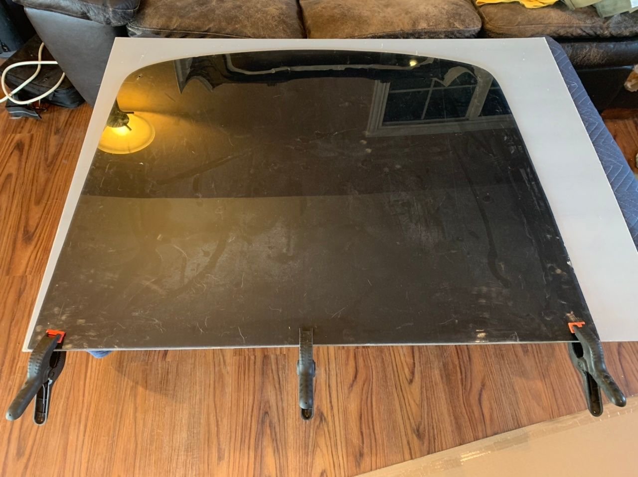

Waiting on lexan (should be here next thursday) and I'll get the hatch completely done and installed on the car - excited for it!

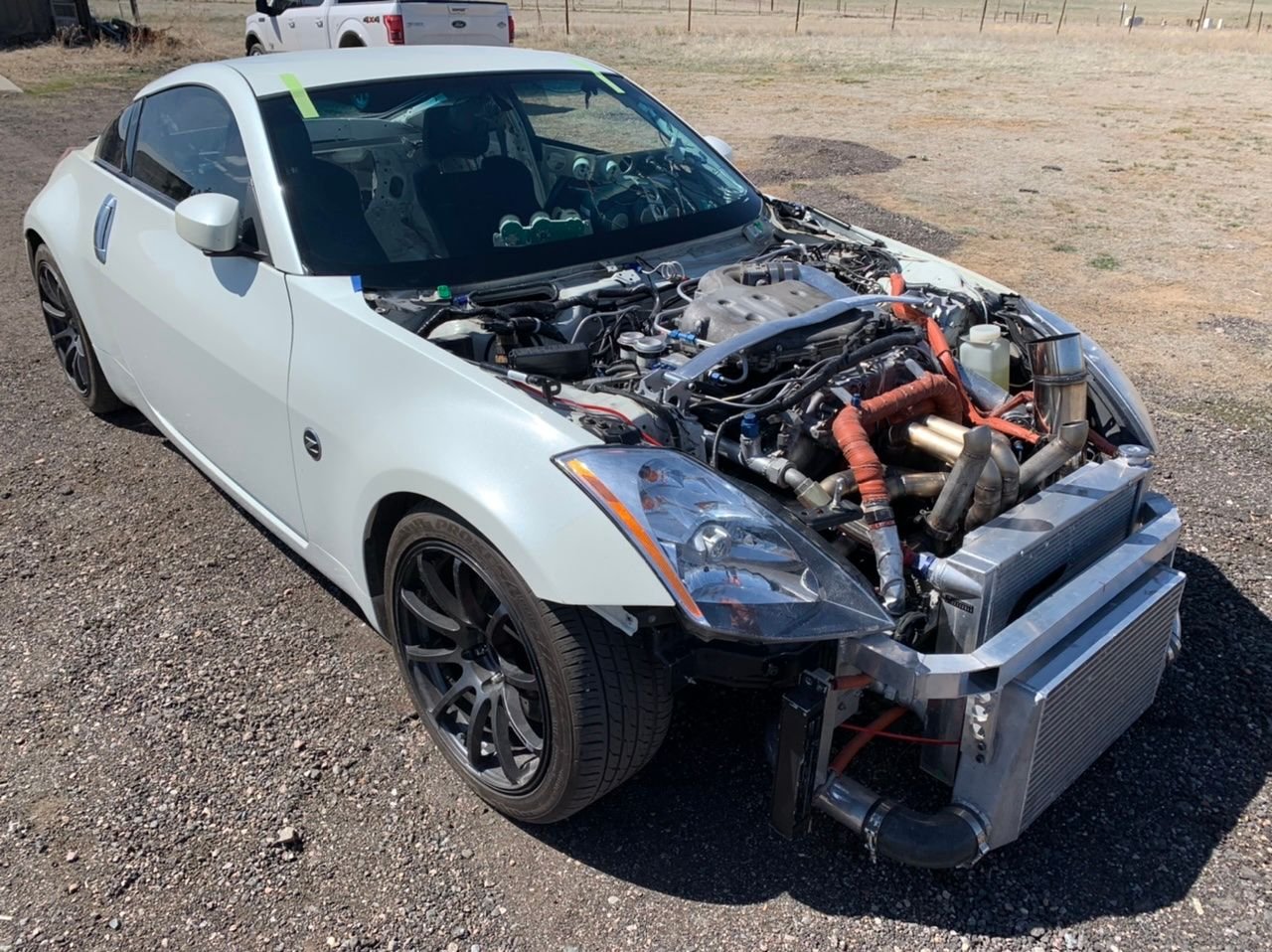

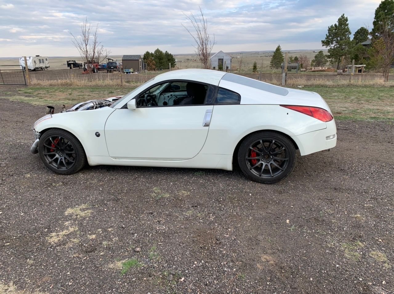

Drove about an hour & a half and sold the white hatch and bought a silver/grey hood ... over the next week or so I'm gonna cut the vents out, re-mount the hood-pin locks, and cut the hood-exits out.

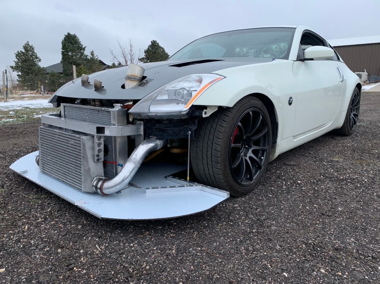

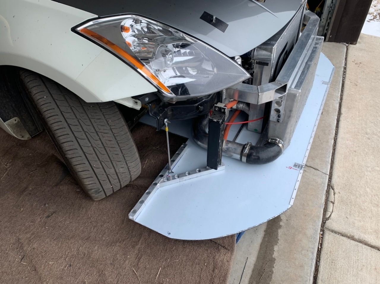

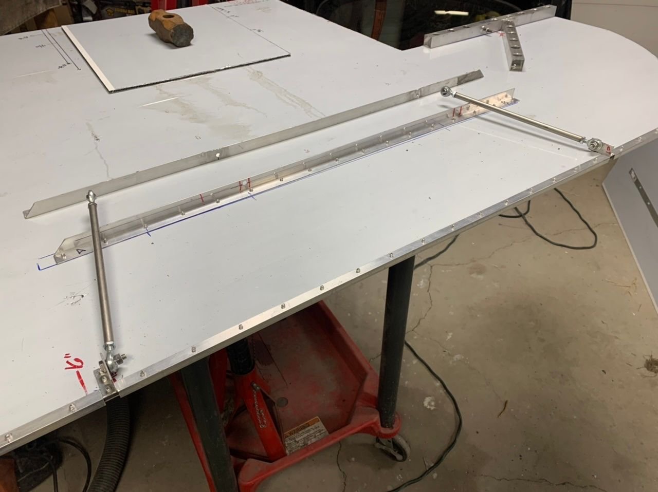

I had a little bit of time on my front splitter ... I installed mounts for the front heim-joints and connection points on the car (same aluminum that hands the IC) and trimmed the arcs on the sides.
I attempted the calibration of the knock control system on the Link but I didnt get the results I anticipated. Essentially, put the rear wheels in the air and run the car at 2k rpms and advance timing until you hear knock. Calibrate the knock settings that when it reach that particular point to initiate knock control (ie retard timing). I couldnt get the engine to knock but on a single cylinder and even at that it wasnt consistent!
Part of my problem may have been I didnt have enough load on the engine. The HPA tutorial / webinar did this at 2k rpm and 0kpa / 0psi (on a naturally aspirated engine) and I cannot mimmic loading the engine like a dyno does...I may try to left-foot-braking. Some silver-lining - I ran the car at 2k rpms for a good 10-15minutes straight and the engine sounded good (checked header runner temps and they were pretty consistent) and temps stayed between 190 and 200 degrees.

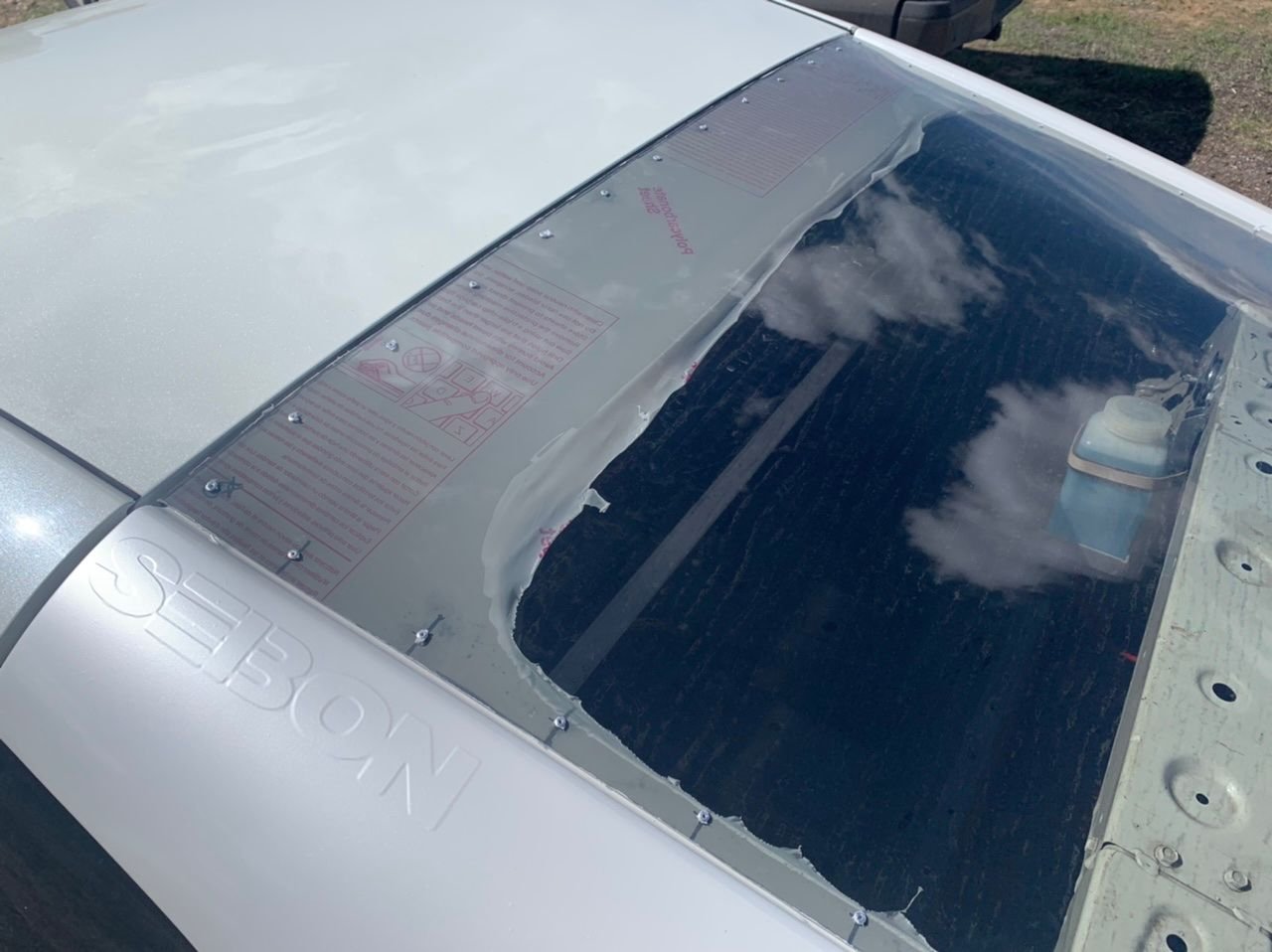

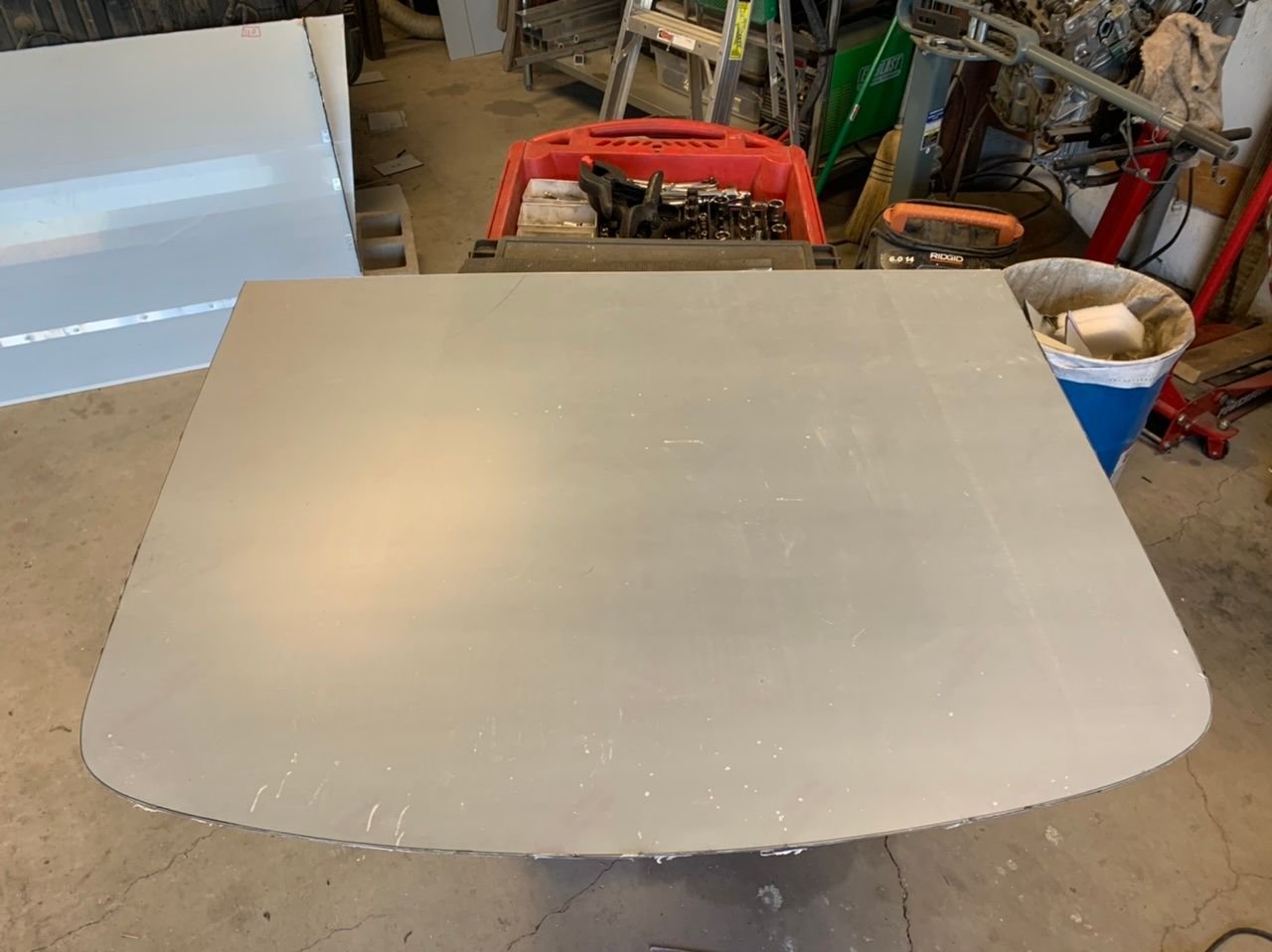

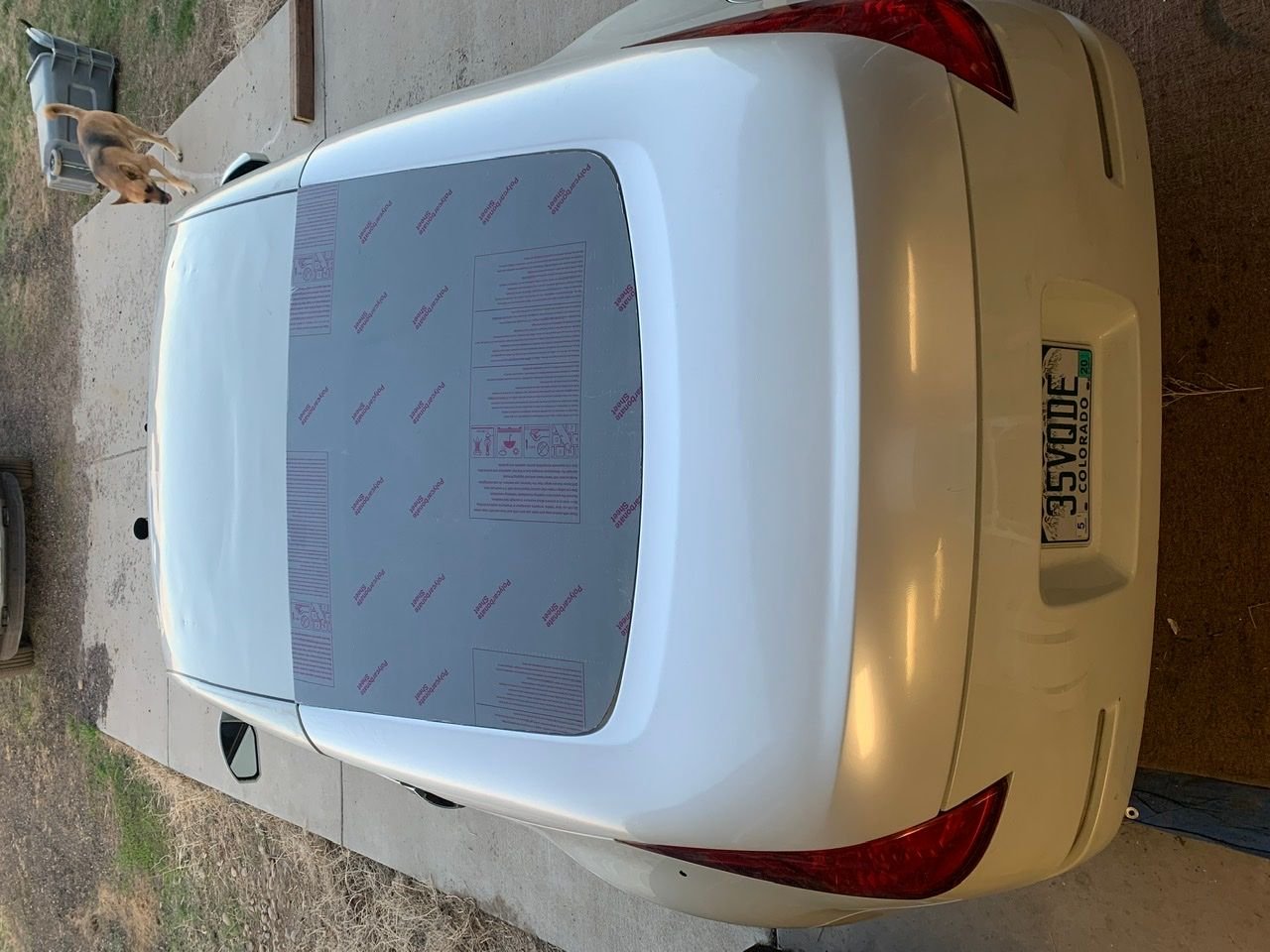

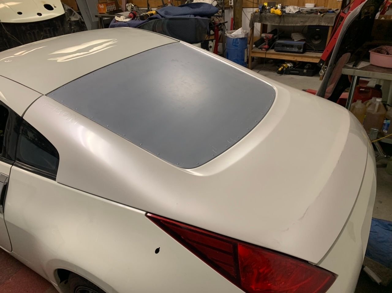

the sheet of lexan came in and I wasnt sure if 1/8" was gonna be right - part of me said go ***** to the wall and get 1/16" but 1/8" was the right decision - not too thick and it came in around 6.5lbs. I got it cut, trimmed down to dropped in. Needed about 3 itirations of trimming it down but happy with the result. I am going to rivet it in place with 1/8" rivets and marked the perimeter and it worked out well at 3.5" spacing - which was sorta dumb-luck. Marked and drilled holes and set the lexan in and spent 5minutes comparing gaps left to right and sank the bottom center rivet to start and re-checked gaps. Nervous as hell to drill through the cf... everything turned out fine except I ran out of rivets.
On a side note - I'm happy with the color match of the wrap - not perfect but pretty good and I'm excited to see how it looks in day light. I think it looks better in person than in pictures.

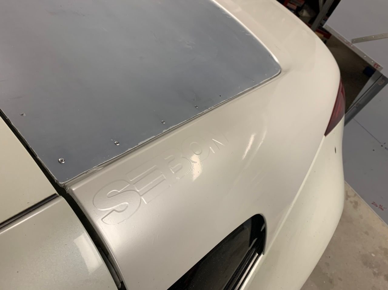

got a picture of the seibon easter egg and you can really tell the damage to the roof where the white hood flipped up and pushed it in...

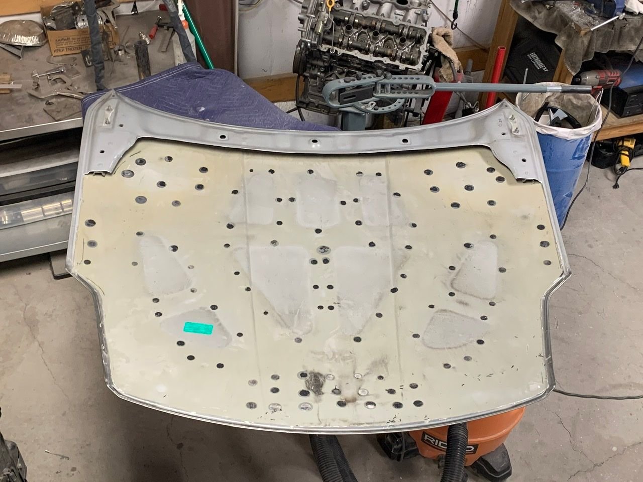

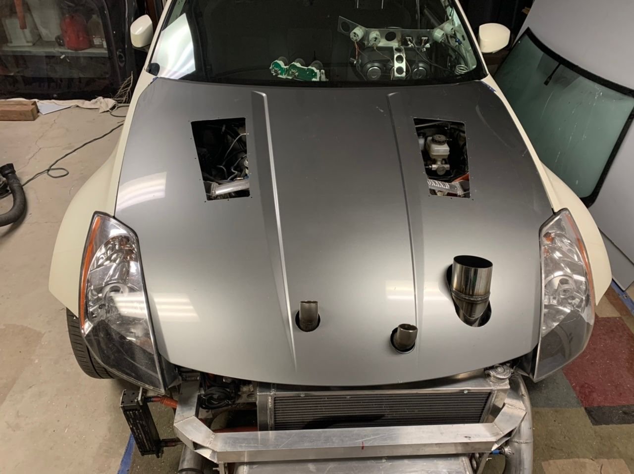

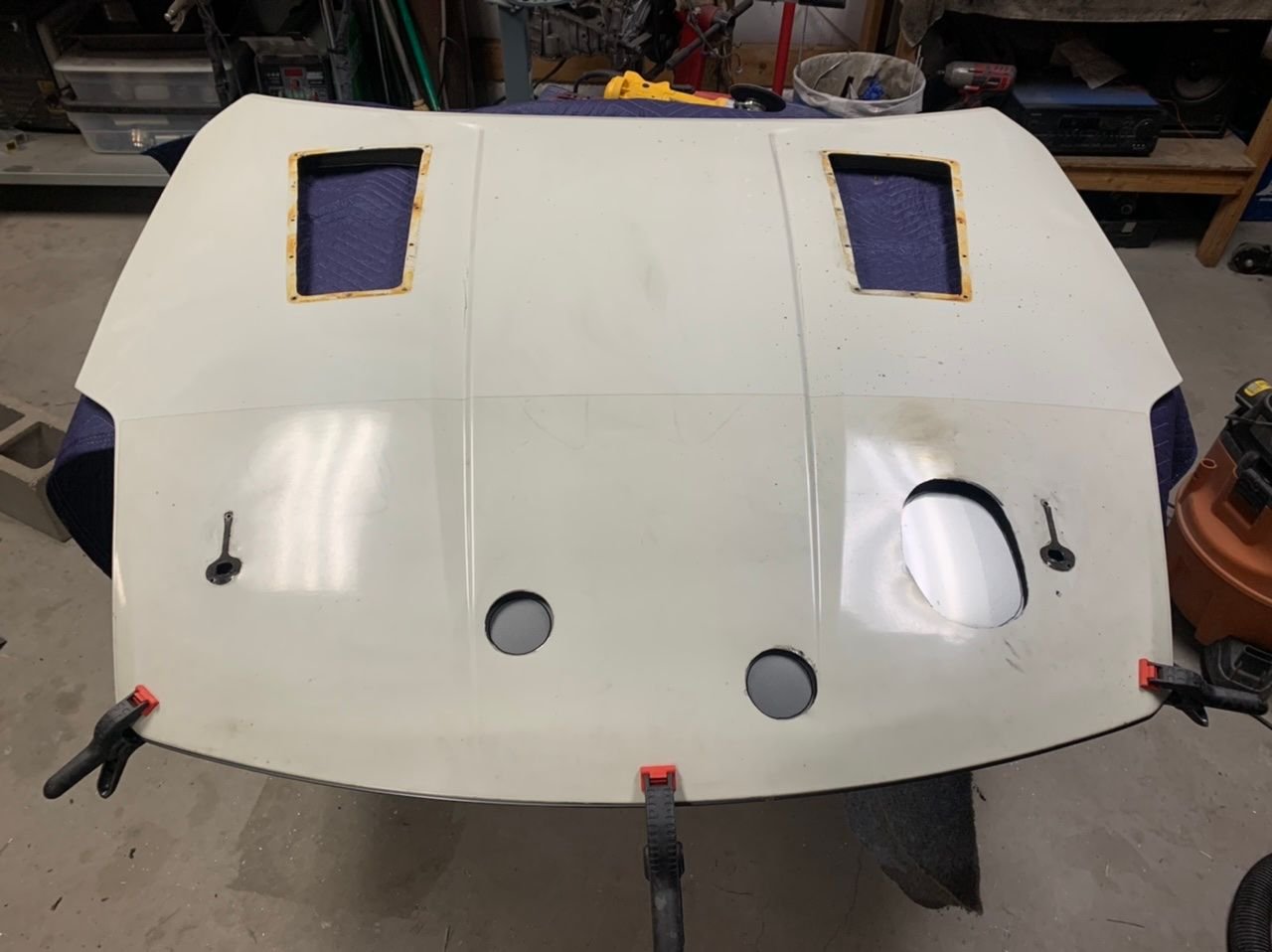

Was on a roll and had the energy to push forward with the hood. Drilled out the vents and started cutting out the frame-structure of the new (gray) hood. Cutting out the frame went surprisingly fast so I essentially did it all tonight ... I could flapper-disk some edges to soften them up if I want.
OEM hood came in around 23.5lbs and chopped it's 13.8. Vents are another 3.8bs range - so I'll be around 17.5lbs.

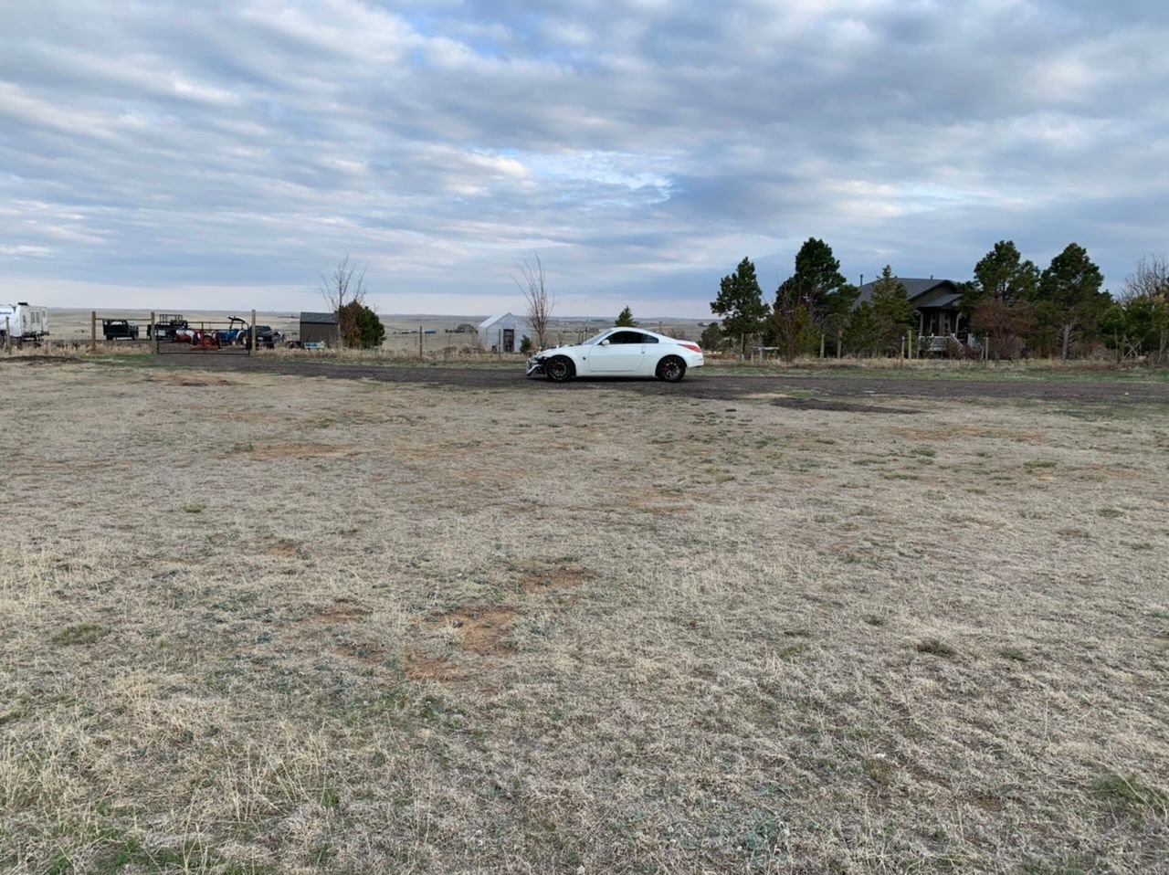

Heres the 5ft, 10ft, 20ft, 40ft, and 100ft shots of the color match of the hatch-wrap...
5ft
10ft
20ft
40ft
100ft

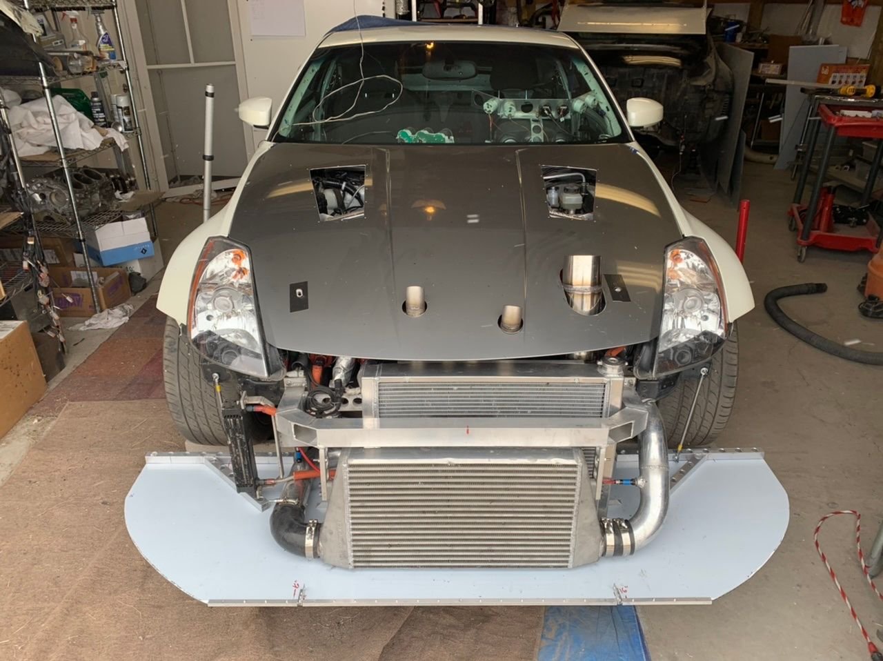

Had a few productive days on the car - got the hood wrapped up - cut the two vents out, the two waste gate dumps, and the hood exit exhaust...if it matter, the cut-outs are about 1lb and to be fair to my crazyness - so call the hood 13lbs...
I essentially gently placed my old hood over the new hood and traced the WG & exhaust cut-outs and they lined up pretty good. I tried to pay more attention to the exhaust cut out and make it cleaner than the previous attempt. I still need to enlarge it a little bit but its fine for now.
Hood vents are being cleaned up and I am considering painting them silver or grey rather than the 'rust' color they've become. I am using the same hood pin posts until I get another set of pins in and they'll be essentially mounted in the same spot.
also bought more rivets and put all the rivets in the lexan ... in hind-sight, I didnt peel the plastic wrap off before I locked it down ... I didnt thick much of it bc I'd just peel it after I was done ... the outside is fine and a tiny bit of plastic got stuck in the rivets but the inside-side is horrible ... So I think I'm gonna redo it.
Had a great Saturday morning - got the car out with the gf and it ran pretty good - made a few weird exhaust studdering notes when the car was cold / colder but ran well.
I put 15-20miles of varying throttle and boost levels did a bunch of ~5psi pulls, a few 10psi pulls and got up to around 15psi on accident - I didnt get off the gas quick enough and the boost comes on very fast after 10psi - it was freaky in a good way. It's confidence building that I can run the car this hard and everything is going good.
kicked the gf out to roll some video - nothing too crazy I tried to stay under 5k rpm and under 5psi of boost but here's some eye / ear candy ...

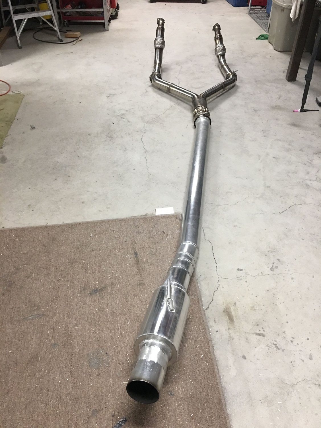

its not but 18” to 24” at most! What I really love about it (compared to a long lost 90lb Stillen test pipes/true dual/dual mufflers) is 85lbs of weight savings.
and call it 30lbs savings versus my aluminum single!!

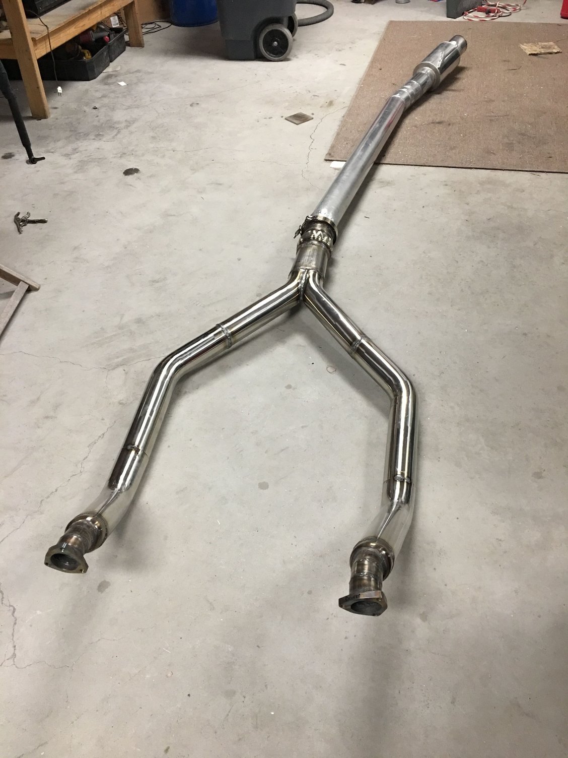

Oh man, look at all them weight savings!
I don't remember you aluminum was 100% custom test pipe back right?

Originally Posted by Conway_160
Oh man, look at all them weight savings! I don't remember you aluminum was 100% custom test pipe back right?
I need to go get weighed...especially with the CF hatch...still trying to get these CF doors from this dude down in colo springs.
It was the stillen test pipes (then my custom 3" downpipes) to a 2.5" > 3" unbranded Y-pipe (then replaced with my 3" >4" Y-pipe) then the aluminum exhaust.

gonna try go get the splitter bolted on today...
fast-forward a few hours...
Fast forward a few more hours and I've determined how to get my car under 1500 lbs ... I'll just do this... a guy needed the passenger side rear quarter and I told to just take the back half of the car. Really cool dude and it took him all of 20minute to have the car in half. Took more time to remove the subframe and gas tank.
