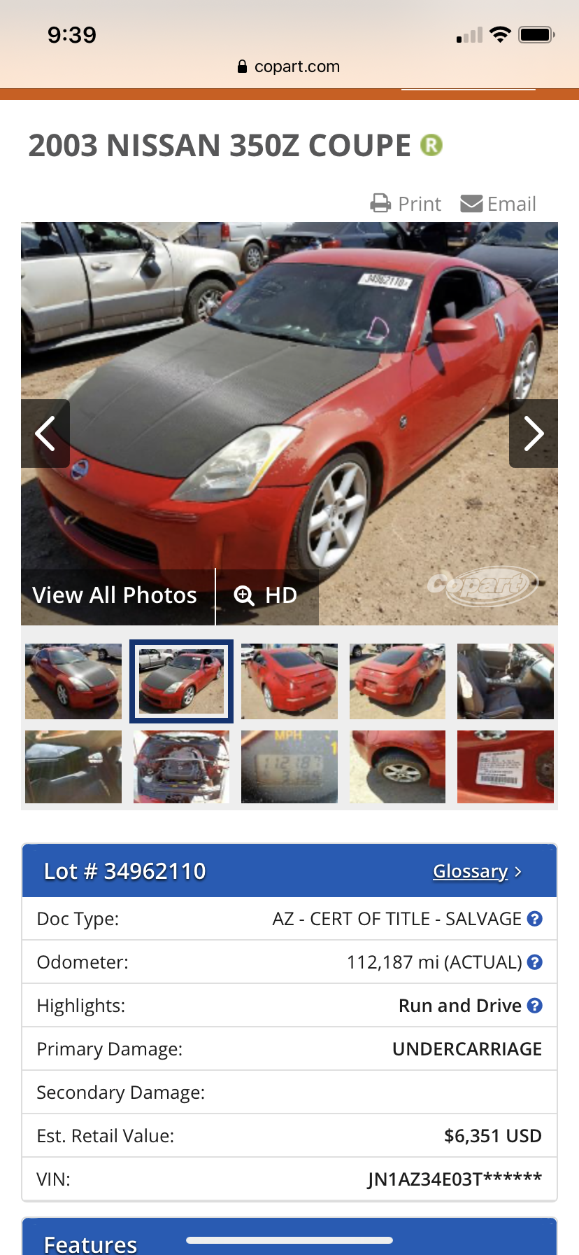

picking up my 4th z
Saw this on copart and have been spying it last few weeks. I made a healthy amount of cash off the black parts car and I think have the parts remaining to swap in a new subframe and new suspension on the red one (off the black car). Details say it starts, runs, drives and the only damage is undercarriage and it's a salvaged title so lets see how this plays out if the frame is bent I’ll part everything out … might start a new thread.

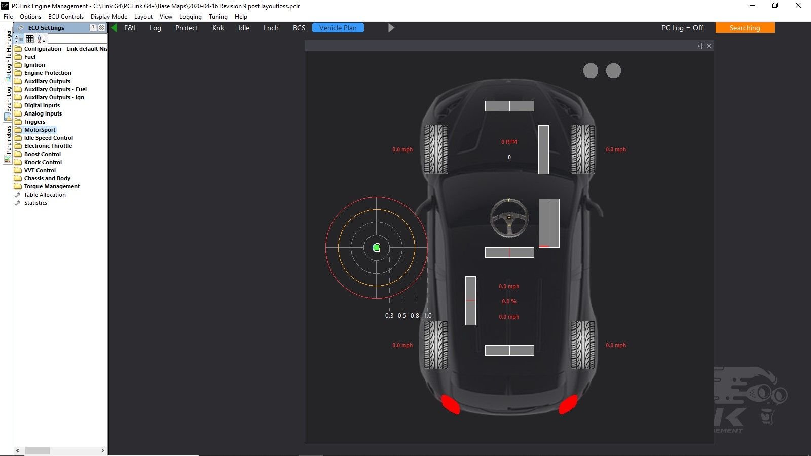

Also came across this little gem in the link software ... it's called 'vehicle plan' I assume all the fields will be updated in live-time as you drive the car. Other than a pretty picture I dont know if it serves anything other than an overview - not much is programable (other than off or on).

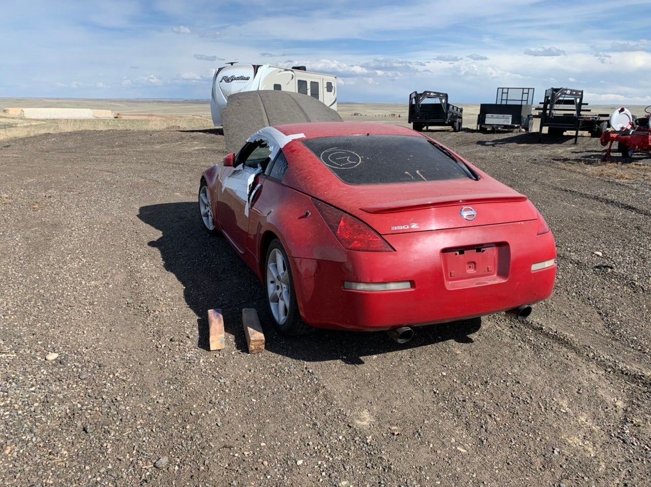

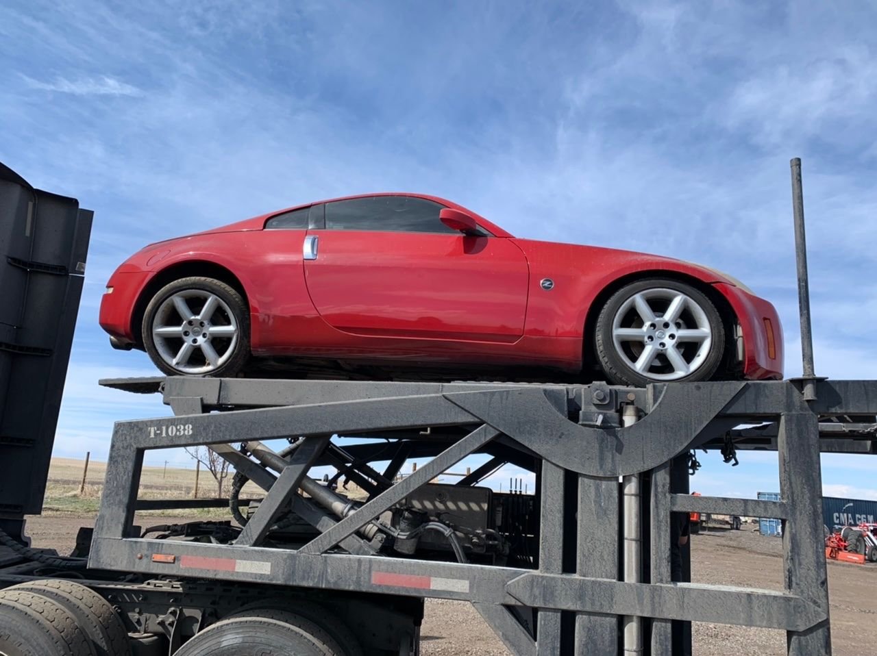

Today is Sunday ... and an overall productive day. Around 12noon the transport driver called to let me know the red nissan will be delivered later in the afternoon. It took some finagling but we got the car off the transport. I attempted to start the car and the battery was dead. Had to do small business stuff and had to leave but when I got back I re-attempted and jumped the battery with my pickup to no-avail. Went back to basics and maybe Copart drained the fuel? So I put 5gallons of fuel in the tank. Removed the glove box trays and I can hear the fuel pump prime so I can only assume I'm getting fuel pressure. I also sprayed the air filter and inside the plenum with starter fluid and nothing. I'll see about swapping crank-shaft and cam-shaft position sensors in to see if this is the issue. After that I will check spark but I can't imagine all the plugs are bad.

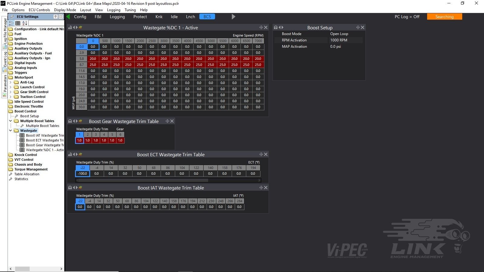

Spent early saturday evening enabling the Link's boost control and setting-up a few basic tables (will run open-loop control for simplicity) and because my waste gates are sorta backwards (compared to Tial's) I will be running the boost controller off the top chamber. Which makes more sense to me but is backwards from how most are setup. I also like this because I can remove the vacuum line off the bottom chamber.

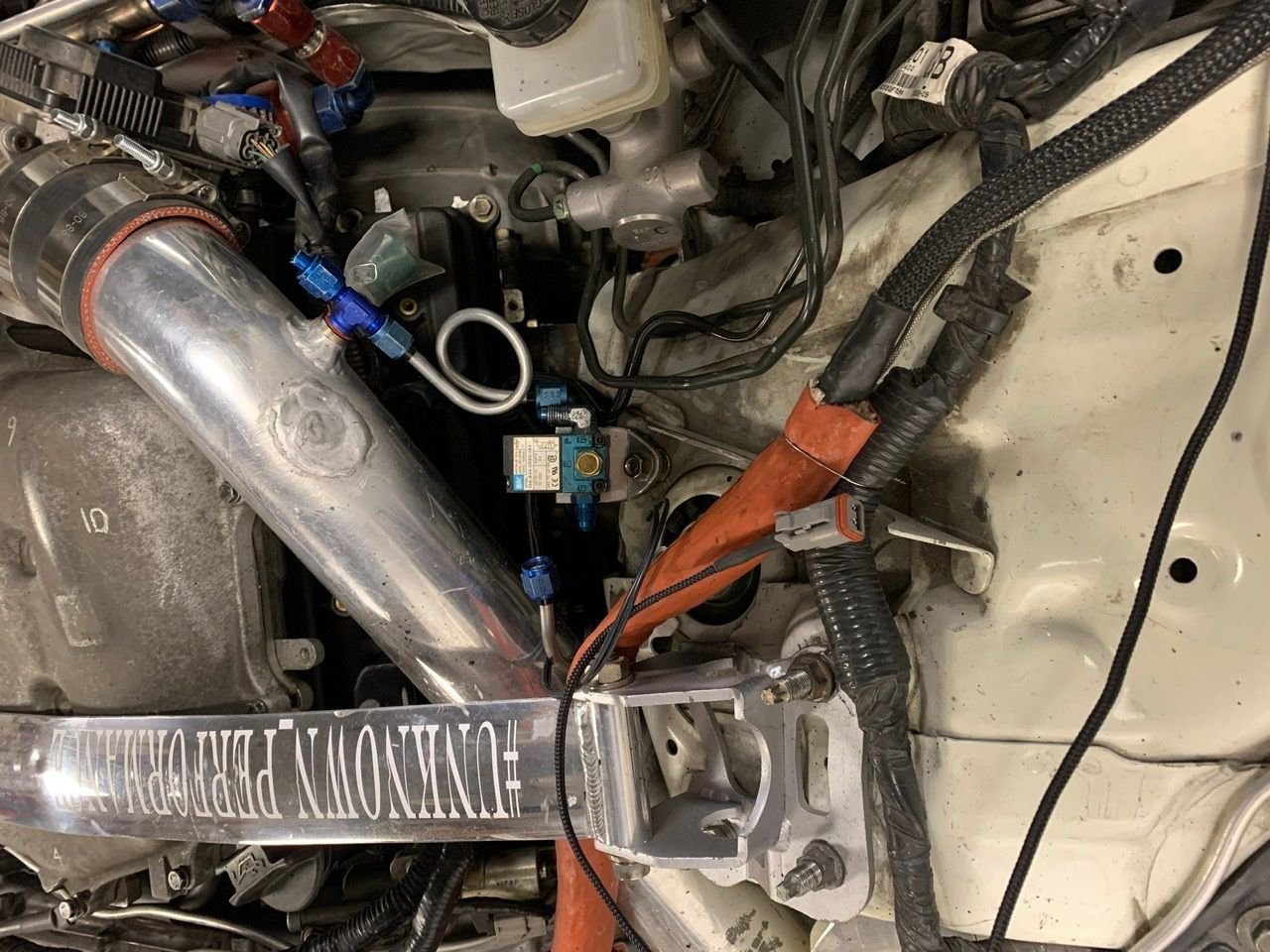

Needed to reposition the boost control solenoid to the driver side and work off the boost reference fitting right before my TB. For what it's worth I dont have 1/8" NPT / AN -4 fittings and they arent readily available so I trimmed the AN -4 fittings down and straight epoxied them into the BCS. Sorta jenk but I dont really care.

For the red car- did you check to make sure you had spark at your spark plugs? For the life of me I can't remember what NATS disables, Fuel or Spark. Fuel seems like the most logical because you don't want fuel to just chill in the cylinders.
You know how they say start simple...yea, I didnt... I added 10gallons of fuel, checked fuses, checked relays, charged the battery. My landlord (master diesel mechanic) brought his fancy snapon scanner (the one that can launch a space ship) and picked a few codes (one of which was P0340 - pass side cam position sensor). Nothing crazy...then he flipped it to take data while I cranked ... and for some reason the scanner powered off as I cranked. His infinite wisdom took him to the battery. And it was connected but was not tight...We tightened the battery connection and the car started. The engine sounds good and I'm pretty excited for the car. I love throwing it revs. I havent had an NA DE in 12years or so ... so the VQ's rubble is welcome!! The subframe doesnt look damaged - more the camber and toe arms.
