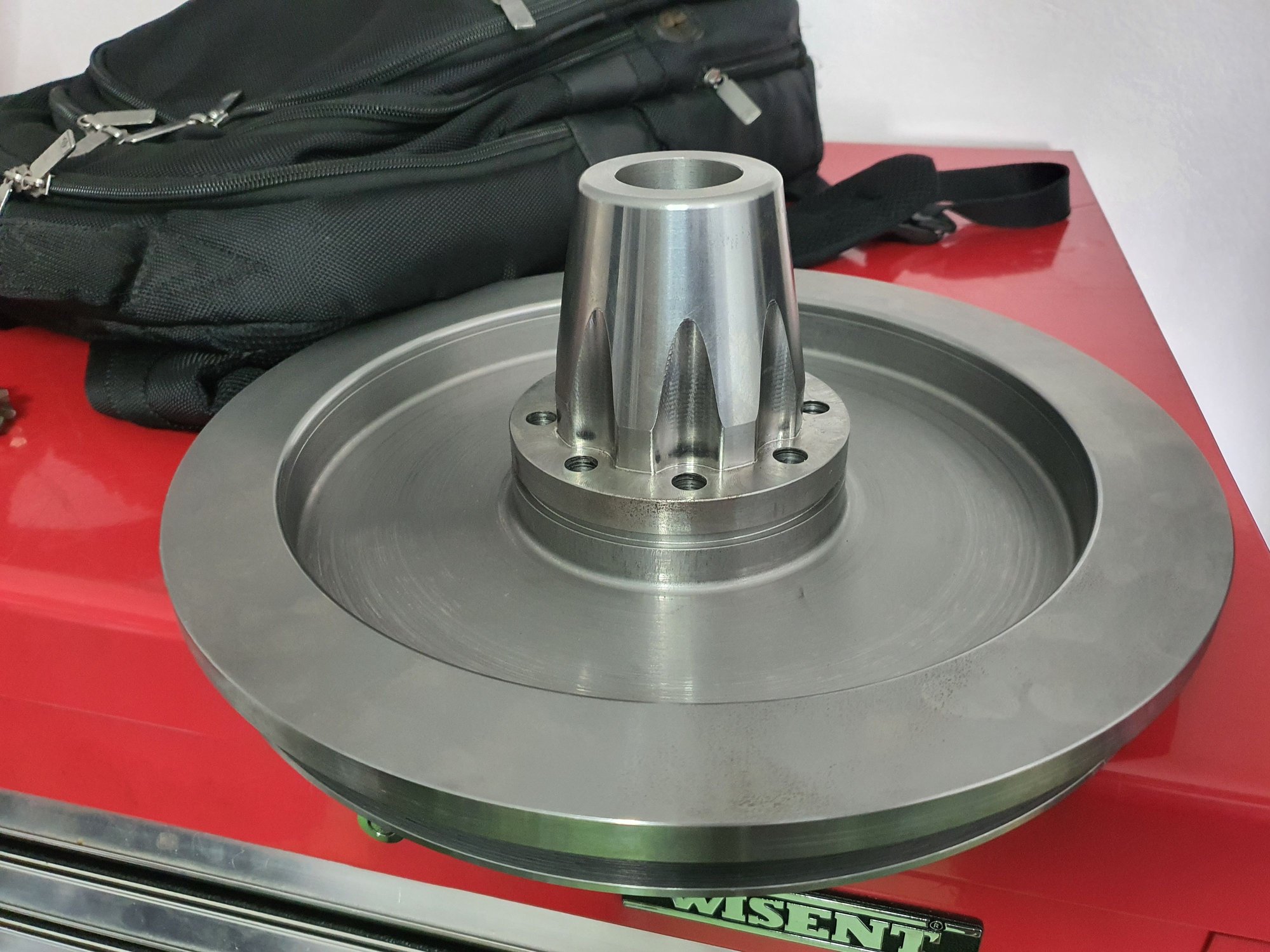

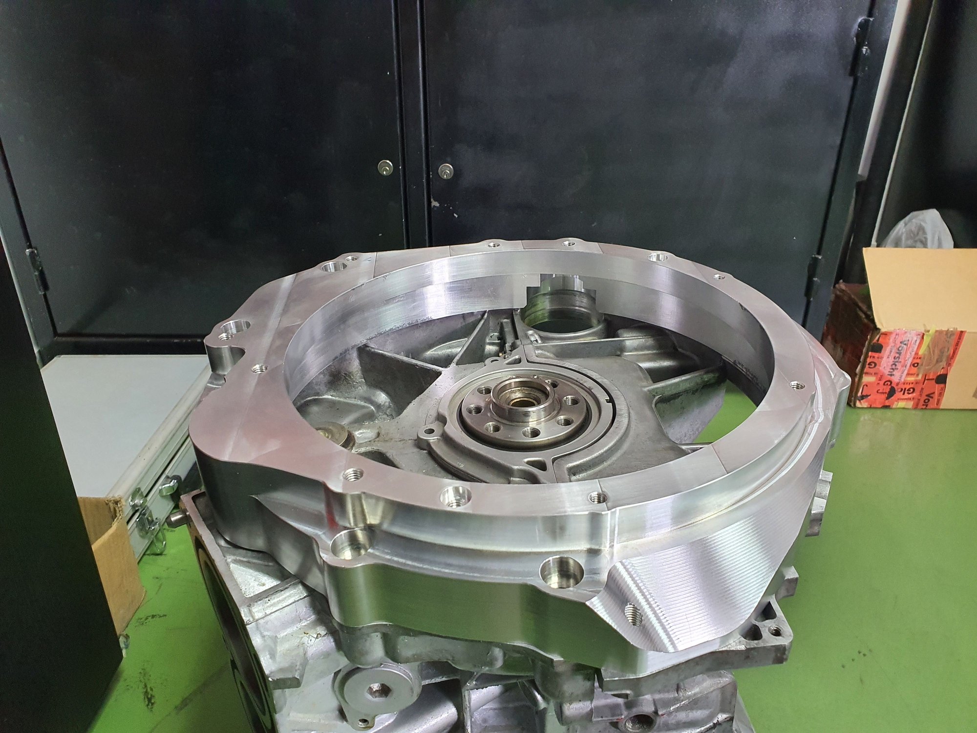

Doing gearbox conversion to a BMW M4 DCT/DKG, 7 speed dual clutch.

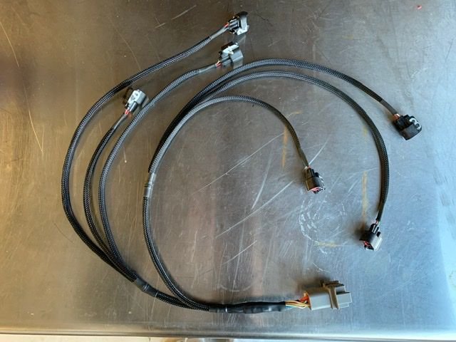

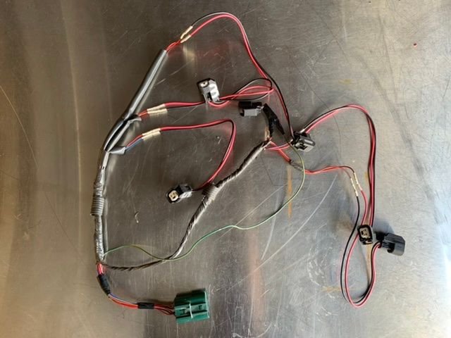

Monday afternoon and evening a buddy and I were doing the pre-dyno stuff and we noticed cylinder #4 spark plug looked essentially new - like wtf new...so we did some diagnostics with the Link and the coil and plug were fine but the injector was not firing. With stress levels through the roof we traced the wire back through the subharness and into the main harness and determined it was the connection between the EV1 injector connector and the spliced connection between the OEM wire and the connector pigtail. so I re-do this connection and the injector starts working. Everything is working. Deep breaths and head off to bed.
Wake up and do a final round of checks before heading out and everything is going well. The car runs rich until it gets warmed up and otherwise drives fine. I get the car over to the shop and they've been crazy busy with prep'ing for an event in Minnesota and they had three cars scheduled for the day so I just dropped it off. They didn't like how I had my waste gates plumbed (and I don't blame them, I have them plumbed sorta backwards) and they wanted them plumbed in the more traditional / industry standard way (which I get) and I happily did. I also had a loose fitting on my boost control solenoid so I bought a new solenoid and new fittings and got it plumbed in and back over to the shop. The owner inspects and gives me the blessing and we aim to tune on Wednesday.
Wednesday comes and goes and I dont hear anything from them and I told them not to stress about my car and get ready for the event - no big deal.
Thursday late morning I get a call saying that cylinder #4 isnt firing, not a coil or spark plug but not firing. I do a quick explanation that it's likely the subharness as that's what I just had issues with Monday night and I'd figure it out. I stopped by the shop to sort out the harness and (again) used the link to test fire the coils/spark plugs and injectors and nothing from cylinder #4 injector. Swap cylinder #2's plug on injector #4 and it fires...so big picture I gotta rebuild the injectors subharness. So the shop has EV6 injector connectors and spec wire and the owner throws me an deal on everything and I'll rebuild the subharness by next week. In the meantime, I need to get the car home and I know cylinder #4 wiring is funky so I bypass the OEM wire and re-route the injector's low-side wire (that connects to the ECU) and everything is working. I get the car home and call it a night.
I'll rebuild the subharness over the next few days and put some test miles on it.

Before (I spliced the green wire in to get the car home on all 6 cylinders):
After:
