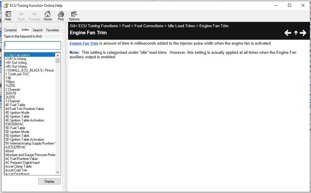

Got the car out for about a 15mile cruise and the car ran well. I activated open loop boost control and put some very conservative numbers for the duty cycles - resulted in about 4psi of boost.
Appreciate the insight and responses gents - Grey brings up some very good points. I've got data logs and I can check the aforementioned point and if for some reason I didn't capture that data I can go back and replicate the problem. I'll update once I've got a free minute!
Originally Posted by GreyZ
How will adding fuel to the map when the fan switches on help? The engine is not dying from leaning out but rather it cannot make enough torque at idle to spin the alternator with the increased load. The alternative that sounds more likely is that there is a wiring issue, control issue in link, too high of current draw, or possibly a poor fuel injector mapping/latency tables that are no longer accurate when the voltage drops and causing a lean or rich condition.
Can you see the throttle body open when the fan kicks on to attempt to maintain the target idle rpm? Can you log the change in ms open time of the injectors and see the change as the voltage drop occurs with the fan? Are the fans pulling the right amperage on startup? Are your battery terminals tight? These are just some thoughts that come up.
Yea, you're right adding fuel is the wrong move. The engine is going rich when it dies and I have a lot of black smoke when it dies.
I'm not sure how to justify if it is or is not making enough torque at idle. I don't want to completely dismiss this but the only think running off the crank is the alternator, no AC, no PS although I am overdriving the alternator.
Wiring issue - I don't know / anything is possible as I have modified many of the OEM wire harnesses - including the harness that runs the the fans.
Control issue in the link - anything is possible(and in the end, this was the issue)
Too high of a current draw - not likely as I am running a single 10" spal fan
Injector latency vs. voltage issue - could be? but inconsistent when ECU temps are under the fan threshold
I pulled up the TP in the data logs - looks like it's functioning correctly
injector times appear correct
battery terminals are tight
Originally Posted by rustyschopshop
Some of what grey stated is what i am wondering. If you are losing voltage and richen the maps, it will just run worse. Alternator should not take much torque to spin over so don't feel this to be an issue unless the alternator is going bad. With all the wiring you have done, would consider checking all connections especially grounds.
I don't know that I was losing voltage other than the car running at 14.4volts and dropping down to 12+volts when it died.
Yea, alt wont take much to spin and I'm overdriving it a bit. This hasn't been an issue before
Originally Posted by Conway_160
What i would do is look at your injector delay and spark dwell when the fans kick on. That should show you where your battery voltage is actually dropping to. If it drops below 14V then you more than likely have a charging issue and the car can't quite compensate the fuel/spark correctly.
I wasn't dropping below 14volts until the car died and the latencies were good.
The yellow vertical line is where the engine dies
solution as Grey mentioned was in the link. And I don't know why I didn't see this. I was misinterpreting the fan step function … this function is a percentage of engine speed added to the idle(not to fuel)T Meaning a 10% step would add 125rpms (assuming idle is set to 1250) and the car would idle at 1375 while the fans were on.
the solution was right in front of my face (and I'm embarrassed that I didn't see this) but I was adding 2ms of fuel in my Idle Gain Trim table any time the fan is active. Which makes sense why my AFRs were going rich when the car died-out. I'm not 100% sure why the engine would die when it dropped down to 11:1 AFR at idle but I guess that's enough to drown-out the engine. I zero'd this out and the car idles fine and runs fine when the fans kick on and while they run. I didn't add any RPM gain nor any fuel gain and it idles as if the fan were off.
Far right side, half way down 'Idle Load Trim' table, Eng Fan trim = 2ms

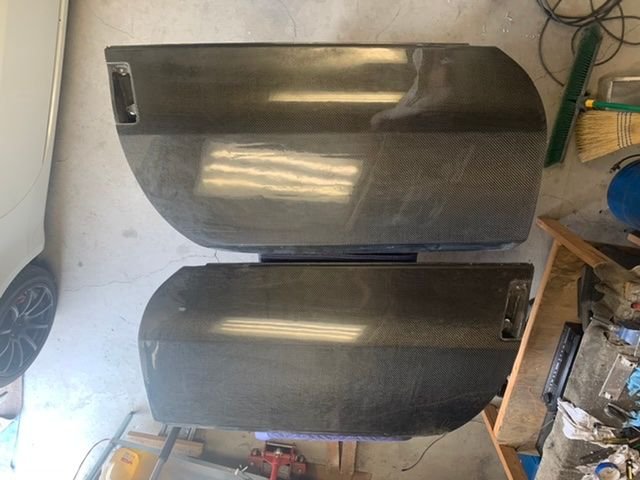

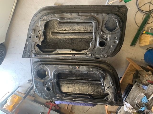

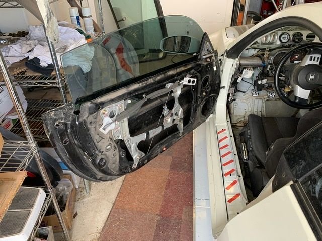

It's been a slow week - but have had time to clean a few things up and really wrap up the black parts car...sold more parts off of it and was able to crack a deal with a guy down in Colorado Springs with the carbon fiber(fiberglass) doors. Essentially gave him cash (which I gathered from selling items off the black z), two black doors (not from my parts car), hauled everything down and did the swap (with his help).
If it's something I really like about the car community, it's the chance to meet other like minded individuals. I've been going back and forth with this guy and some good conversations and I was happy to meet him in-person and get to hang out while 'wenching' on a Z. Overall a great way to spend a friday afternoon/evening.

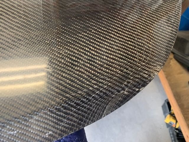

Overall I'm pleased but I'm not satisfied...Ive been spoiled by the dry CF hatch ... and these doors are pretty kick ***, they'll shave 50lbs off the car (which I wont daily drive w/the CFs) but it'll be pretty sweet for track events. I was told that they are seibons but I dont see the seibons tags...so I am not sure - but I'm not gonna let that stop me.
They are in decent condition with the clear in pretty good shape but some damage on the drivers side bottom rear corner. It's not gonna ruin my weekend bc I will likely wrap them at some point in time.

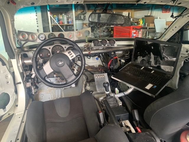

Also fab'd up a quick laptop stand. I had one before that mounted to the bolt that secures the seat but I wasnt entirely happy with how it worked... so I scraped it (awhile back) and told myself I'd fab another one at some point in time. This new one bolts to the four bolts holding the shifter boot - feels pretty secure and I'm happy how it turned out.

It is wildly handy to make changes, monitor the car, data log, check parameters, etc. With the standalone, I can upload any changes in real time and while driving.

Glad it was something easy (but elusive) for the idle issues. That is so much easier than actual electrical gremlins overloading the alternator. If I remember correctly I idle around 2ms on my 750cc injectors. So if you were adding 2ms on your injectors it was probably more than doubling your idle fuel. AFR sensors get a bit error prone at the ends of their range, it could have just been at that edge or if it was so rich that the fuel was still liquid in the exhaust it will not pick that up.
Those doors are also sweet. Do you ever plan to go full cage? By the looks of those doors if you had a cage you could get them to half their weight if you only needed the skin.
Right! Me too … I hate chasing those 'it could be...' issues. Yea, It was set to 2ms for my 1000cc injectors. Which I don't completely understand because I never changed that - I'm not sure but the car is running well. The O2 sensors are new as of 6months ago and I have maybe 300 miles on them.
I will likely go full cage at some point - it'll be on of those big purchases you make once a year. I wouldn't do it myself, there's a good shop west of Denver that sells a pre-fab'd cage and would do the install too.

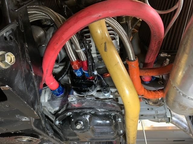

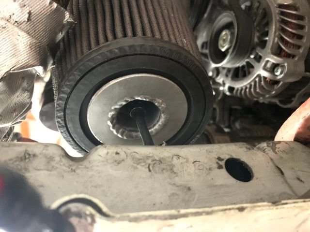

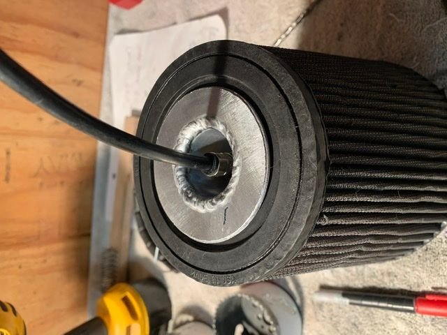

so I have this oil leak from the turbo...I am dripping about 3 to 4 ounces of oil everytime I take the car out ... I now notice this oil leak on the previously installed splitter / under-engine shield maybe a month ago. I have a 40psi restrictor on the feed line, so the return line sees 5psi to 40psi ... Also, I have about 1" to 2" drop from the turbo to the drain (plus or minus) so, yes, it drains down a 2" over approximately 24" of line but by no means is it a optimal slope.
So I pop the car up on blocks, remove the splitter/shield and start at the turbo. There is no oil leakage at the -4 oil feedline ... no residue/burn-off. The -12 flange attached to the turbo has two hex-bolts and they are plenty tight, the -12 fitting is plenty snug. I move to the fitting attached to the oil pan and surer than **** the return line, attached to the block, is finger tight ... wtf?!?!?! This oil leak started just a few weeks back so I wonder if this has just wiggled loose. I dont know...
Moving forward ... I'm gonna rebuild this line with rubber hose and push-style fittings to ensure this was indeed the issue. If this fixes the problem I will order new hose and change up fittings (as advised by a knowledgable buddy).
I'm highly considering a 'greddy' style expanded oil pan - I'd love to drop $320 on a authentic greddy (and if I have the cash, I will) but I can get a generic for $120 to $170. From there I can drop the scavenge line to this pan and it'll clean things up.

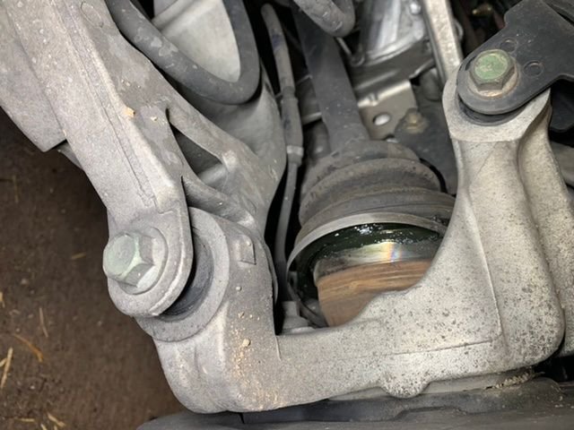

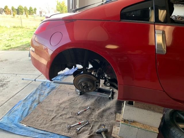

I got the suspension replaced. I put on new toe and camber arms on and it needed a new springs bucket. I believe everything else is good. I replaced the two blown airbags and the airbag control module and it turned the airbag off. I dropped a new camshaft position sensor in the passenger side and it cured the P0340 CEL. I also put a fresh jug of oil and a new filter on the car.
So I took the car out this weekend and it ran well. I'll definitely need an alignment but, damn, it was fun to drive an NA VQDE. I took a few minutes to knockout some doughnuts and let the VQ sing... it was fun - put a smile on my face.
Over the next few weeks I'll drop fresh plugs, flush power steering, flush coolant, and bleed brakes ...

For sure! All I could think was the hose fitting was tight on both turbo/block fittings and that the hose was a hard pull from coming loose.
It's good, fathers wont be around forever so soak up the time when they are.
I picked up a 24" stick of rubber hose and put two new push-lock fittings and some wire-tie on it. (not that worried - it doesn't see pressure) and reinstalled. It was a botch reinstalling as the hose hits the front subframe and doesn't let the two fittings screw into each other flat. I finally got it and locked it down. I took a few cans of brake cleaner to engine/turbo/lines to clean them up and check for new leaks.
I put two sheets of fresh paper down to verify nothing was leaking. I started the car and let it run for 30 seconds with some easy throttle blips and no oil was visibly pissing out.
Cut to the next day, I worked with my old man to do a few things on his car and we wrapped up around 10pm. I went to start the car to put some idle time on it and the car would crank but not start...I didn't have the mental capacity to trouble shoot the car so I just put the battery tender back on it and went in for the night.
Next day, went to try it again, cranked but didn't start. Made my mental checklist and obviously it cranks, but the fuel pump is not priming on key-on. I pull the two fuses and theyre fine, I unplug and replug in the relay and it primed - fixed...nothing can be easy!
I started the car and ran it for a few minutes, and no oil leaks. Need to wrap up my dads car and get it out of the garage and then I can take the white car out.
I do have a good amount of confidence with the car right now and I'm looking forward to getting it out and pushing boost a little harder. I'd like to get the boost control settings figured out and then if everything goes well bring in water/methanol.
I did test the original hose used (that was leaking) and it's solid. I put 120psi from my air compressor on it and submerged it in water and the only leaks were coming from my connecting fittings.
I'm still contemplating the expanded oil pan and Mazworks has a pretty neat oil baffle insert that I think I'm going to copy and fabricate for my own engine. The baffles are a plus but I eliminated my OEM windage tray (as I am running the dynosy girdle) and I would like to put something in to eliminate the windage oil froth potential. To be continued...

12midnight update ... got the car up in the air and return line off the car ... (albeit no splashshield / undertray) I love the fact that I can get to the turbo within minutes ... the greddy kit would have been days to reseal a connection ...
I forgot that I trimmed this flange - probably why it's leaking ... it was too close to the CHRA so I had to shave some material. If this doesnt work I'll probably buy another one and trim less.
cleaned everything and applied high-temp gasket maker ...we'll see how well this holds ... spec says 700degree temp rating. Can't torque this down for another hour...

had an impromptu run of the car this afternoon - worked / assisted a buddy (with the blue rear-mount turbo kit) doing a test-pipe removal / weld some extra o2 sensor bungs in / reinstall, also did a clone-job of the MRev cut and the removal of the 6 'towers' inside the OEM upper plenum lid.
He did all the hard work ... I did the cutting and welding and he busted his *** under the car ... I feel bad for him ... but we fixed an exhaust leak and likely a vacuum leak.
Things were wrapped up around 7pm and we were both pretty hungry so we got both cars out and grab food.

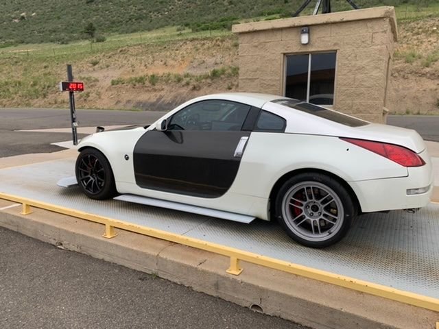

Had the car out at Bandimere this evening ... Saturday night roll racing, I'm sure it's bc, as colorado loosens covid restrictions, Bandimere opened-up for test & tune style roll racing - I bet they didnt have any big-time weekend event.
Figured this would be a great time to get the carbon fiber doors on the car and give myself a realistic weight update and they have a nice scale there.
with about 1/2 a tank of gas, bigger rear wheels, and only essentials (computer, fire extinguisher, single driver's seat, full tank of water/methanol, etc) the car came in at 2815lbs ... I can get another 10lbs off by putting the false headlights and tail lights. Something I should put on the radar is a cf seat / harness bar setup.
I had 1/2 tank of fuel and I bought another 5gallons of 104oct as insurance
