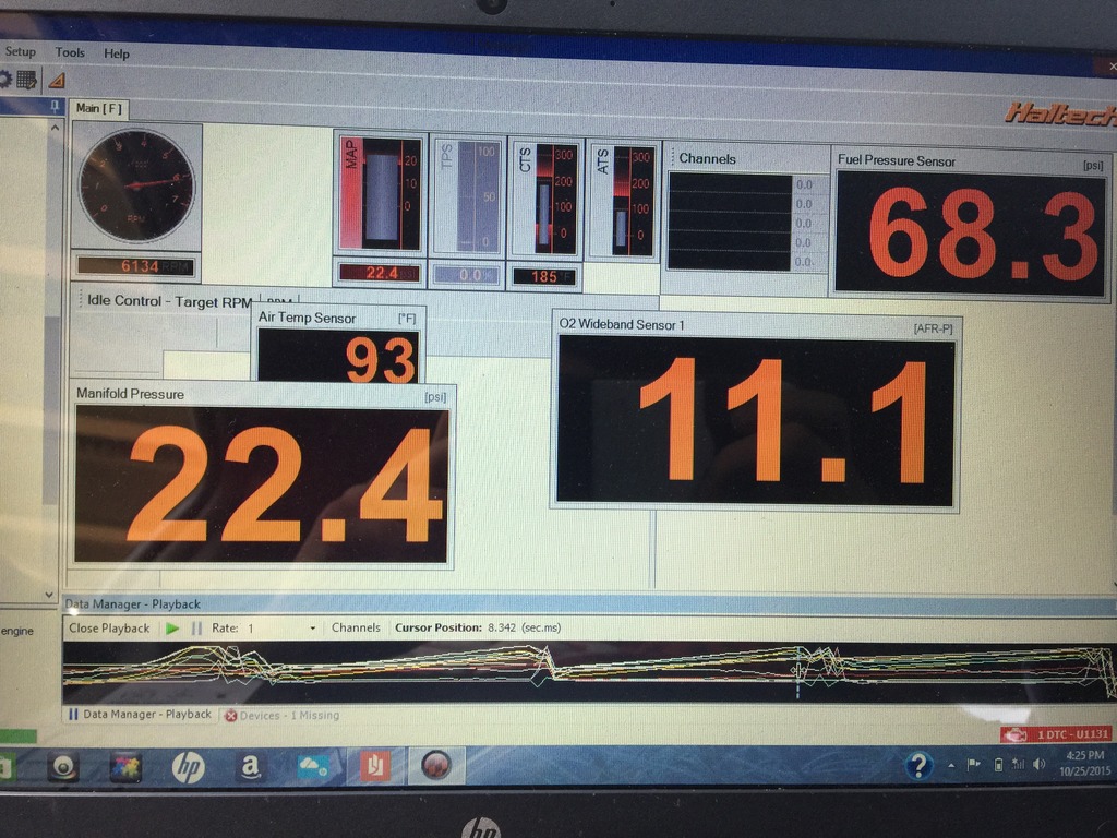

Been doing some testing with added idler pulley. I'm seeing 22.xx psi around 6300 now. I'm maxing my map sensor and car looses throttle. Hal thinks it's prolly a safety for over boost. Car is running great. It's seing 11.1 afr up top. With the smaller ti blower at 6400 at 17psu it made 580hp. Curious to see what this ysi is gonna do. Gonna spin it up to 7500 if it's still make good power and boost.

Won't see dyno till after Christmas. I was just trying to work out any kinks in the setup and make sure my belt wasn't going to slip so much.

What do you need 4 bar map sensor? This is looking very promissing for ya!
I thought you had an external pressure sensor from the TI setup?
No still using the internal. That's one thing I don't understand right now. On the ti I was maxing it out, but still able to go higher according to my boost gauge. Before the crank pulley change, I was able to rev out to 7200rpms making 21psi. After the crank pulley change, I hit 22.xx and it stops pulling. Doesn't hesitate, buck, or cut out. It's like I just let off the throttle. Also no codes.
If I do a pull in 1st or 2nd, I get belt slip and won't make 22psi till around 7200. No issues. I might put my 3.12 pulley on and see if I can pull it to redline.
Yeah I'm hoping for great things with this blower.

get the external map sensor
boost, ait and cfm can all vary. Especially with your new piping and blower.
Yeah the setup has changed drastically.
Id venture to guess that you werent actually going past maybe 23 24 psi with the last one. Whats your boost guage model?
