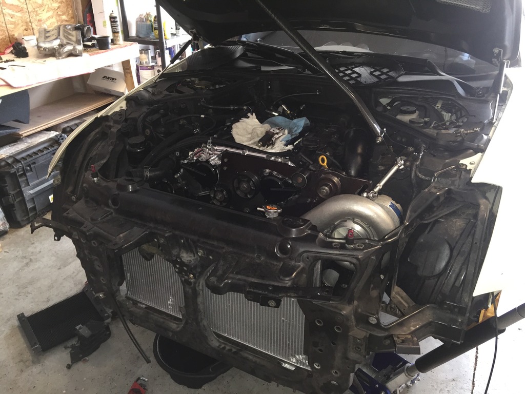

How she sits for now..

Looks like lots of fun.

Sweet man! Looks awesome! Look's like a pretty easy fit too.

Yeah this went in prett simple. It was a lot easier since I have the front end off. I'm mocking up some 3" piping off the blower now with a coupler and its clearing. Well it's right up against a couple things, but it's gonna work out great!

If you have already then no worries. But the Area under the SC'er near the flange on the Frame should be ground or trimmed back. I'd say you want a min of 3/4" clearance here.
Even though you have soild mounts, stuff still moves....

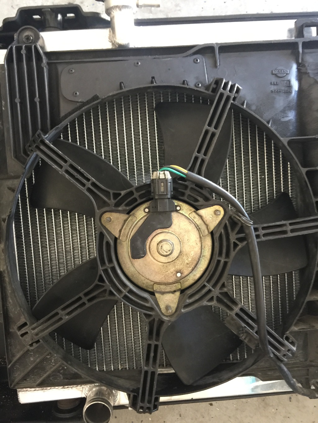

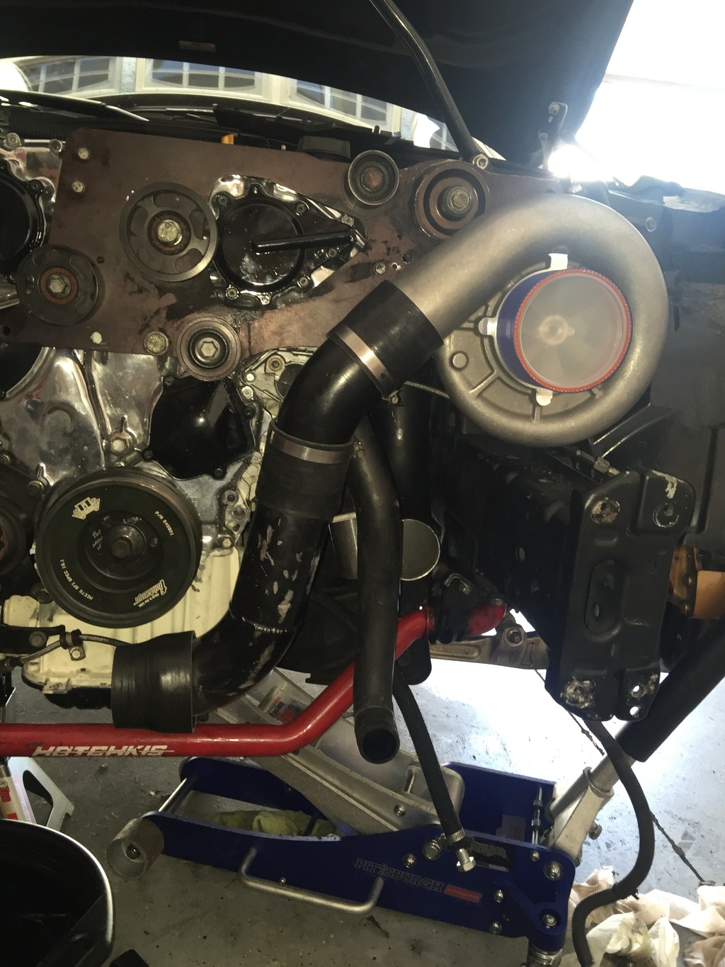

Been working with mocking up piping coming off the blower. It's a tight fit but it's doable. I'm using extra piping that I have to mock everything up before I buy piping and weld it.
Couple issues I was having, the piping coming out th blower was hitting fan shrouds and was hitting the electrical plug causing piping to bind a little bit. I found I was able to move the fan Motor around if i grinder a notch for the connection for the fans. Grinding down plastic is super easy lol. Had to grind/cut out some more to fit. This is the only spot I've been having issues with. But i have it on now and it's not hitting. It's tight, but not hitting.

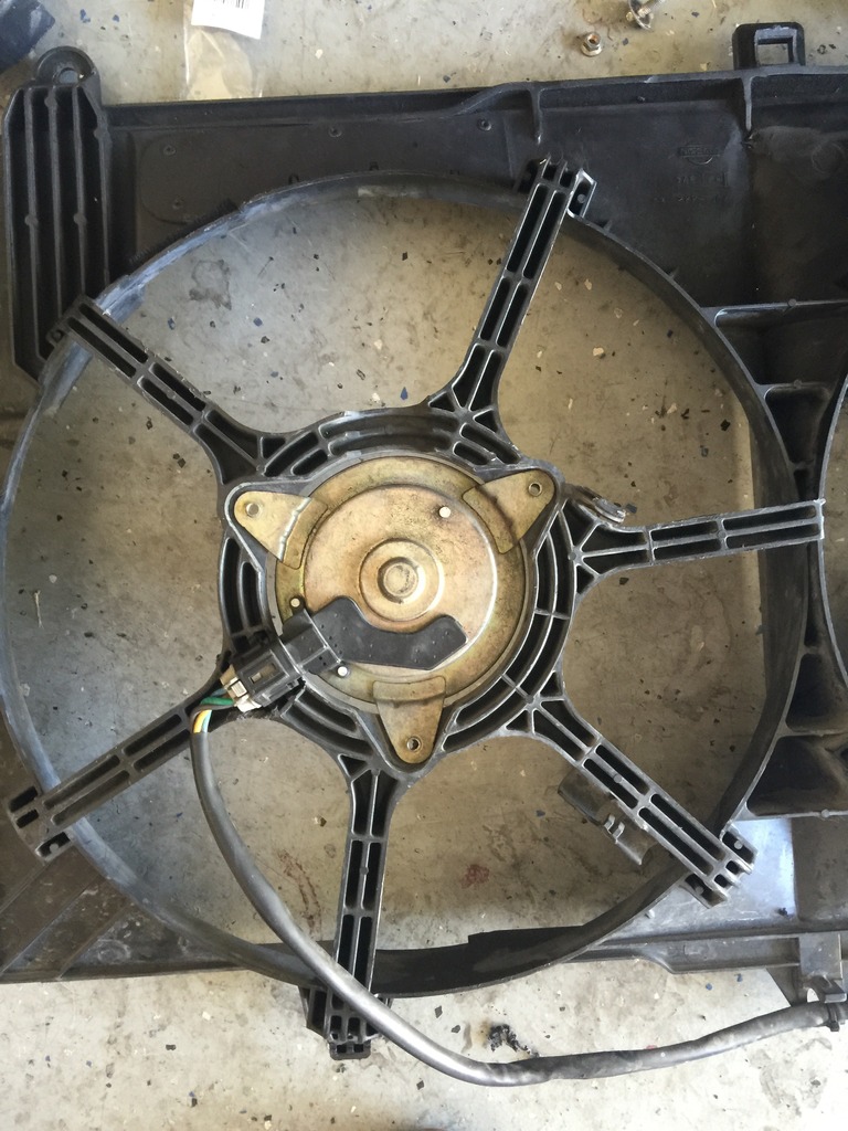

This was how it was

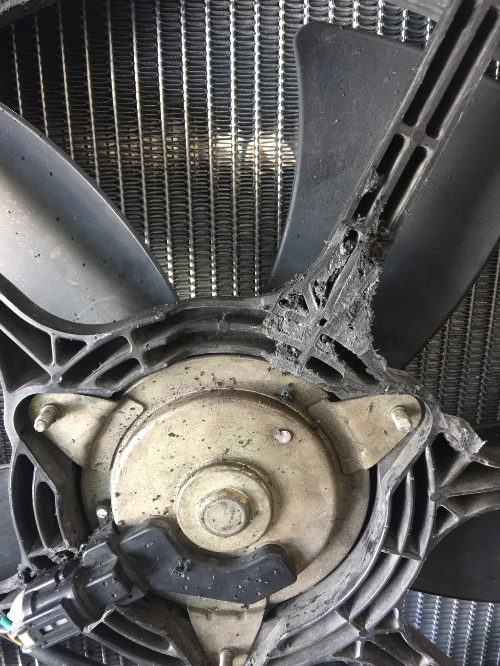

And this is how it is now. Just had to notch the plastic with a grinder to fit the connector. Hooked my drill to the fan and spun it just to make sure it didn't rub. All good

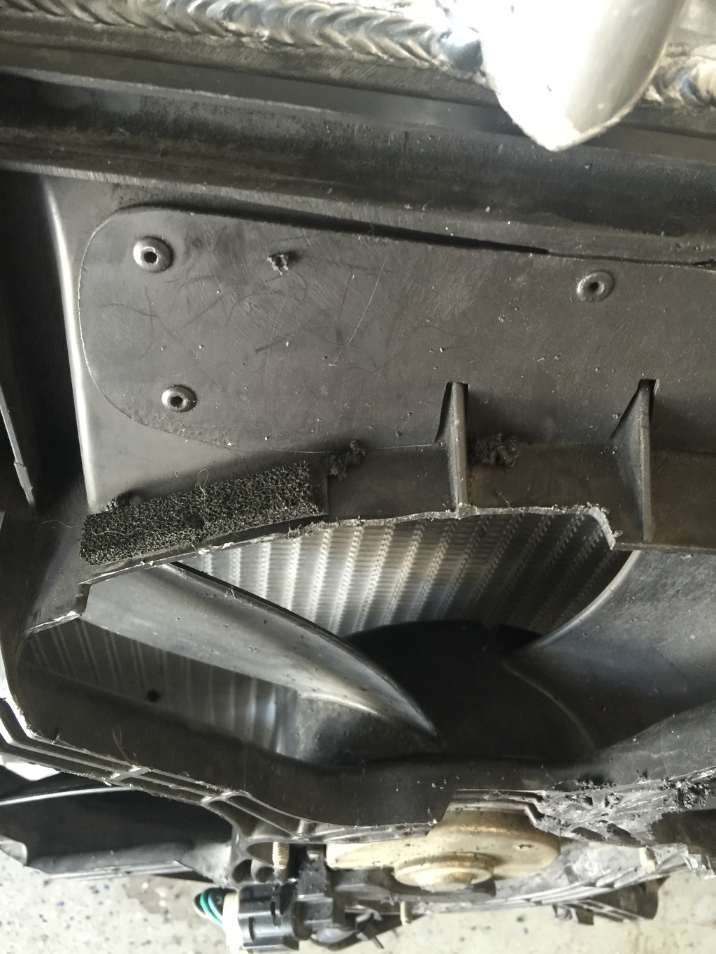

Had to grind this down a little bit
And notch this.

did you confirm with vortech the rotating direction of the gearbox to work on a 350z? Might want to hand spin it to make sure.

Yes, I talked to them and they said everything would be good. Just wasn't sure on fitment inside the car. I can spin it by hand in the correct direction and it blows out. When spun by hand, the gears are pretty noisy. I'm guessing it's normal. I'm calling vortech tomorrow to ask about a couple things.

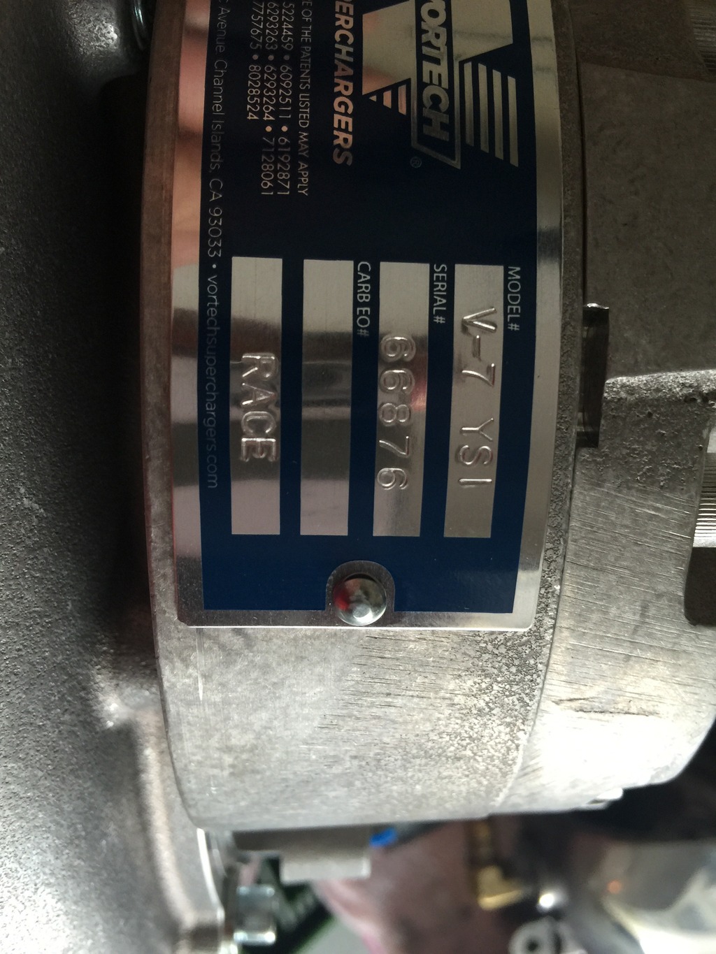

Old Sep 13, 2015 | 02:09 PM
  #814
meanz's Avatar
meanz
Joined: Jan 2010
Posts: 2,197
Likes: 57
From: greenville, sc
Who said it wasn't ysi??
Old Sep 13, 2015 | 02:24 PM
  #815
HRMoneyPit's Avatar
HRMoneyPit
Joined: Jul 2015
Posts: 2,433
Likes: 268
Oh, thing is huge. What PSI are you looking at now?

It's CCW. You can tell by looking at the Volute.
Attached Thumbnails Another built motor Vortech dreamer thread.-screen-shot-2015-09-13-at-9.42.16-pm.png

There is an input shaft...some gears and then finally the impeller spins. The input shaft needs to spin the right direction to spin the impeller the right direction..not sure how many gears in between the input shaft and impeller.

Josh, Looking Good!
Just Make Sure! The Volute can Never hit or touch any other part of the car!
It can cause Vibration between the Volute and Impeller, and that's not's good.
Their is only about .006" Clearance between the Volute and the Impeller.
