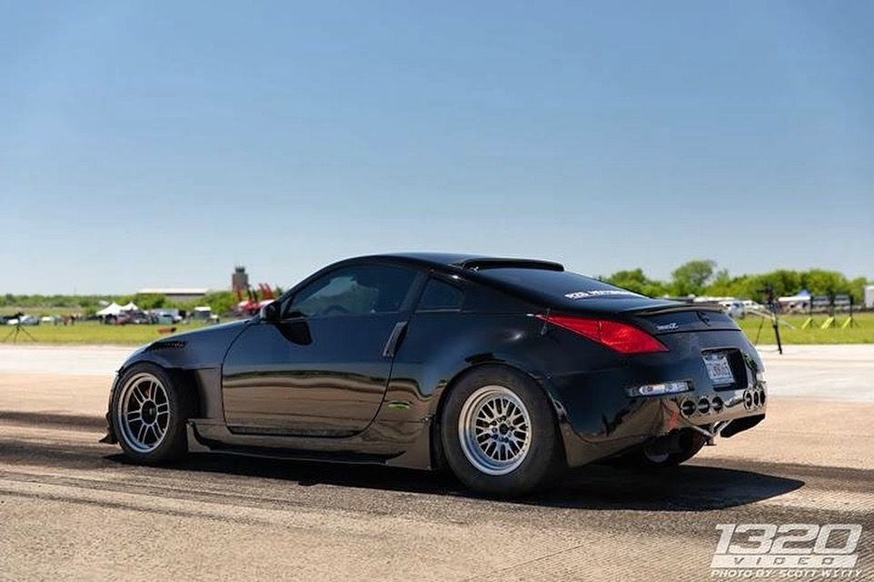

Been a while since I updated this, the car is still running strong. A few changes have been made to the tune (increased timing about 2 degrees throughout the whole power range as well as raised limited to 7900rpm) car is holding a constant 26 possible 27 psi at redline
we managed a 167mph at the Wannagofast half mile event still spinning first and some of second, the car has a 170 in her for sure.
few plans for the near future are possible a C16 tune to see what this thing can really do in the half 👍🏽👍🏽

Good Luck, your car is baddass as usual! C16 will have you north of 800whp for sure especially revving out to almost 8k
