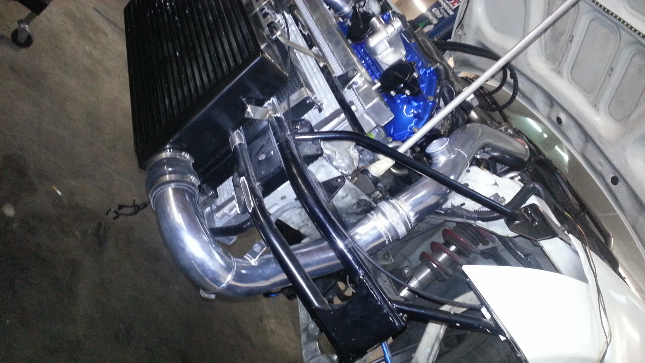

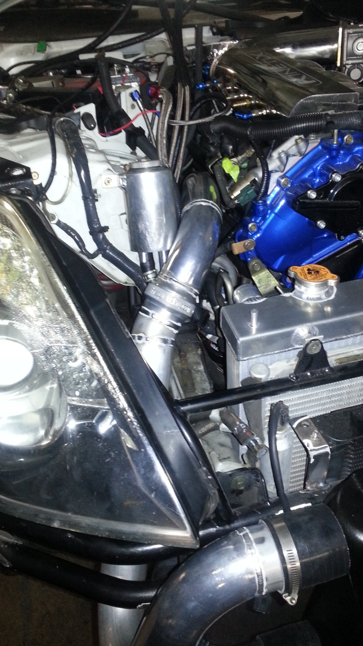

You could use something like Tim at SFR uses....they are expensive but won't blow off. Maybe use these on the joints that are not easy to get to in case one blows while you're driving. The easy ones you could fix on the roadside.
