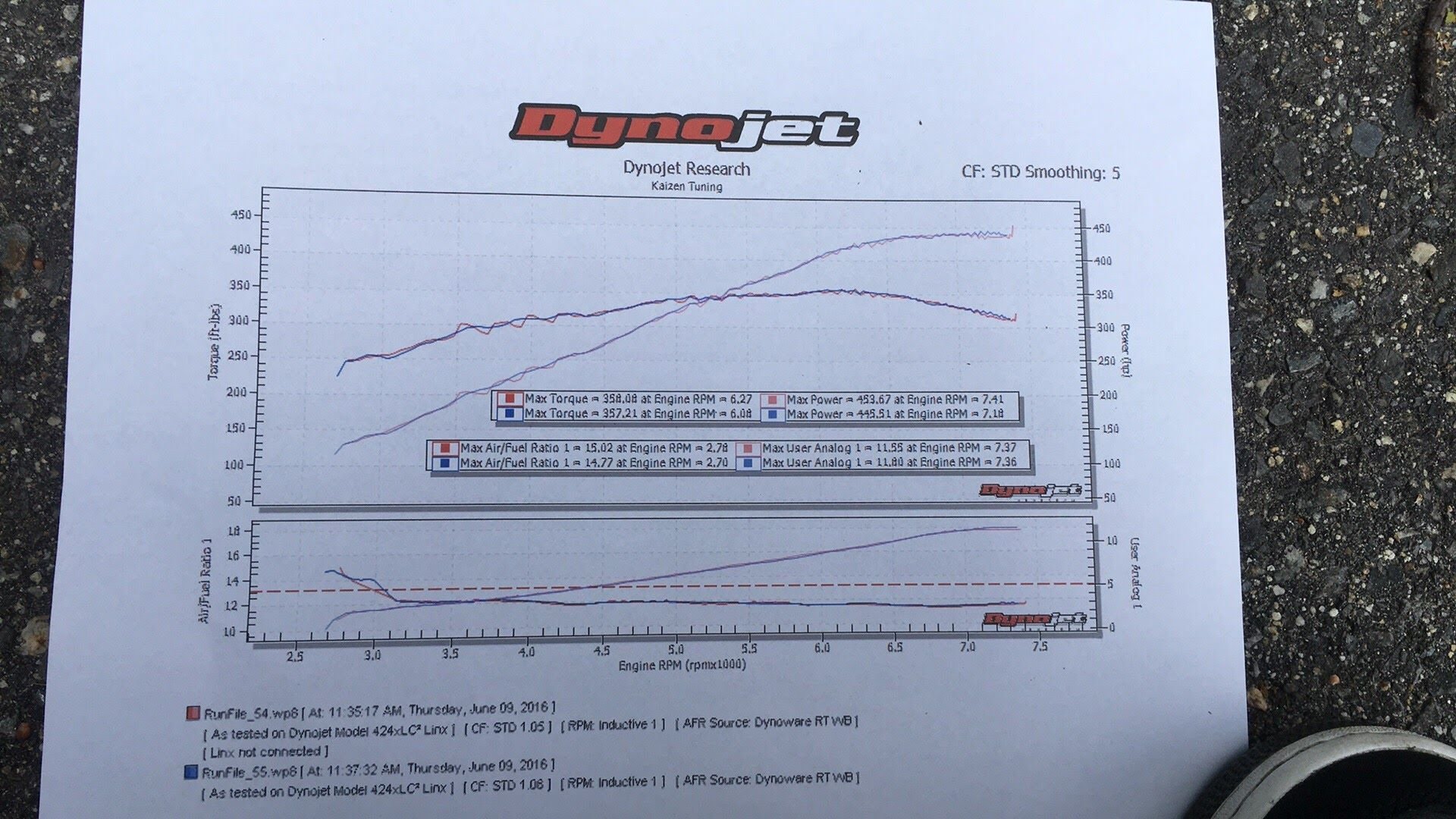

Logiqal 453/358 (93oct, 12psi, stock block)

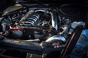

Tuned last friday. 503whp, 422tq. Stock block with 105k miles
First Vortech v7 JT-trim mounted to a VQ motor

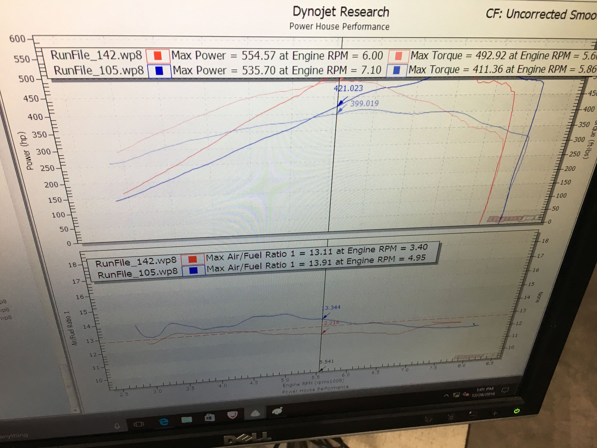

554/492 with my old Si blower on 17psi
more info/pics of this JT Blower? And what psi?

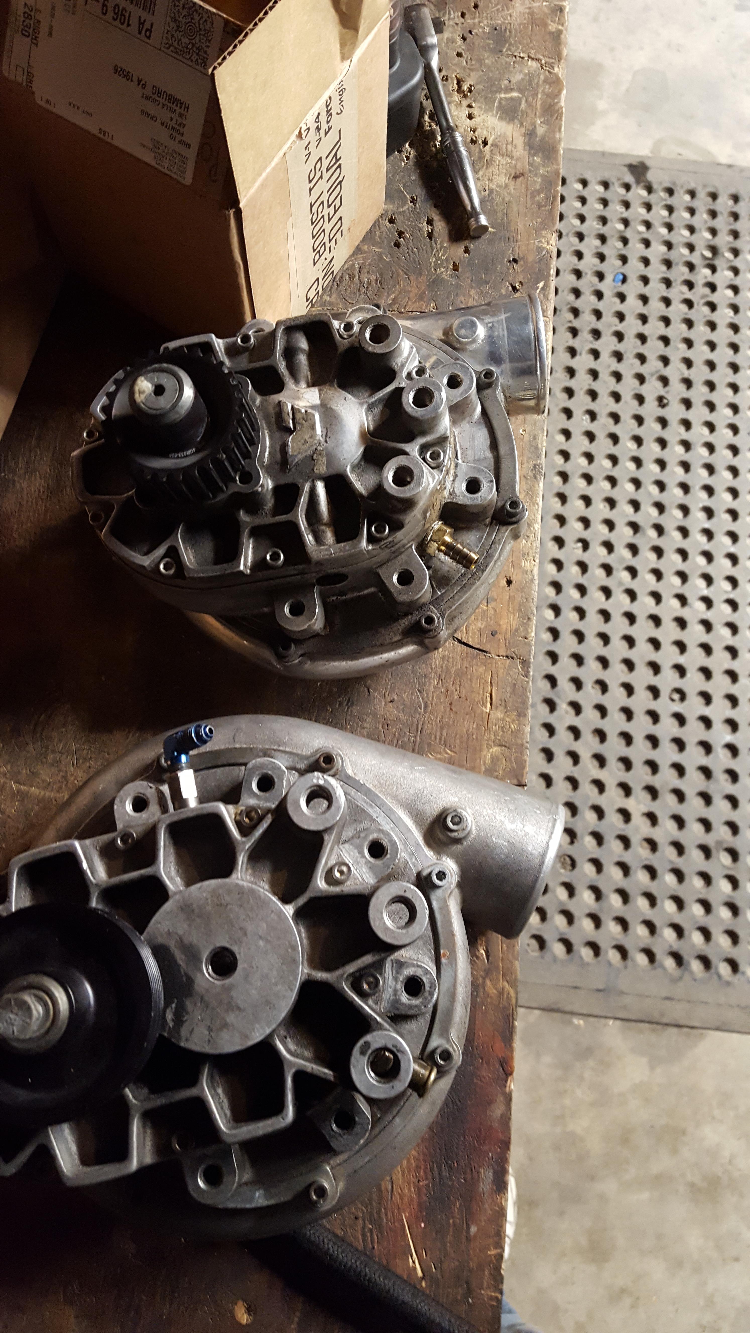

Ill dump a bunch of pics here. As far as the specs I'm running, I have a stock crank pulley, 2.87 drive pulley, with the 34/28 cog setup. Hits 14psi, makes 503hp, 422tq.
The blower was designed for a 4.6L mustang, but it is CCW so it works for our cars. The one I bought was actually off of a 2011-2014 5.0L mustang. Its basically a hair under the YSI trim as far as performance is concerned. The only modification I had to make was cut 3 extra brackets off the back of the supercharger in order to make it fit the VQ bracket, and I had to switch the ports that the oil feed and drain were in so they faced the right direction.
How I received it. And the smaller blower here is a V2-SC trim

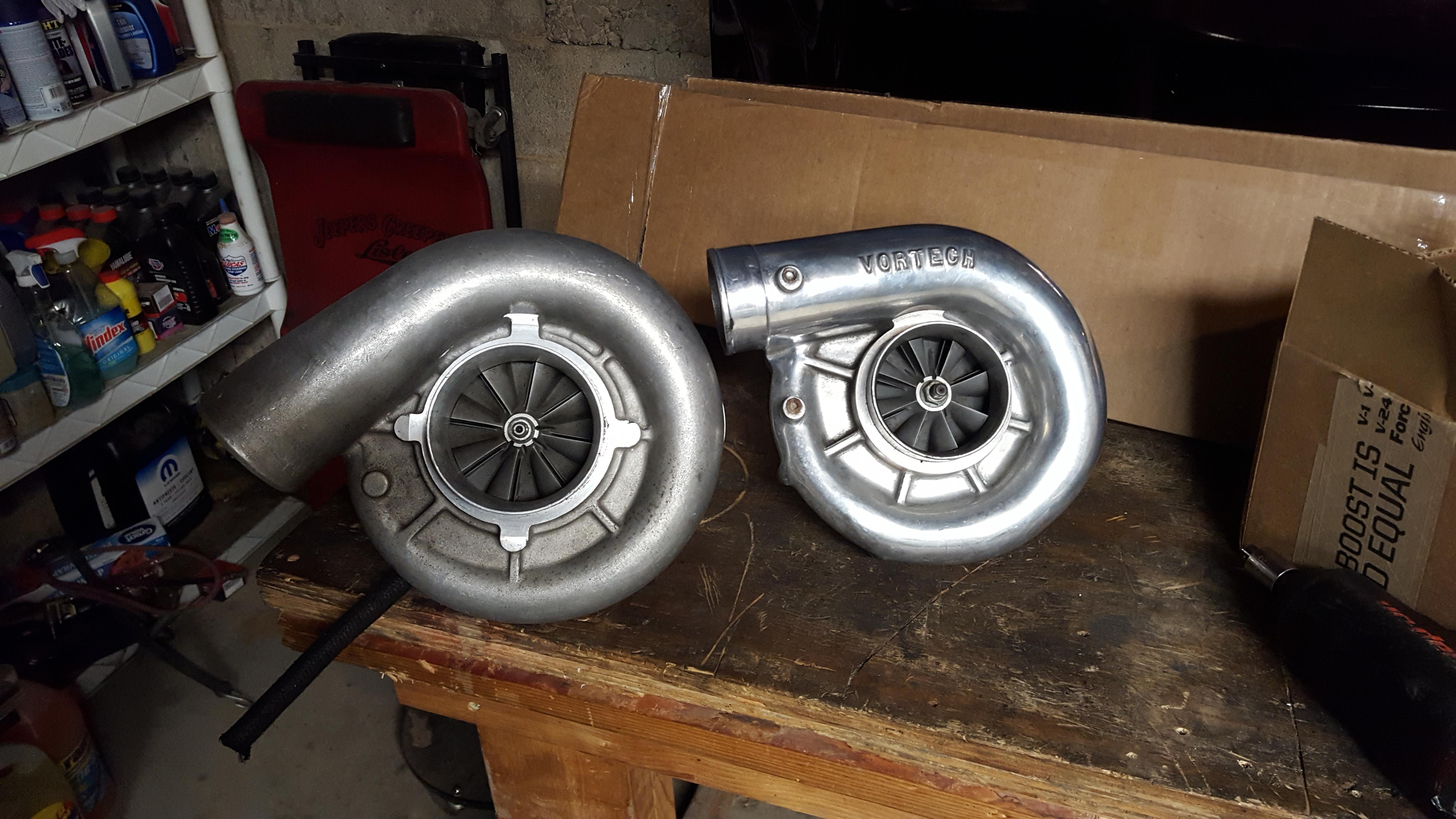

Here you can see that the JT has 3 lobes that stick out further than the V2

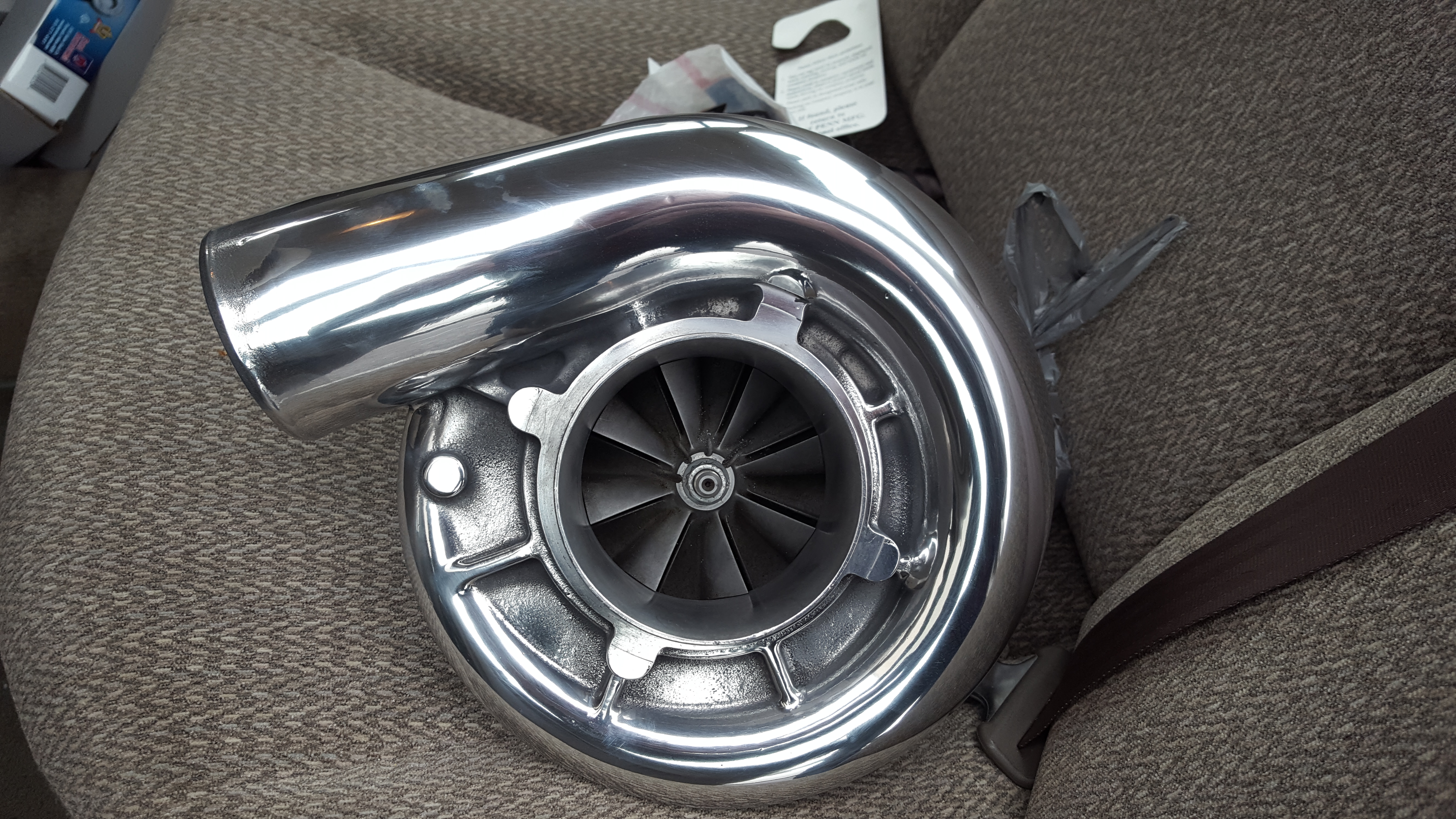

Paid $100 to have those brackets trimmed and a little polish work

And of course with the TimRod bracket mounted
