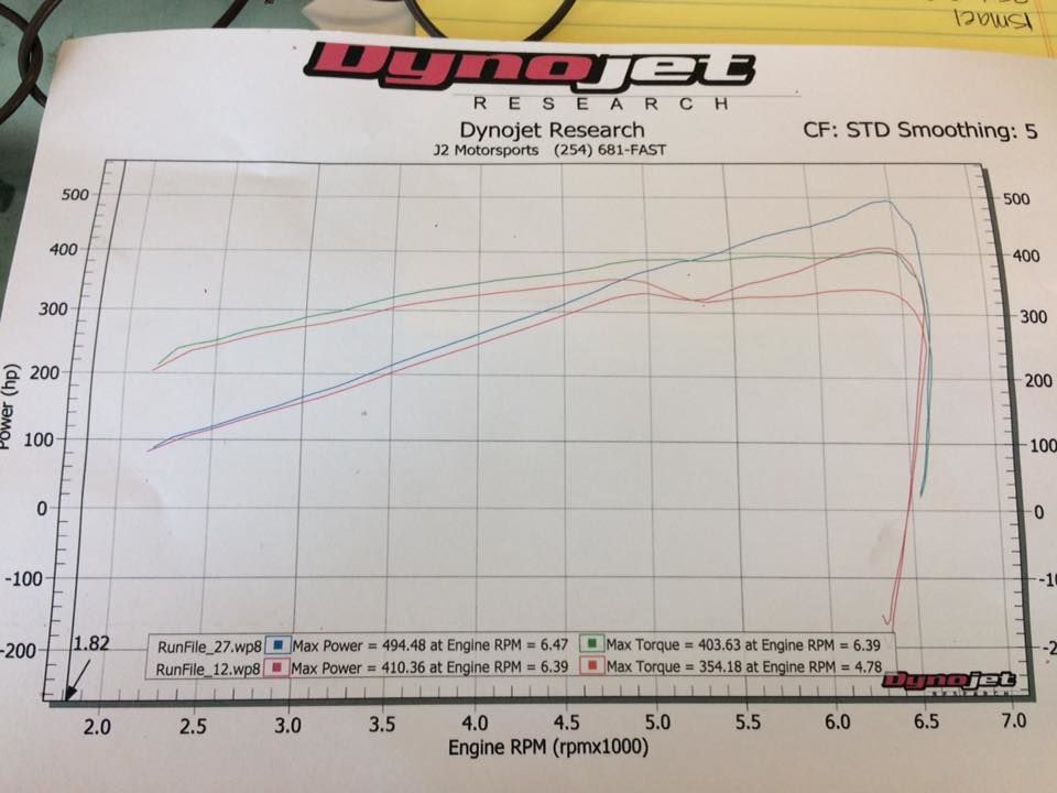

I'm running the 2.87/Fluidampr/34/28 as well. I have stock heads and headers. but I'm choking at 10psi.
494whp/403ftlb 11:1 comp on E85 @ 10psi.

I don't understand how you are stuck at 10psi. Thats crazy low. I have the 2.87, 34/28, stock crank pulley and I hit 14psi.
Something is really holding your car back

You are NOT Choking at 10psi, something else is going on.
Also, no way you're making 500whp with only 10psi
Post your Boost Log.
What are the Detail of your Build?

But, their is something else going on, causing your Power to fall off so early.
You do not seam to have any belt slip in your dyno.
