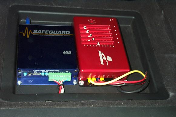

Where do you have your J&S unit mounted? Do you have any pictures?
