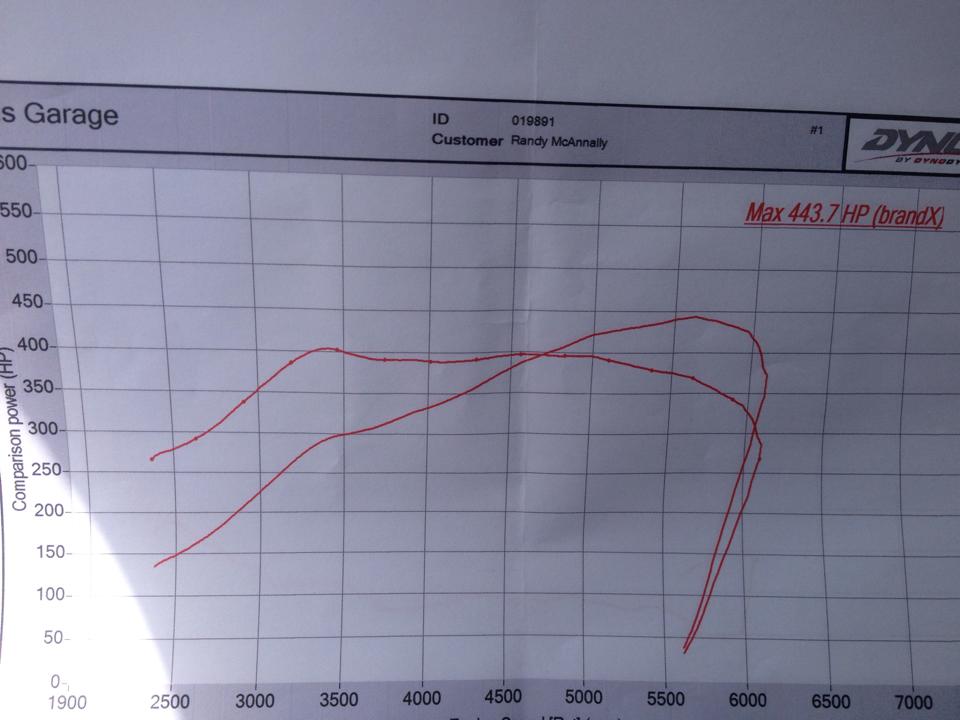

Thought I'd share....132k miles on the OEM block, boosted 6 years and 70k on a used greddy kit. Finally threw it on a dyno after a rough street retune on the old UTEC. Still laying it down after all these years - net 443whp at 8.5psi on a DD set to comparison mode (dynojet numbers FWIW).
RPM scale is a little off since we had no RPM pickup and converted from roller speed, not sure if or how much it affected the final numbers but it feels about right -- it walks all over my 420whp G35.

Very impressive with the numbers and how long it has lasted!

Aweswome power at 8.5 psi. I'm so jealous, I wish I had that power !! I need to build my spare block !!
