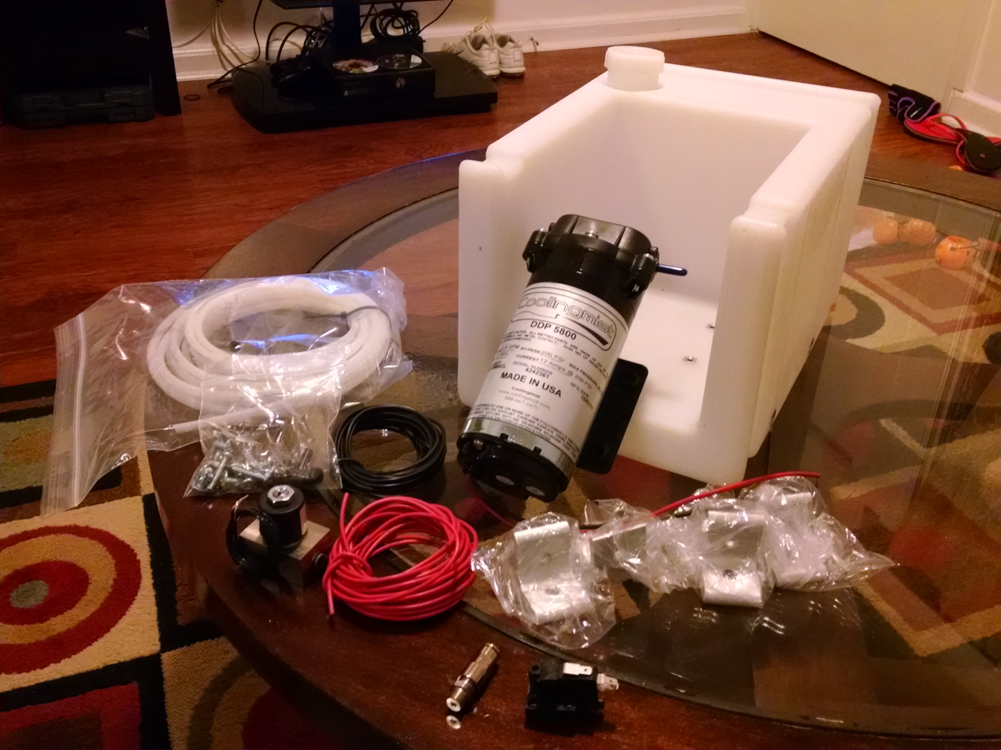

My Coolingmist Kit came in today. Won't be I installing till mid next month. Till then, Reading and doing research on which mixture I will be doing.

Old Oct 30, 2014 | 12:20 PM
  #45
str8dum1's Avatar
str8dum1
Joined: Oct 2007
Posts: 8,807
From: raleigh-wood NC
50/50 mixture
make sure you have enough jets to drop your AFR by 1 point.
dont see a progressive controller or safety flow meter though.
spend more time saving money for those instead of worrying about mixture ratio

Originally Posted by str8dum1
50/50 mixture
Will do. I think that would be a smarter move. Haste makes waste, HP bug keeps on biting me and causing me to chase moar power (Reliably mind you) lol I was leaning towards the denatured alcohol and distilled water mix but I'll go with 50/50 water and meth since its proven many times to work reliably. Thanks for the advice.

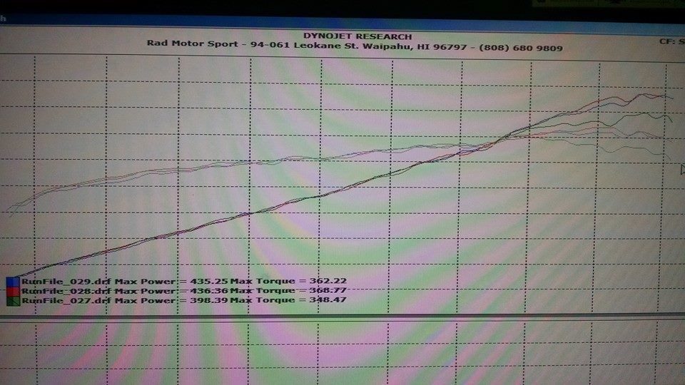

---UPDATES---
Retuned last night with my cooling mist water methanol injection system and intercooler upgrade. I used 100% methanol as my mixture of choice, and by doing that I yielded results I still could not believe on a 3.12 pulley. I am still in shock on how much I made, and still using stock headers.
436 whp / 368 tq with my Meth map, 417 whp / 351 tq w/o meth. The Meth injection map had a little rough topend, im assuming the stock maf is to blame for the small dives in the powerband near redline but all and all from my 396whp/329tq baseline soo many gains were made across the powerband. Id like to thank Seth at Rad Motorsports here in Hawaii for spending more time on this tune.
https://my350z.com/g/picture/2722784
The car feels amazing and scares me all over again, gonna be buying a new Uprev maf next year and retuning afterwards to hopfully help smooth out the topend.
https://my350z.com/g/picture/2722781

Originally Posted by 2bad240
Nice numbers I need to upgrade Ic also my iat gets over 130 aswell, that's gonna be one of my next mods along with 1 piece intake pipe. Then il install my pmaf and go to high boost
Yea, that's a good move. On my racetune, gains up to 20+ whp and tq alone with the intercooler upgrade were seen on the entire powerband. Just goes to show how much the stock intercooler was hurting performance.
