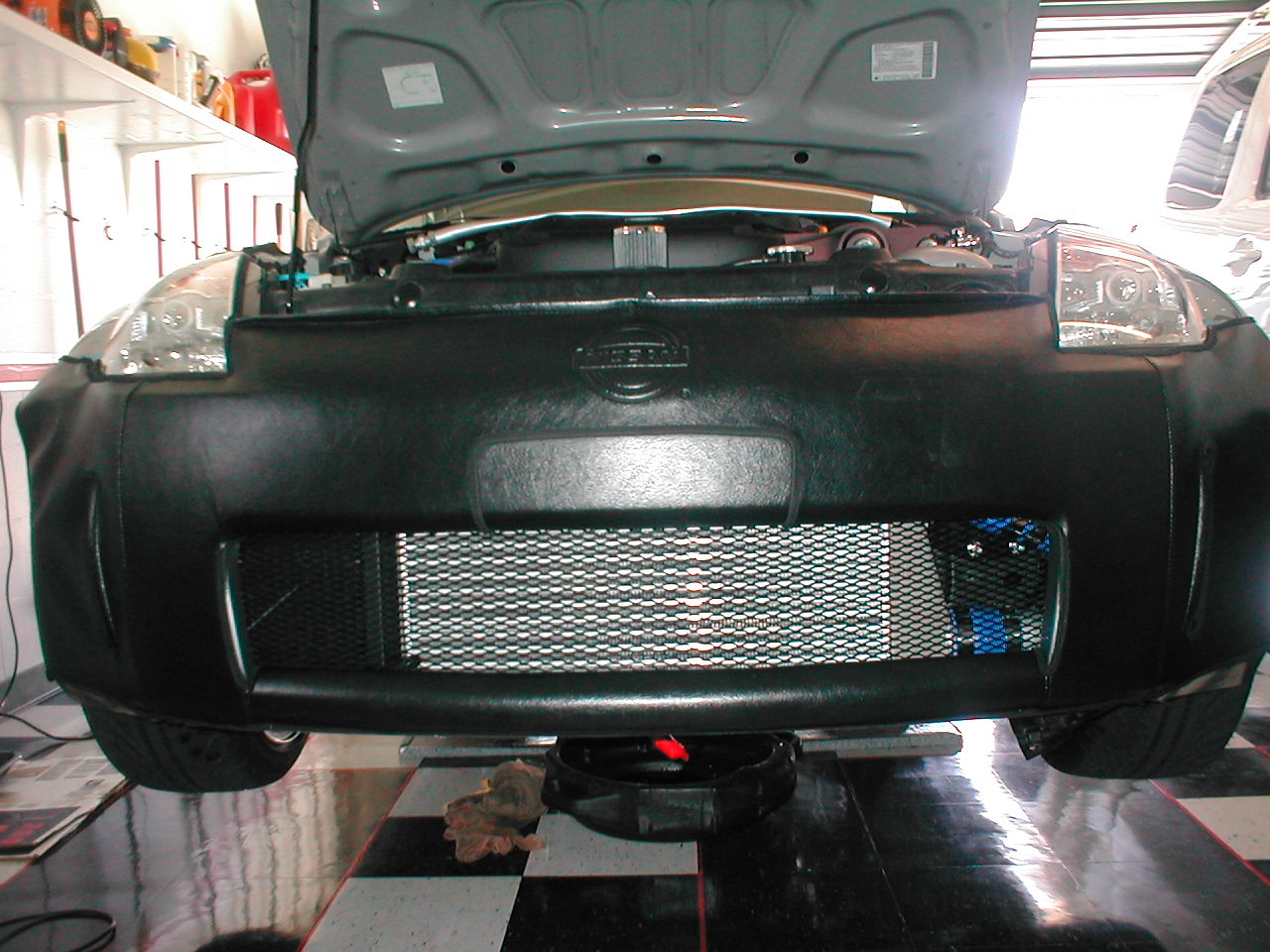

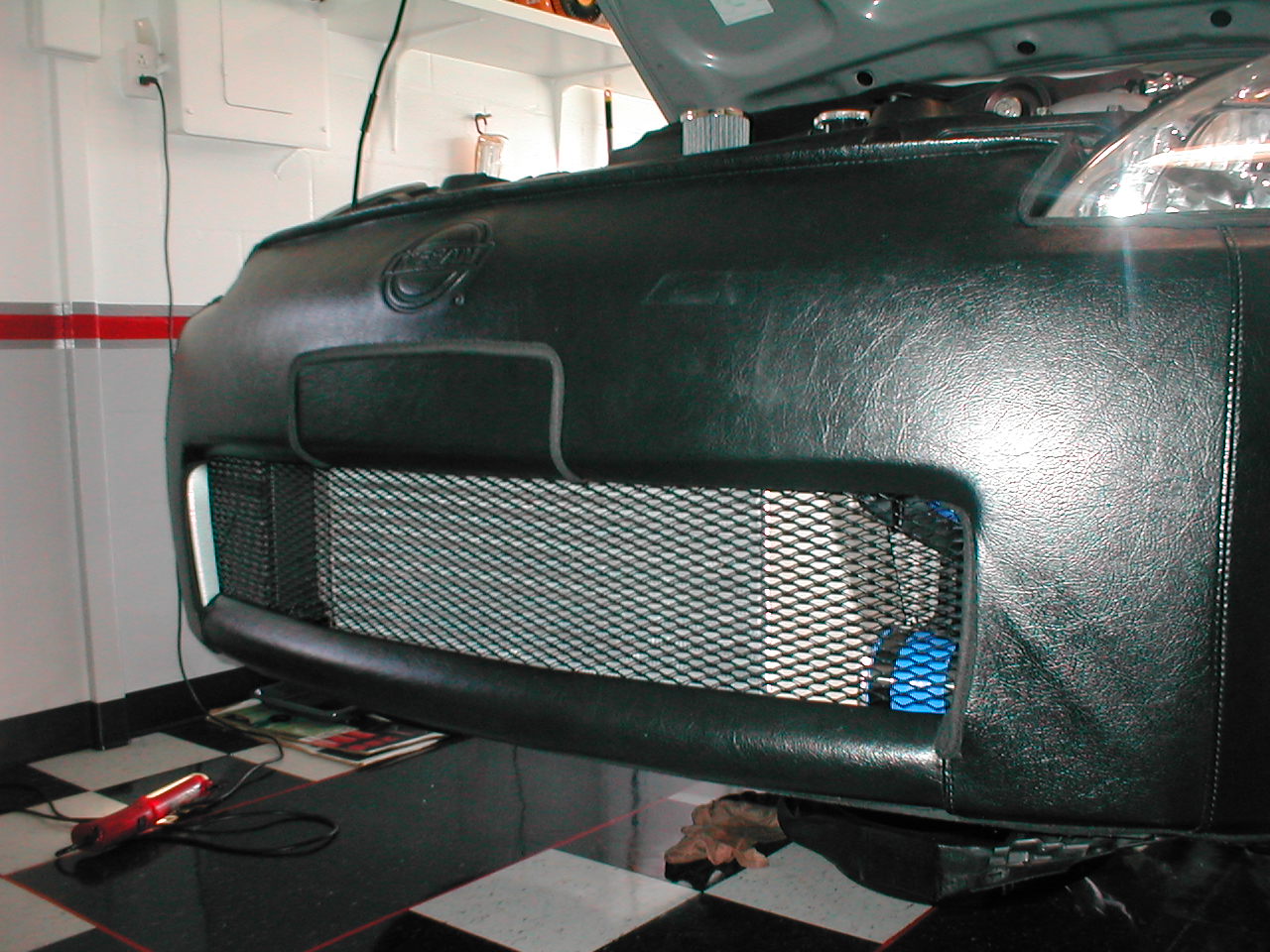

This is the Tr-1245 Installed.....
Not sitting below the bumper cover.

Oldman, I understand. I need to either get rid of the front crash bar entirely or get the intercooler rewelded to it and make it sit higher. This is just how it will look for now till its adressed.

Nice garage oldmanz350. You got some space age technology going on in there or what? The z looks like it's hovering. Ha!
The more surface area that's exposed, the better the i.c. will perform. That's why I wrote what I did above. It looks like you did a really good job getting it to fit.
Rather than an aluminum brace stretching from one side to the other, it could bolt to brackets welded on the i.c., one on each side at the very bottom and then attach to something fixed to or behind the bumper. Then do a mesh like oldman's or even go a little tighter to see less of what's behind it and then paint the mess blue. Just a thought.

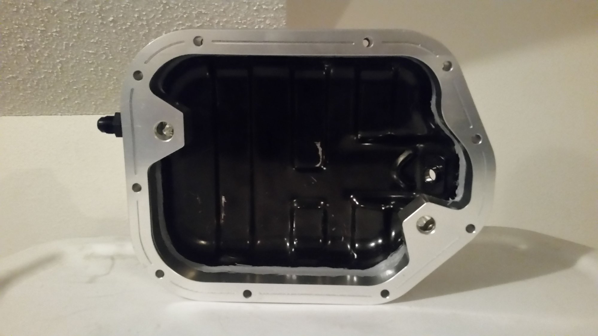

After much reading, I've decided not to tap my oil pan for my oil return for the V7. Not really comfortable doing it as it can Crack the upper pan if I'm not careful with the AN fitting after drilling. The metal is very soft so I don't want to screw it up.
Going with the Z1 oil pan spacer, and I ordered brand new Vortech return and feed lines to replace the used ones that came with the kit.
Down the road if tapping the upper oil pan is necessary, I will tee off the line already going to the spacer in the middle and run another line to the upper oil pan, using two paths for the oil to take.

Not much to update with. Prepared my Z1 oilpan spacer and spare oil pan with my AN fitting for the oil return with a generous amount of Gray RTV so it should not leak.
