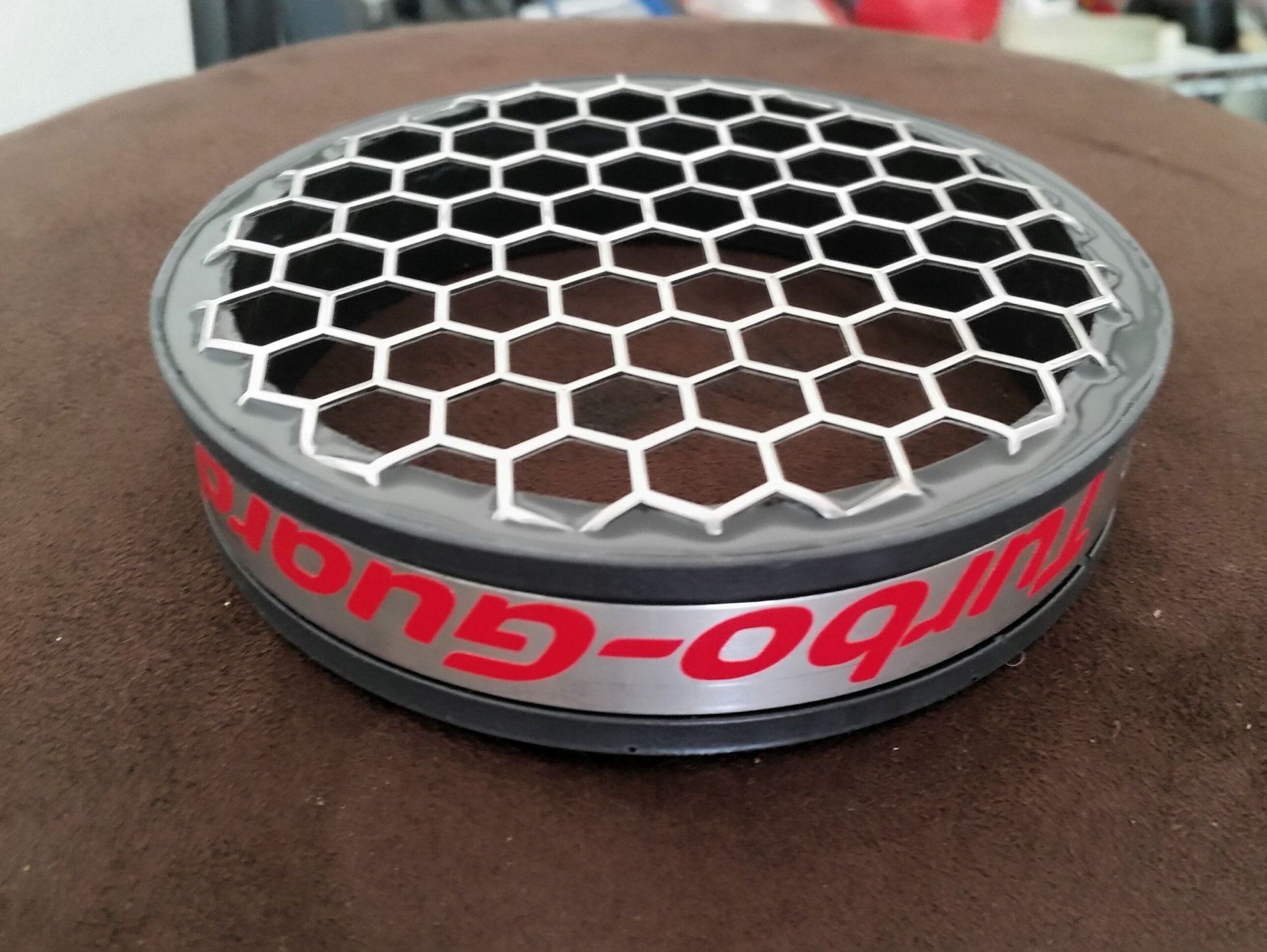

Not much to update, car has been doing great after the rear diff+Urethane bushing install. Next on the list is the CJM Twin Pump on my list to get. I've street tuned the car only in light and partial loads, but not WOT because of the need for more reliable/available fuel delivery.
EDIT: Forgot to add that CJ motorsports is revising the design of their twin pump. Expect them to start pushing them out in July sometime...
https://cj-motorsports.com/products/...n-pump-350zg35
On a side note, picked up a new Turbo_Guard Maxx for the YSi.
