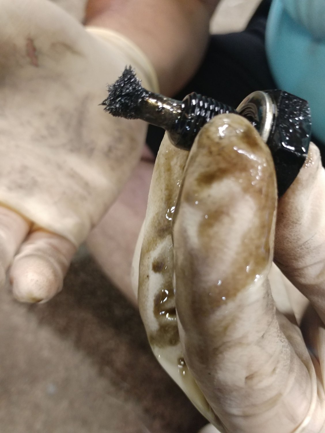

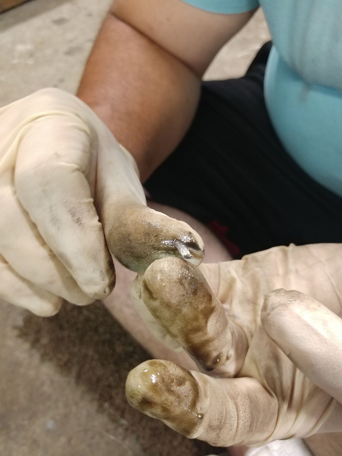

So the track didnt happen friday.....its been a very sad depressing weekend
Friday after work i did a test pull in third in an effort to see if the clutch was good and make sure logs were good before attempting to go to the track again and i ended up getting 2 codes on
Po011
Po021
went to look at the logs and realized my haltech wideband had **** the bed (third 02 ive killed already)
Went back to the garage and put another wideband in
The codes cleared themselves and about an hour later i went out and did a 2nd gear to third gear with no issues until ..... After the pull as i drove on the highway I started hearing a loud knocking noise but thought it was from a pos van that had driven by me but then my friend who was in the car could hear it as i drove further down the road. It wasnt consistent it was on and off. I immediately exited the highway and shut the car off and rolled to the side of the road.
I left my car there and went to go pick up my trailor as i didnt want to cause any more damage by driving the car. I trailored my car back to the garage. When i had the car running i put my hand on the timing cover and could feel the timing chain slapping inside. So i thought thats what the noise had to be
Saturday morning i got to the garage and i wanted to make sure the car built oil pressure so i cranked it till i saw the gauge go up ..it went to 60psi and then i started it .... No noise ....so then i had high hopes that the motor was fine and all i would have to do is put in new timing chain kit ......
I proceded to drain the oil .... and well all hopes and dreams were lost
I first pulled the drain plug and my heart sank .....found a nice chunk of either rod bearings or main bearings then pulled the oil pan off and it was filled with flakes of bearings
...... So this motor is toast and i dont know the cause, who knows what the air to fuels were like when the wideband was dead .... Maybe it went to lean? Maybe oil starvation ? Maybe when it went lean at the track last week something happened ?...no idea ...
either way the motor had to come out so there was no point to waste time so thats how i spent my weekend ....already pulled it back out and its ready to be taken back to dynosty to assess the damage and get it fixed . i've sent the logs both from the track last week and the pulls friday to Hal for him to look over to see what might of happened
Its really heartbreaking and a shame to have to pull this thing apart 😞
