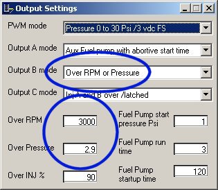

Yeah, here's a screen shot of what we're talking about:

There's not necessarily agreement about when the auxiliary pump should come on... But basically it is needed at the point at which boost begins to kick in (i.e. above 2500-3000 rpms or so).

the output setting needs to be set at "Over rpm AND Pressure" not "Over rpm OR Pressure"...........then it will only come on when boosting.............and not at 1,000 rpm...... ................mine is set to Over rpm AND Pressure and the rpm is set to 1,000 and pressure is at 1 psi................

mine is set to 500 rpm and over 1 psi from Vortech..........I just checked............500rpm or 1,000 rpm would not make any difference as long as the feild is set to "Over rpm AND pressure"
