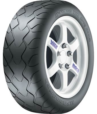

fluidz's Avatar
fluidz
Posts: 794
From: Vortechville,CA
BFG's for me.
Attached Thumbnails who is running drag radials ?-gforce_drag_radial_large.jpg
