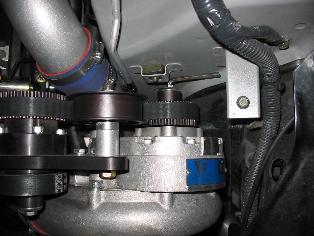

So about a month ago I sent my blower back for repair because the pulley fell off the blower unit. While I was looking in my engine bay today, I noticed that the bolt that holds the cog pulley to the jackshaft was missing too..!!! WTF! I'm gonna have to call vortech on monday.
Another thing, when vortech returned the blower to me, they replaced it with the wrong pulley. The pulley has the same amount of teeth, but it is a little longer, so my tensioner pulley does not reach out all the way to hold the smaller belt on. I hope I don't have to send my whole unit back to them so they can fix their stupid mistake.

this is the "repaired" pulley vortech sent me.
take a look at Tigs pulley compared to mine.
Notice anything different? They installed the damn pulley backwards!!!!
Notice how they replaced the "allen head" bolt with a real "hex" bolt. That bolt also rubs against that little bracket thingy on the chassis when I WOT it. I

Hard to believe they did that .. REPAIR pulley....geeeeze....washers.....thats not good for buisness

Yes, I talked to Mike. He's sending me a new key, bolt and washer. I'm just going to flip the pulley myself, no need to send it back to do such a simple job.

Just to be safe , it's often a good idea to put a little Loctite "blue" on the pulley bolts. I've even had OEMm alternator nuts back off , a few months after a blower install. Most head units create some form of addtional vibration, which can loosen bolts over time.
