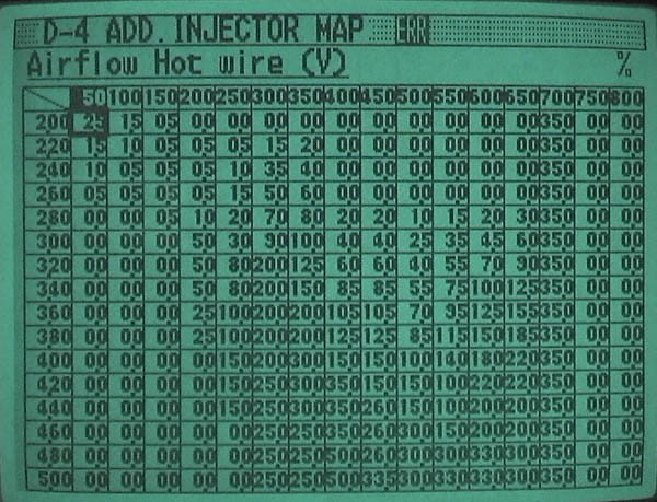

#3) does anyone have the e-manage factory settings, so i can initialize, put in the factory settings and then tune from there???

1) Injector scaling in the parameters screen. Make it scale from 280-440
2) Add injector Map--input stock values...I dont have them handy...PM ETX or do a search....he posted them 6 months ago

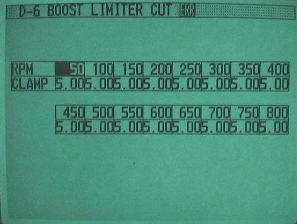

3) Boost cut limiter: This is your voltage clamp, and it should be set to 5.0 across the board. THis way, your ECU will never see more than 5.0Volts of airflow.

Here is the link from ETX...but look like the pictures to the fuel tables are down. PM him.
https://my350z.com/forum/showthread....ghlight=Greddy

i think i found the maps...called d-4 add injector map???... i found it at
https://my350z.com/forum/attachment....&postid=793648
https://my350z.com/forum/attachment....&postid=793650
Can you guys confirm that this is correct??
THANKS!!!!!

That looks just like what I sent you

thanks for emailing it... the maps i found on this website were the same...thank you very much though for the help

edit: Here are the maps again.
