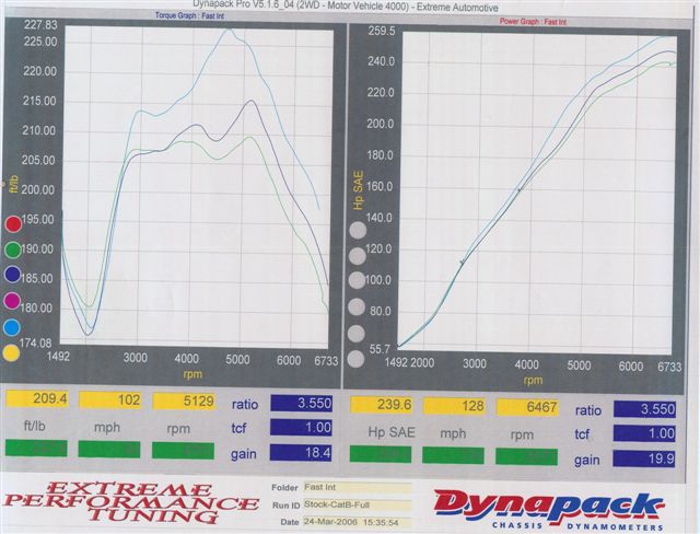

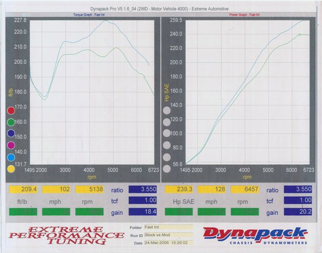

OK - let me make sure we're all on the same page here and make sure again that we have no misconceptions or mis-information - that is the most important thing - We've been completely straight up and honest - and always will be.
1 - We have many dynos of the car, that will be posted over the next few days, from the dyno day - yes it was all done in one day - the car was never removed from the rack or the dyno.
The dynos are of the car with the stock system after ecu reset with stock exhaust, with resonated test pipes and stock catback, with catback and stock cats and with the entire system, as well as a dyno sheet with all of the dyno runs together showing the full comparison.
2 - the posted dyno sheet on the thread from today is the system as described below:
Stock exhaust after ecu reset vs. Fast Intentions complete exhaust system (includes resonated test pipes (with 8" perforated core resonators) and catback exhaust (perforated x-pipe to dual custom designed Sebring manufactured mufflers to dual resonated Sebring tips)
All pipe, including resonated test pipes, is done in 2 1/2" mandrel bent pipe. This is done in house on their own mandrel bending machine.
The catback on the dyno pulled ~11RWHP and the test pipes pulled about ~9RWHP - giving the ~20RWHP gains you see on the dyno - on the BONE STOCK 350Z test car.

Ok he clarified the 20 HP gain. I thought that dyno was just the catback exhaust. The 20 HP gain includes removing the stock cat with resonated test pipes which makes more sense. The catback alone according to him put 11 HP on the dyno which is more believable but a little high. I would still like to see independent dyno's just on the catback alone.

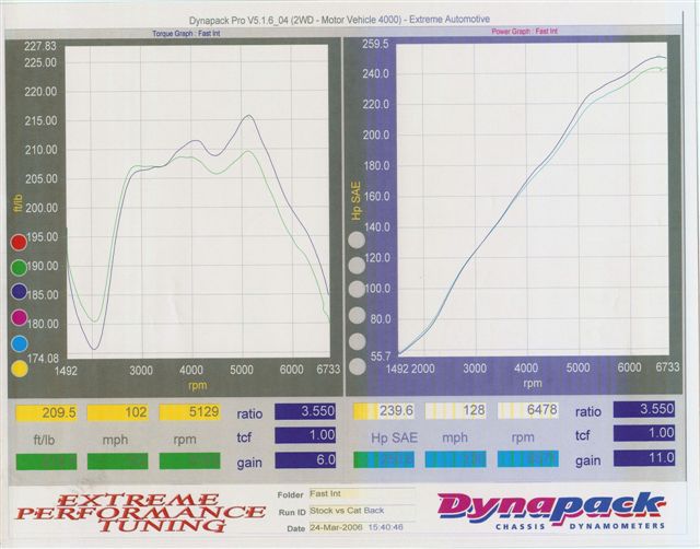

Default Additional dyno's...as promised.....
Here ya go....
First dyno is the stock car vs. the catback.
Second dyno shows stock car vs. catback vs. catback and resonated testpipes.
Rick
