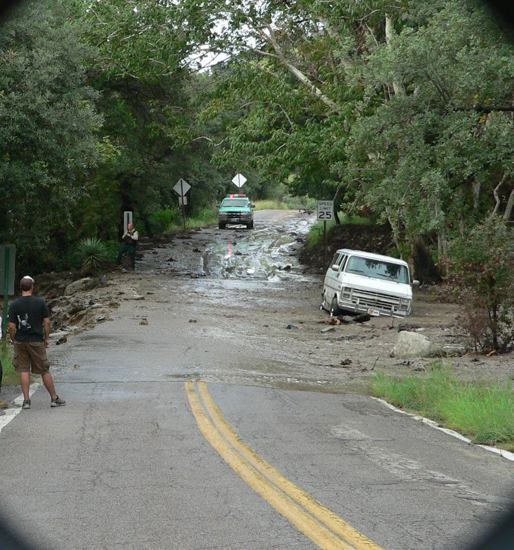

Have you ever seen it rain in places like Phoenix or even SoCal? I've lived in Seattle and Phoenix, and if you're out and t-storms come through, you can have 6 inches of water standing on the road in no time. Bypass valve...
