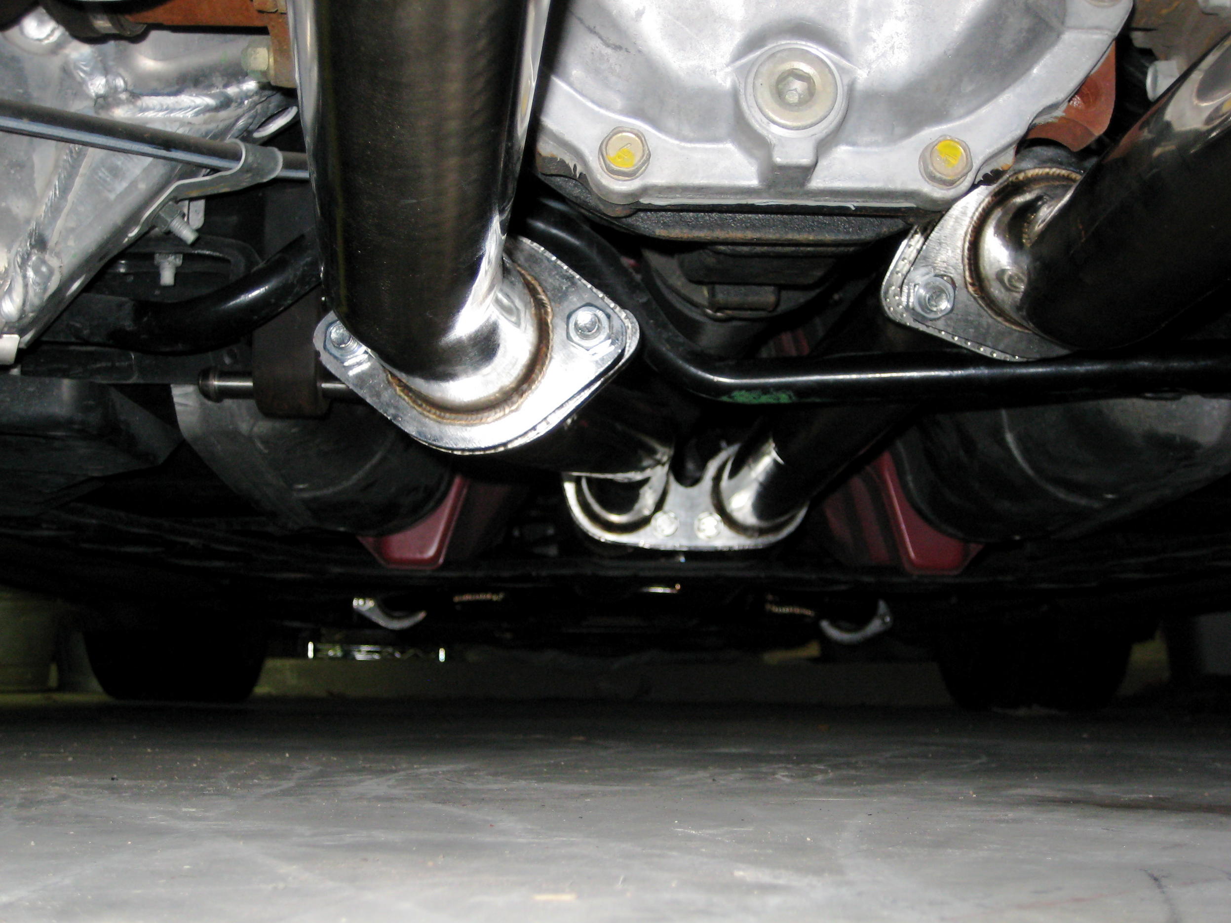

Originally Posted by red_magic2000
Same goes for me, just purchased the CX Lighting on ebay last night also. I'm planning on getting the whole thing Jet Hot Coated in Gloss Black. So I won't worry bout the rust..Still thinking about it though. Anyone with any opinions on how the exhaust would look in black on a Carbon Silver Z?
It'd look pretty cool IMO...at least while new...not sure how it'd hold up to rock chips, getting dragged....and the other crap that exhaust gets put through
here's a cpl shots of mine...going to see how my point-n-shoot takes videos...not certain on sound quality of the camera.
Attached Thumbnails Replica HKS Exhausts Ebay/Godspeed-img_0531.jpg   Replica HKS Exhausts Ebay/Godspeed-img_0534.jpg

Originally Posted by WTX350Z
Get it installed? come on man, I did the entire swap including getting it on jack stands in 1.5hrs....and that included removing the pass rear section to adjust the hangers a little.
DIY, DIY, DIY......you'll love yourself when your done.
Man, I'm tellin' ya, I really would, but I don't have access to the tools and added help; however, the main reason I can't do this is because I don't have a garage or any place to set up since I live in a townhouse. I know it isn't that difficult... but I have to park in a freakin' parking lot. Thankfully, I frequently visit a local privately owned garage and they don't charge much for operations like these.
Question: Is it conventional to lay out the exhaust and adjust the hangers to ensure the pipes sit even before it is even installed?
no worries. I've gotta give ya hell though!
on the installation. I loosely attached all bolts, then tried to twist/turn pipes to get the alignment of everything a bit better....although this was futile IMO.
the hangers themselves aren't "adjustable". and the piping is only moderately adjustable....minimal is most likely a more accurate description.
Interesting. So did your pipes end up being level on each side? If not, what else did you to do level them out?
And by "adjustable" do you mean that it isn't possible to bend them?
I dont' have access to a piping bender....but yeah if you have a mandrel bender, then it has just become adjustable. I was referring to the fact that since the pipes are all connected via flanges, there isn't any room for adjustment really...where as a slip fit exhaust has lots of adjustment potential w/o resorting to bending the pipes.
I bent the hangers on the pass side to get them closer....they aren't perfect still. but I'm going to have the tubing bent on that same side so it won't touch the rear diff....after the autox runs today its rattling against that a bit.
Here in a bit I'm going to measure the h pipe section to see if I can fit a magnaflow dual in/out muffler in that section as a replacement. If so, I'll be doing that next week. the ringing/whistle sound I get @ 3700 and above is ridiculous. If I can't fit it there, I'll look into a few other options. but this ringing sound must go away. I'm going to look inside the piping to see if my "knockoff" has the same shotty craftsmanship as the genuine HKS that gothchick has....if so that H pipe is def. going the the trash.

Well good news is the quality control on the knock off exhaust is better than that displayed by Gothchick's "HKS". My H pipe is perfect from the inside, both sides. no protrusion.
however, this still leaves my question unanswered....I disassembled the exhaust and listened to it with each section disconnected....after the midsection (W/ H pipe) is installed, and no rear sections. there is a considerable rasp that appears around the same RPM as this ringing sound...attaching one rear section yields no changes...is it possible the other side is masking the issue? yes. but regardless. I believe it has to be a rasp which is being altered via the mufflers into what can best be described as a ringing sound....I've thought up a cpl ways to possibly aleviate this.
one is replace mid section resonators with the Magnaflow dual in/out muffler.
another is to move the existing mufflers back to the flange (eliminate a 7 inch piece of pipe between the res. and the flange....and put the magnaflow in the section infront of the existing resonators (replacing the H pipe in the process).
third option is to purchase 2 bullet mufflers and place them wherever they'lll fit. if they are 12 inches or less they will fit in the rear section jsut before the mufflers, or in the rear mid section.

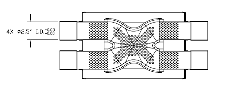

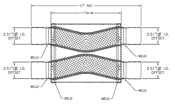

For anyone curious, here's schematics from Magnaflow of the 14379 and 14386 mufflers respectively....
Based on this. I guess to replace the H pipe, It'd be necessary to use the 14386...since I'm unsure if the 14379 would allow for pressure equalization, etc...which sucks, b/c it will require I remove the front 2 resonators (1 per bank) to use the longer muffler.
Attached Thumbnails Replica HKS Exhausts Ebay/Godspeed-14379.gif   Replica HKS Exhausts Ebay/Godspeed-14386.gif

So, let me get this straight, these little pipes that go in the center of the exhaust are for the G35 only? Is that right?
