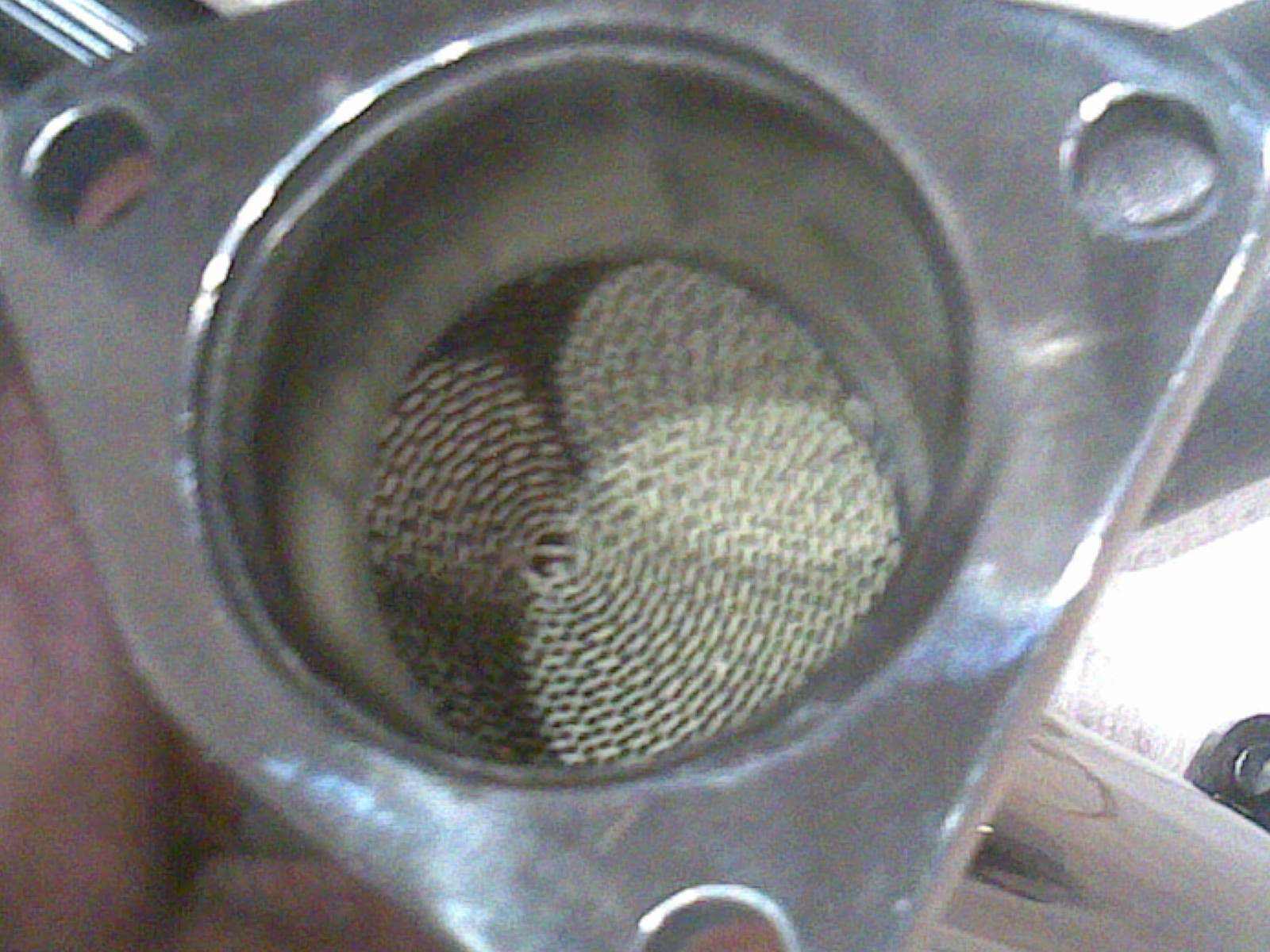

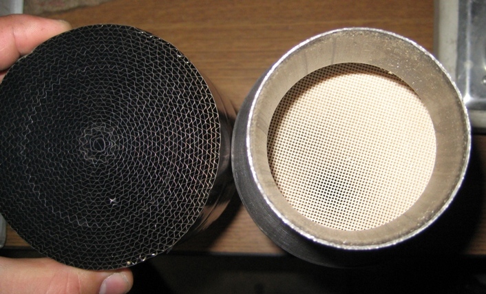

but i have to make sure of one thing :
is this the metallic HFC ?? its white from the insaid !!!!
as you see in Berk Technology site they show both kinds (i think the black one is the metallic)
what tool do i need to install (HFC,exhaut and spacer)-metallic-vs-ceramic.jpg
or they are showing a used one ??
Attachment 189468
That picture shows the metallic cat.
The metallic is the stainless steel metal foil used as the substrate and support.
The white stuff on the foil is the actual catalyist material. Its a mixture of ceramic and nano size particles of platinum, palladium, rhodium and other precious metals.
You can't see the precious metal particles because they are so small but the white stuff is the ceramic portion of what cleans your exhaust gasses.
All that stuff starts out as a slurry that is sprayed onto the substrate, dried and fired in a kiln.
