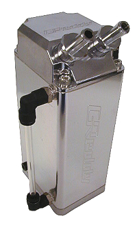

Greddy sells one. you can go to any greddy local dealers near you it looks like this. I saw it on intense motorsports site.

Default The catch can:
Replaces the small filter thats inline with the rubber hose (PVC hose).

brand really doesnt matter I have seen catch cans made of beer cans. All of the catch cans have the same design.

if you have the injen CAI you will need a 15mm catch can.

So is the can found here 15mm?
