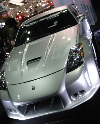

If I got the Veilside 3 hood is there anyway to take advantage of the "cleaner" air coming in the scoop?
Attached Thumbnails Intake Advantage With New Hood?-veilside-version-3-front.jpg

Since the scoop is way behind where the stock air intake opening is, you would have to make you own intake tubing and relocate the MAF, filter, etc.. It could be done but it is going to be rather expensive for all the more gain you might see out of it. Keyword here is might.

If the hood is functional, you would benefit from the hot engine heat being vented from your motor and cold air to help cool it.

I think you are already taking advantage of the scoop. The air coming in through the scoop will keep the engine bay cooler and therefore the intake pipe will not absorb as much heat. This will keep the air coming in through your intake from becoming warmed while in the pipe.

I read that the scoop is functional, but I don't know if that means all three scoops or only the center forward facing scoop. If they all were functional looks like a guy could use the driver's side scoop pretty easily. I am also concerned about rain water. How did they keep rain out of other scoops?

On my ls1 there was a plate in the "nostrils" that diverted the rain water down and out. I think that is for show mostly.

Is the hood CF and/or FG? If so, your engine may actually run a bit warmer even if the scoops are functional, especially in idle and slow speed cases. The plastic is a poor heat conductor relative to the stock aluminum hood.
